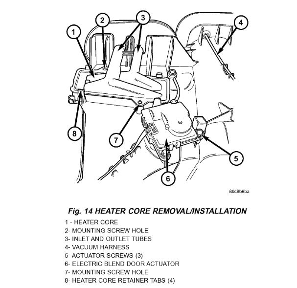

There is a blend door actuator that controls heat and cold commands from the control head. It is a very common failure for this issue.
Before assuming this, the AC system needs to be checked for proper pressure. You need a set of gauges to confirm. You can rent them at a parts store.
The tough part is that the dash has to be removed in order to access the blend door as it is located on top of the heater case.

Fig.14 Heater Core Removal/Installation
imageZoom/Print
3. Remove the screws that secure the blend door actuator to the top of the HVAC housing..
4. Remove the blend door actuator.

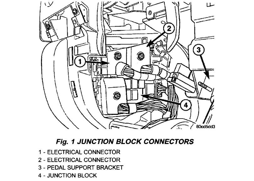

(10)Disconnect the green and light blue wire harness bulk connectors at the junction block.

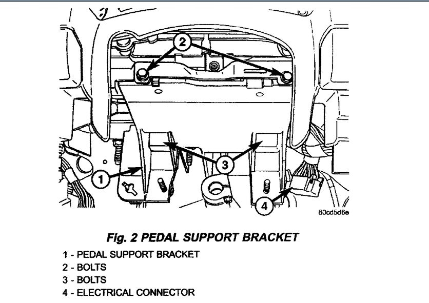

(11)Disconnect the electrical connector at the inner side of the pedal support bracket. (Fig. 2)
(12)Remove the two bolts at the front of the pedal support bracket. (fig. 2)
(13)Remove the two bolts from the bottom side of the pedal support bracket. (Fig. 2)

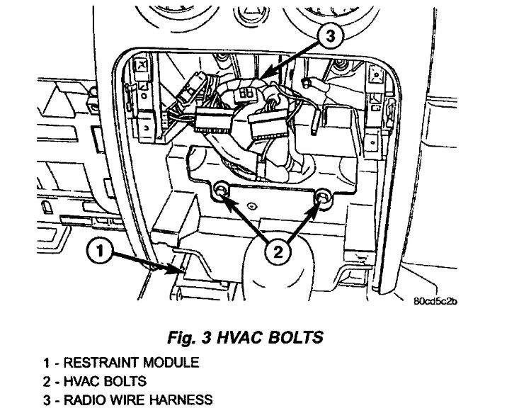

(17)Remove the two HVAC mounting bolts behind the center trim. (Fig. 3)

(19)Remove the HVAC mounting bolt above the glove box striker. (Fig. 4)

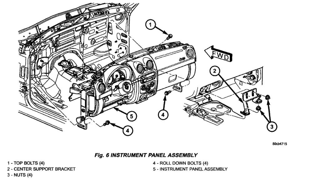

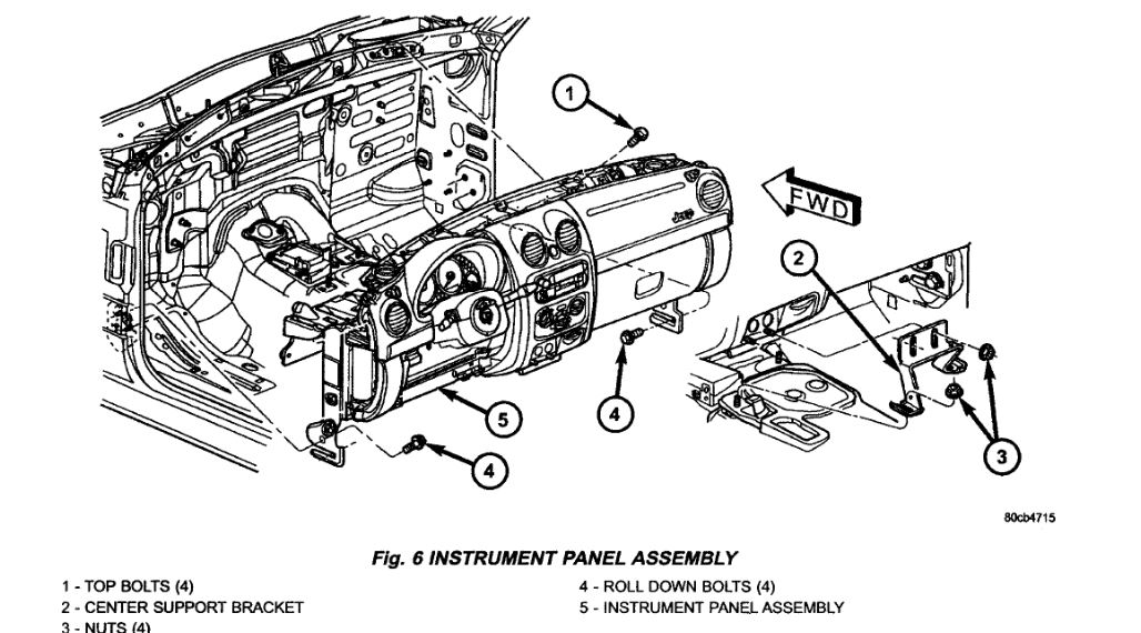

(26)Remove the four bolts at the top of the instrument panel connecting to the cowl front panel.
(27)Roll the instrument panel rearward and remove the wire harness from routing channel in the rear.
(28)Disconnect the push pin fastener and position aside the radio wire harness. Note the location of the harness for installation.
(29)Remove the instrument panel.
