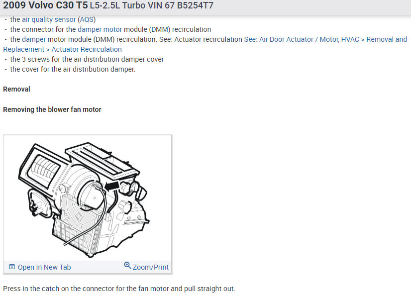

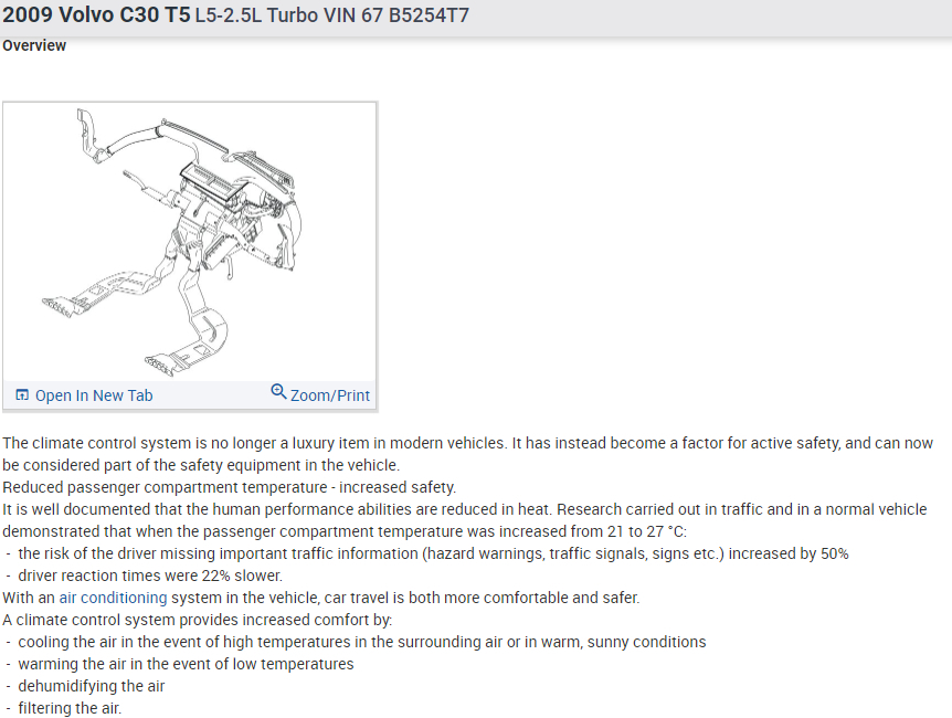

Air conditioner is not working perfectly. It blows cold air during summer. The cooling and air flow is not accurate and the car does not cooling down. It blows speed is too little like 25% of its original flow. Looking for suggestions. Thank you in advance.

So does the fan only blows at 25%? Are you able to adjust the speed of the blower fan? Or is it stuck in the low setting?
The A/C system might need to be recharged or there might be a clogged cabin air filter or a bad blower fan (or blower switch).

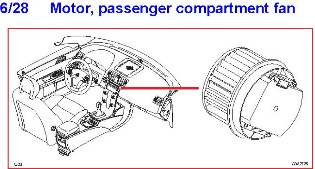

It blows too little at high speed. It is possible to regulate but does not make so much difference. At low speed it works like too little flow and at high speed it is increased but not as it should do. I am planning to recharge the A/C system.

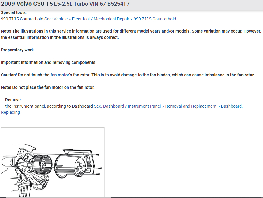

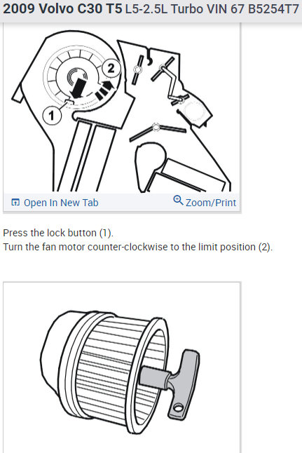

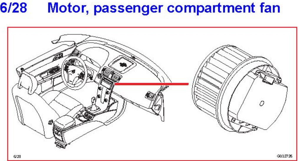

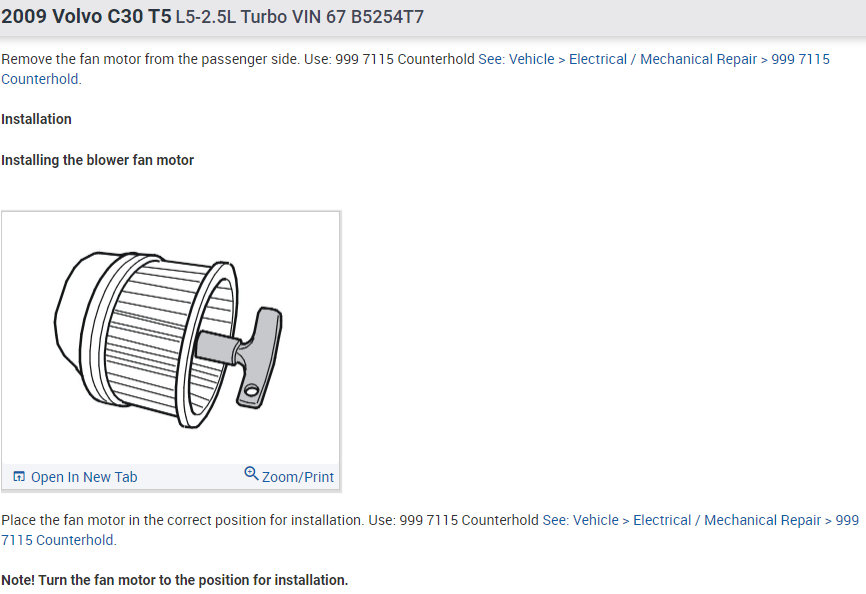

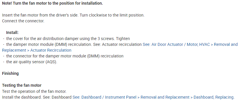

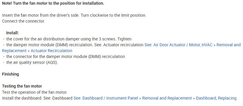

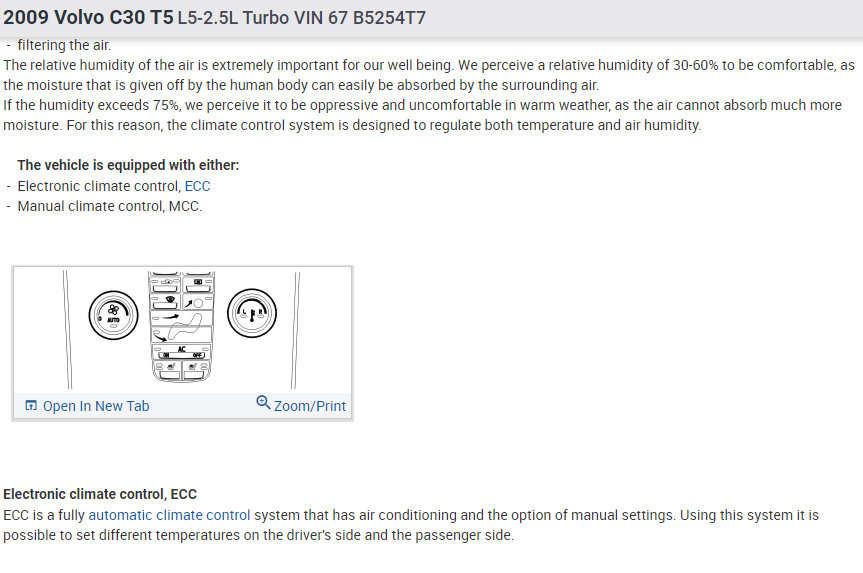

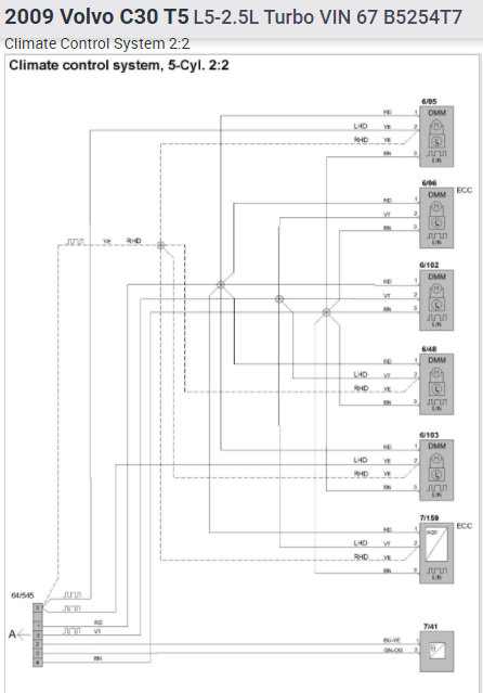

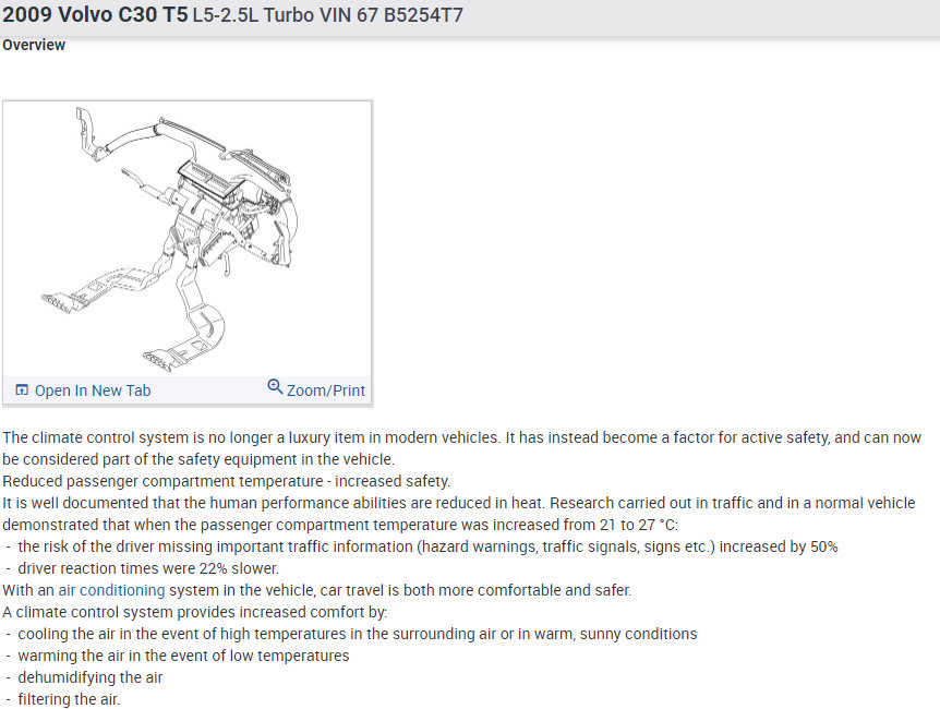

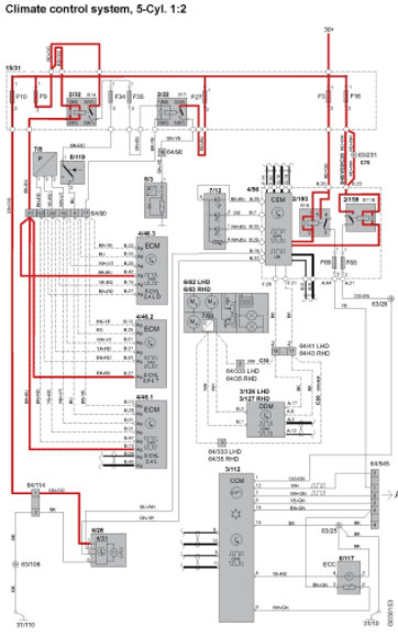

Well, if you are unable to effectively change the speed of the air then your issue might be the blower motor or the blower switch.
Even if your A/C needs recharge, you still be able to increase/decrease the fan speed as normal. Only issue you would have is the temperature will not the ideal but the fan speed would be correct.
Do check your A/C to make sure it is fully charged, however if the issue does not change the blower fan is a good place to look. I have attached diagrams for your blower system.
Let me know of any questions.
