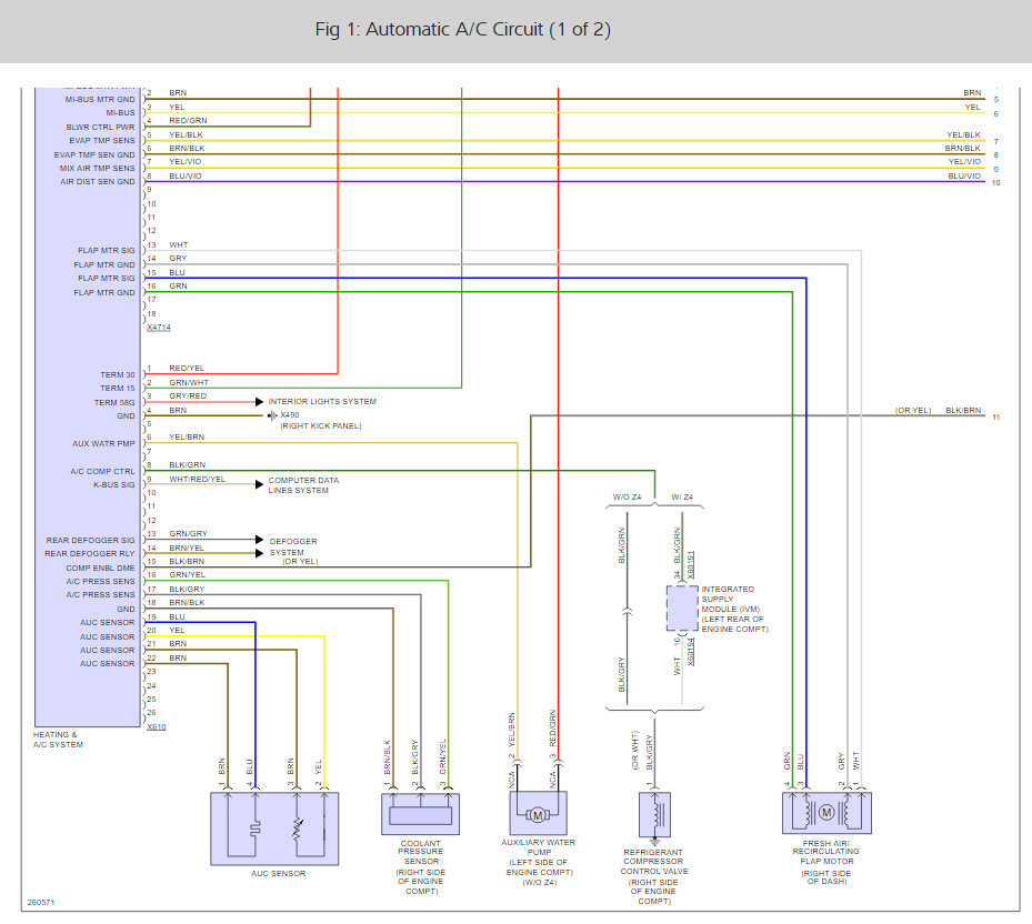

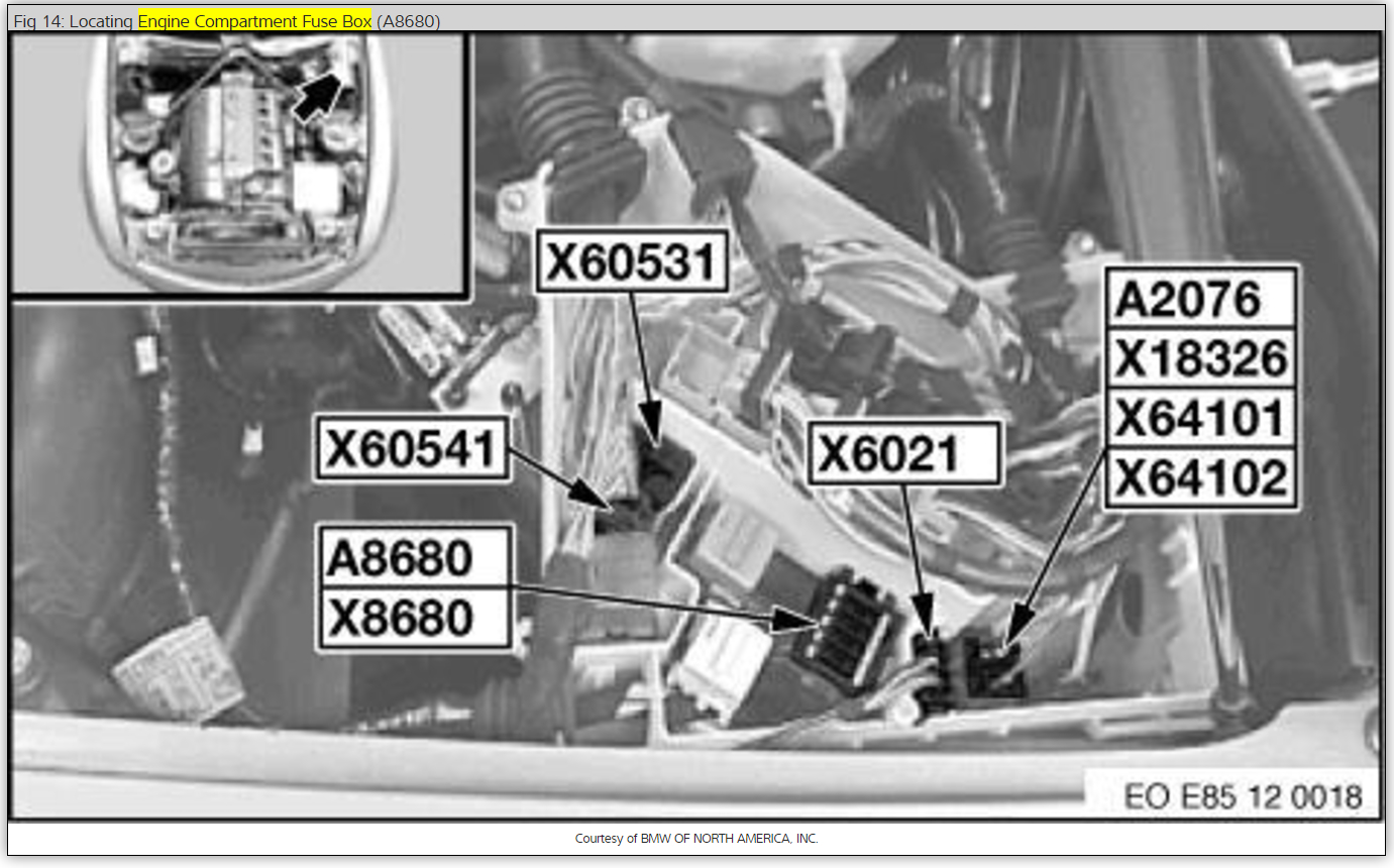

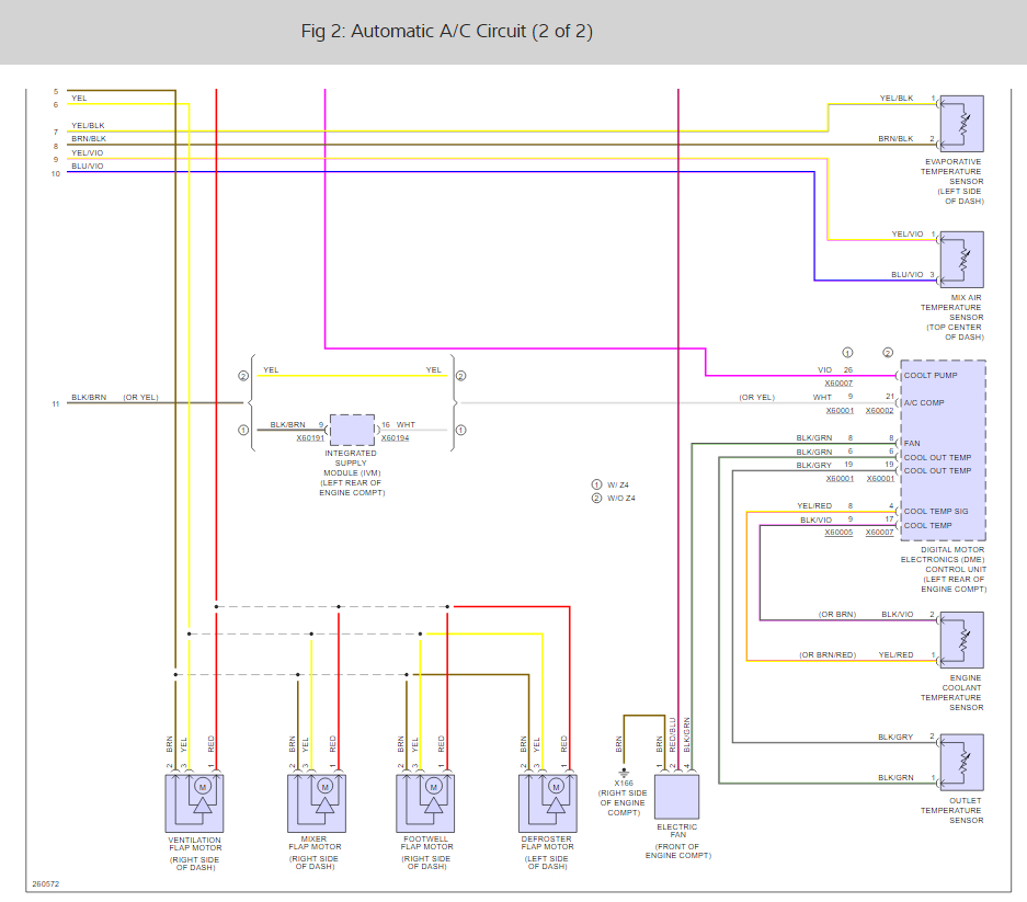

The fan will not blow on high and the indicator button for the air conditioners will not light up when pushed.
Jul 30, 2017 at 10:58 AM
  • 55,433 POSTS

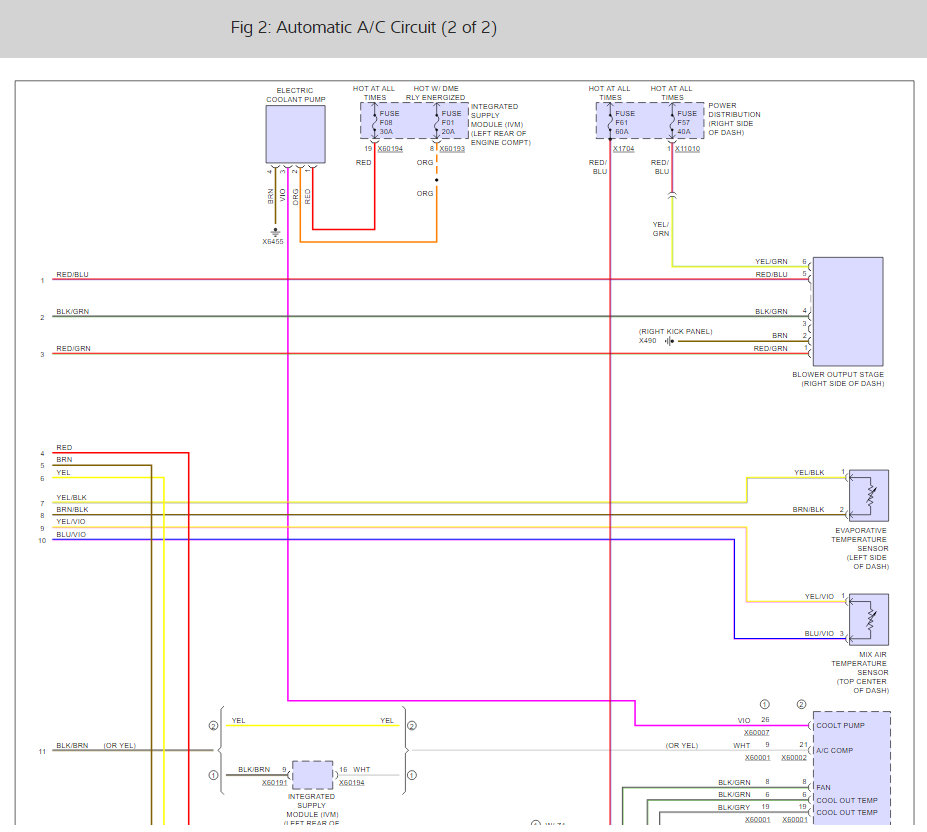

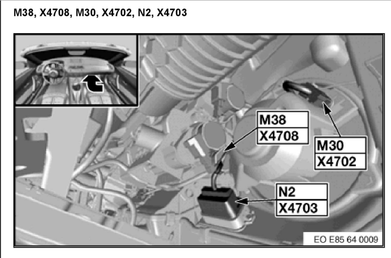

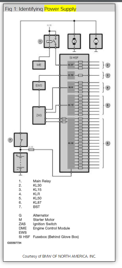

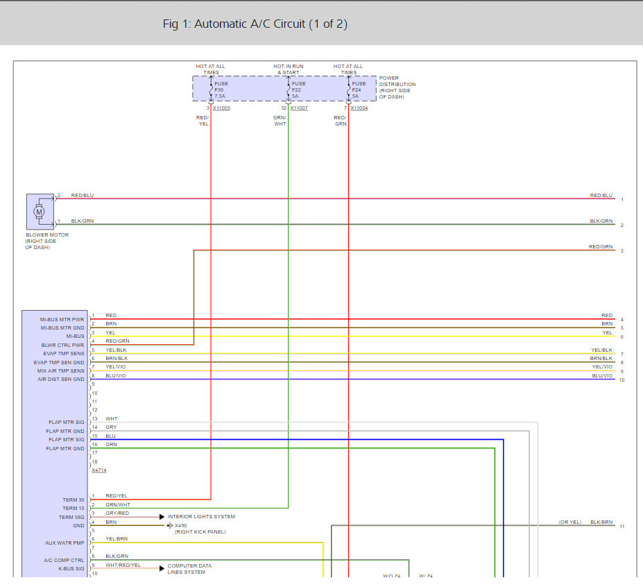

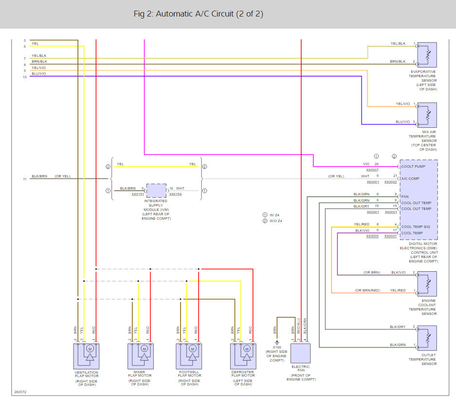

It sounds like you have a blower motor controller that has gone out. But to be sure here are some guides so you can do some simple tests. First check the fuses.
and
and
https://www.2carpros.com/articles/blower-fan-motor-works-on-high-speed-only
Please run some tests and get back to us we are interested to see what it is.
