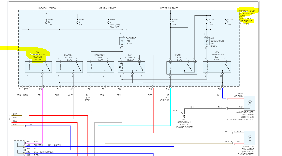

usually the A/C works good for 20 or 30 minutes then blows hot air. After the car warms up the motor shakes when the car is idling, and compressor clutch engages. it's my wife's car so i really need some advice.

If it is working properly for 20 to 30 minutes and then stops, have you noticed if the compressor clutch stops engaging? Also, does the condenser/cooling fan under the hood stop running?
Since it works and then doesn't, the first thing I'm thinking is a faulty compressor clutch relay. It is located in the under-hood fuse box. See attached schematic below.
Try this. Switch the relay with a different one in the box having the same part number and see if the AC continues to run. If there isn't one, here is a link that explains how to test a relay and circuit:
Let me know what you find.

compressor clutch and fans working after the motor warmed up the whole motor would shake when the compressor clutch would engage. i read where one person said the cabin air filter could make a big difference. Another person said it didn't anyway mine was very dirty so i changed it and so far, the A/C is working like it should so I'm keeping my fingers crossed.
