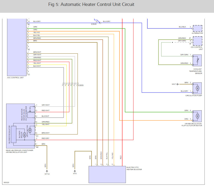

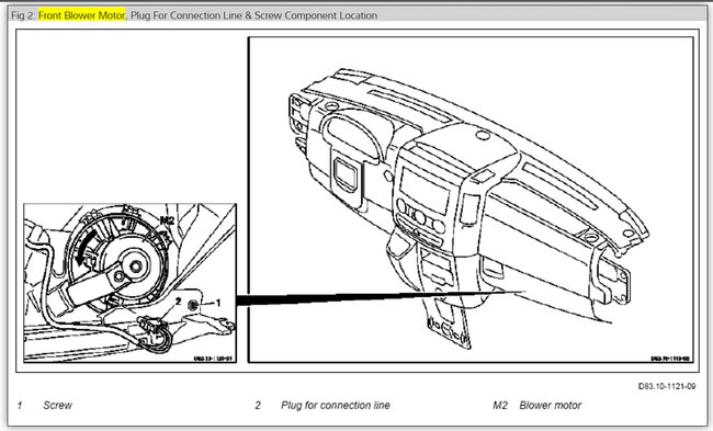

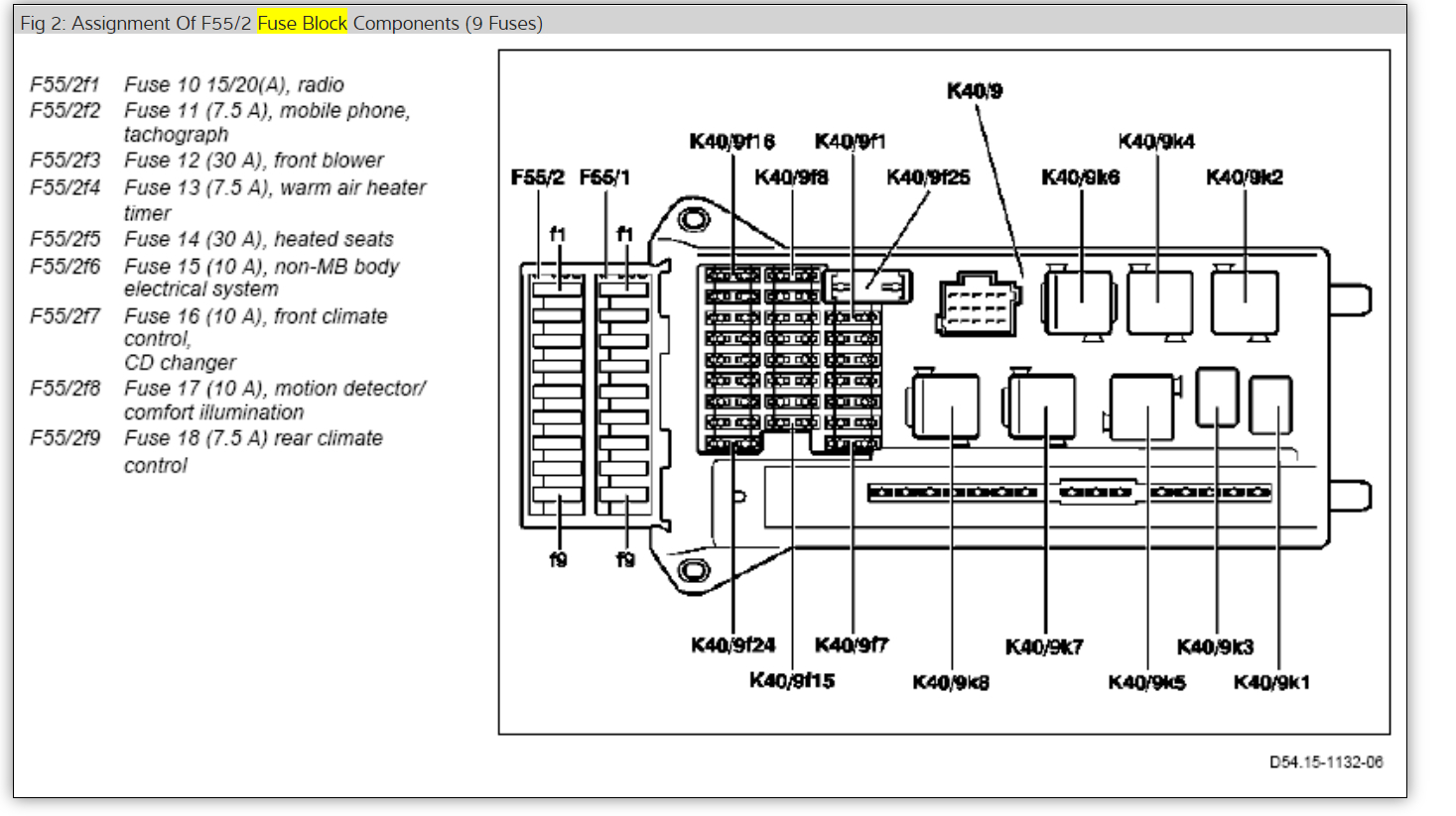

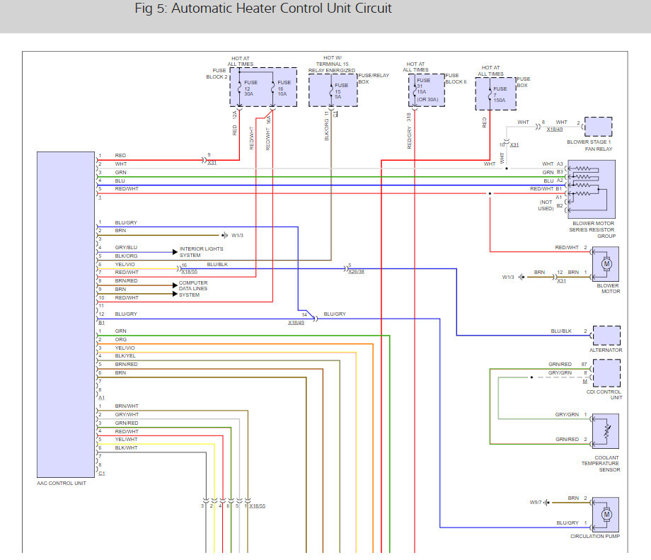

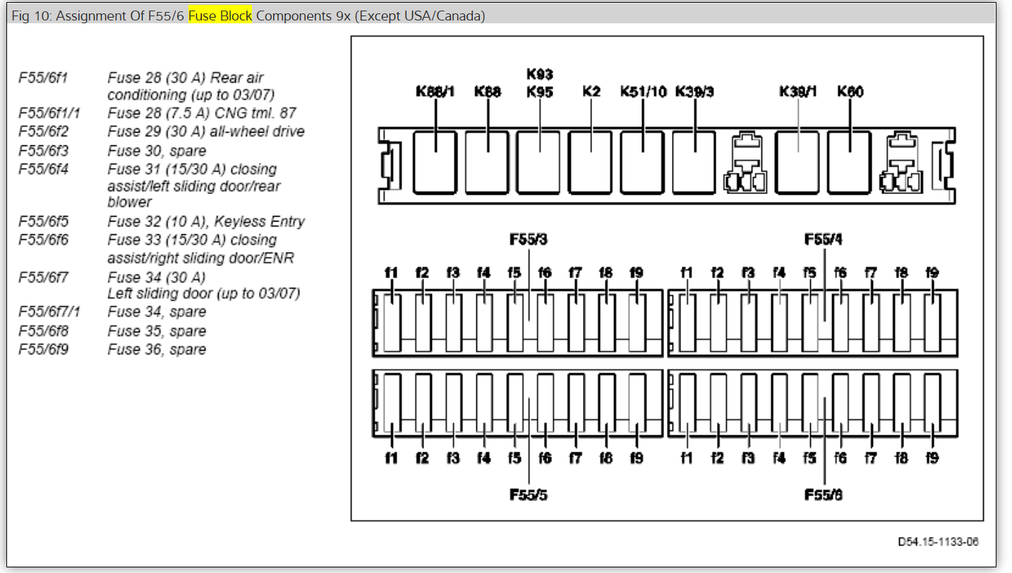

The A/C stopped blowing abruptly. I still feel cool air flowing through vents.
Aug 21, 2018 at 1:29 AM
  • 55,399 POSTS
It sounds like the blower motor has gone bad or you have a fuse # 13, 15, 16, or 31 out. If the fuse is good lets check for power and ground at the blower. Here is a guide to help us get started the wiring diagrams so you can see how it works and the blower motor location below:
https://www.2carpros.com/articles/blower-fan-motor-works-on-high-speed-only
and
Check out the diagrams (below). Please run some tests and get back to us.
Aug 23, 2018 at 3:13 AM
SPRINTERJIM
Thanks so much for your reply. I believe it is the blower fan motor. There are times the system will start to blow cool air at like medium only speed only. Do not think it could come on randomly if bad fuse.
Aug 23, 2018 at 6:05 AM
  • 55,399 POSTS
Yep, it sure sounds like it. Let me know after you replace it and if you can take pictures and upload them in your response that would be great. Also, check for power and ground at the motor to confirm the issue.
