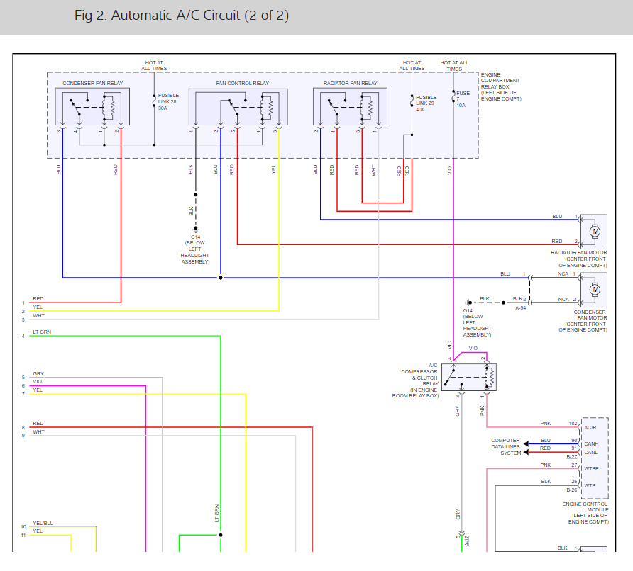

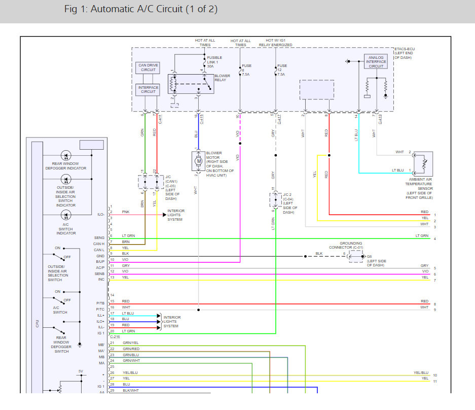

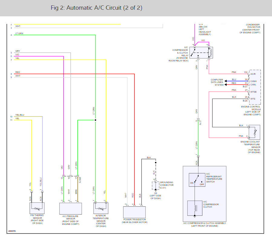

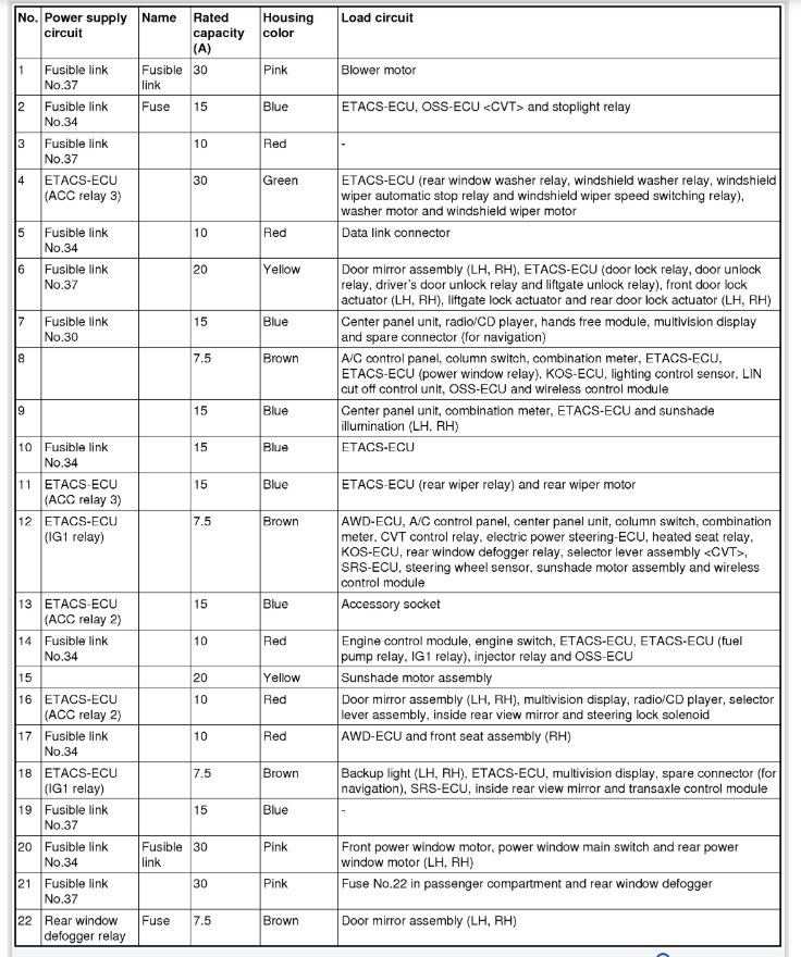

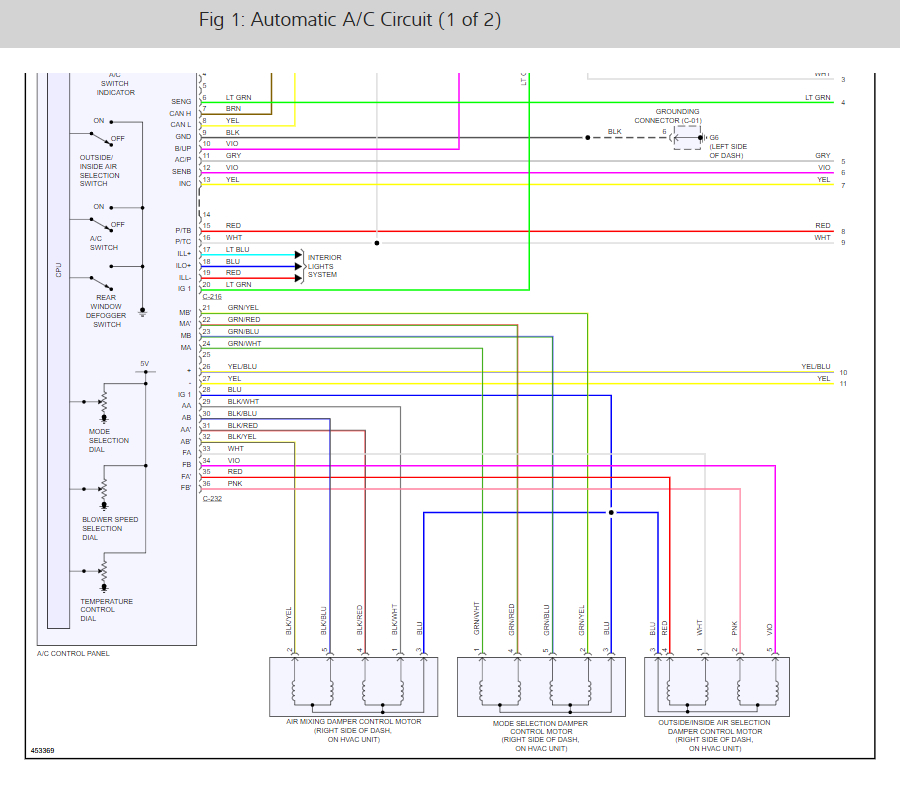

Air condition for my car has problem, during AC on, clutch no engaged.
Could you please send to me exploded drawing for repairing it?
The VIN : 4p3xtga2wee801499.
Thanks
Sep 4, 2019 at 12:10 PM
  • 55,421 POSTS

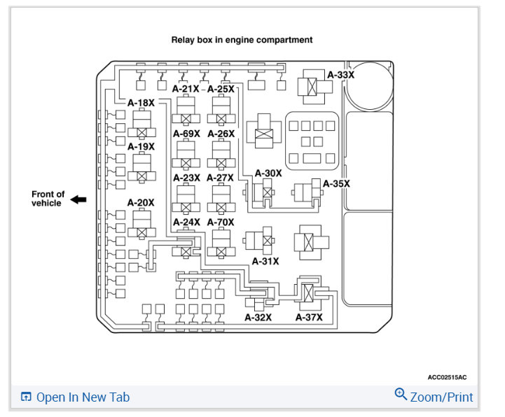

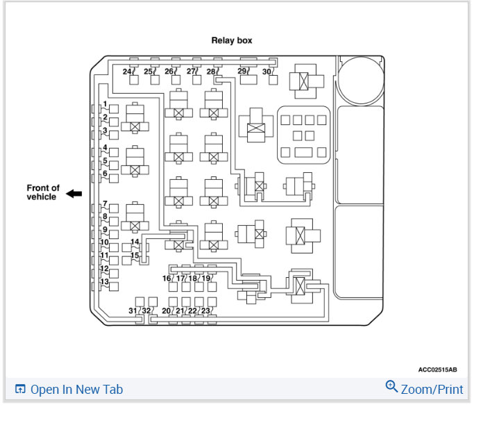

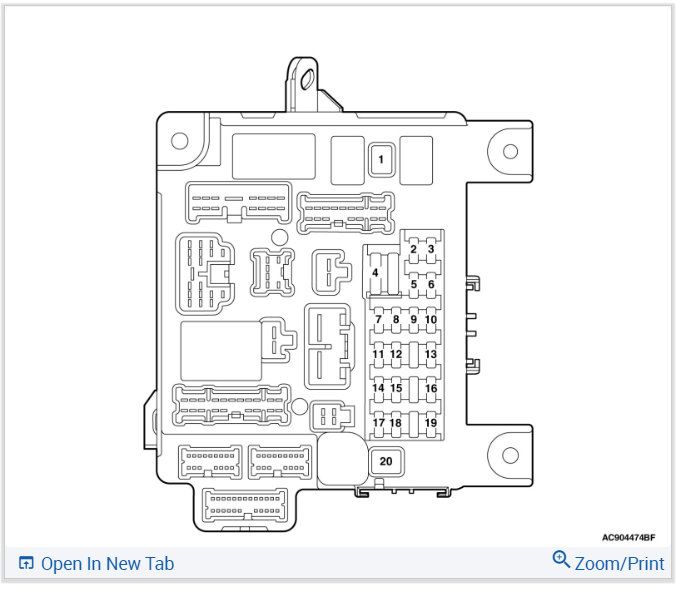

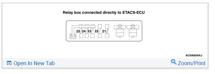

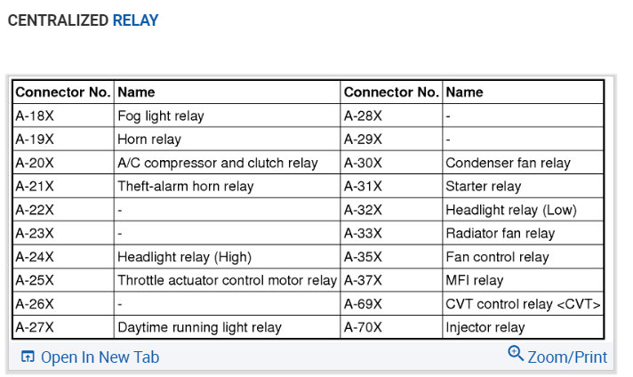

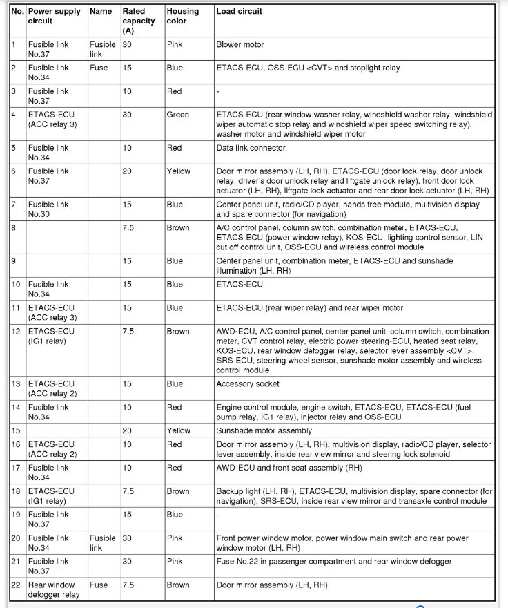

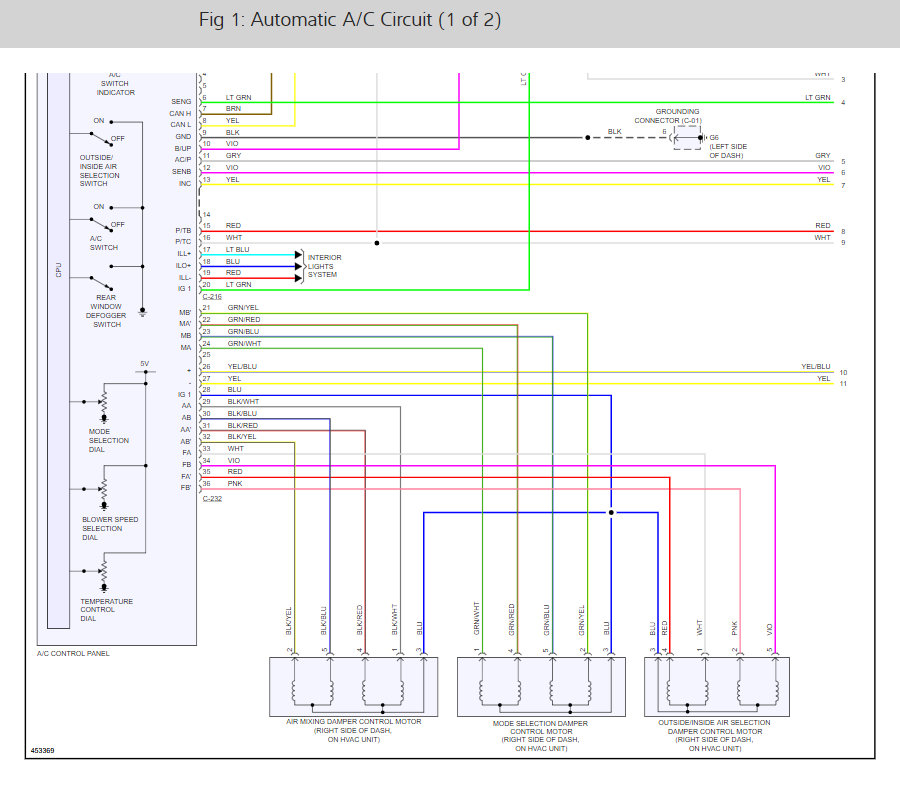

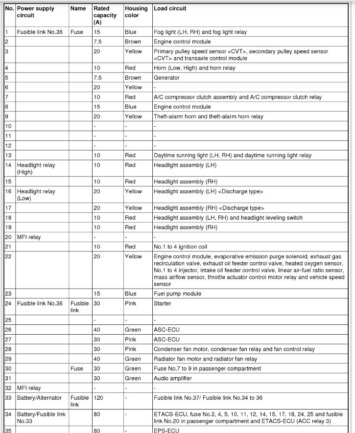

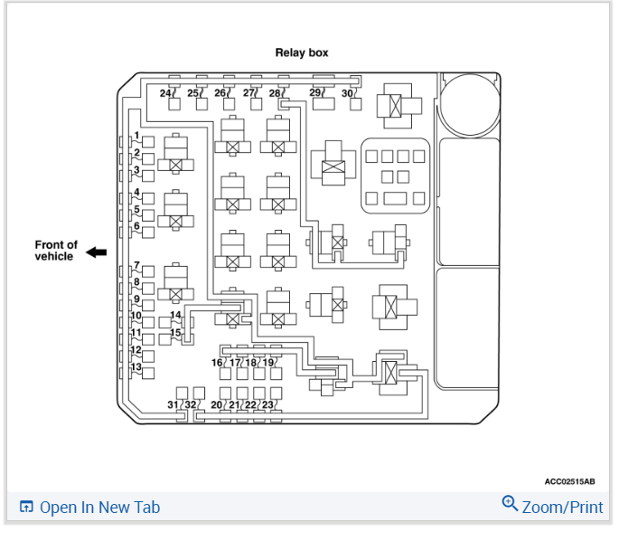

Here is a guide to help you test the wiring for the air conditioner and the fuses and relay locations as well:
