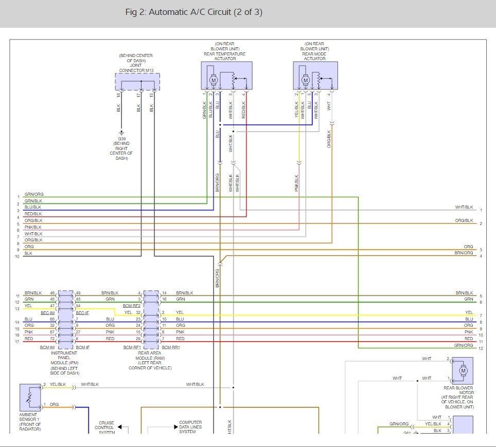

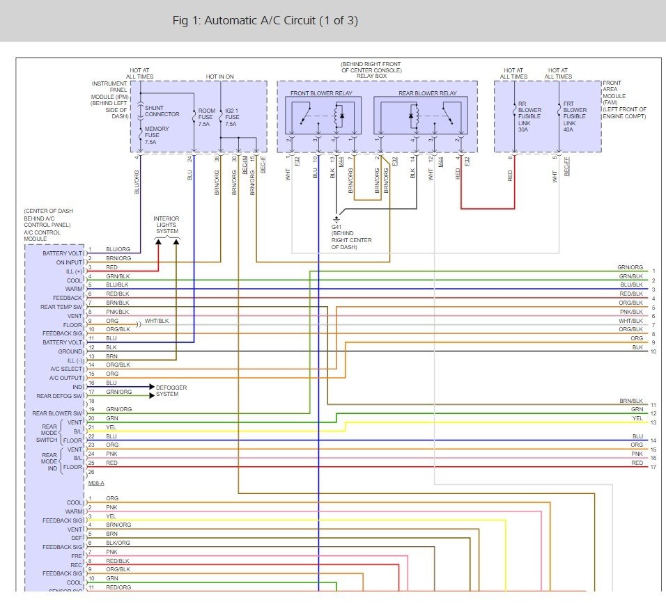

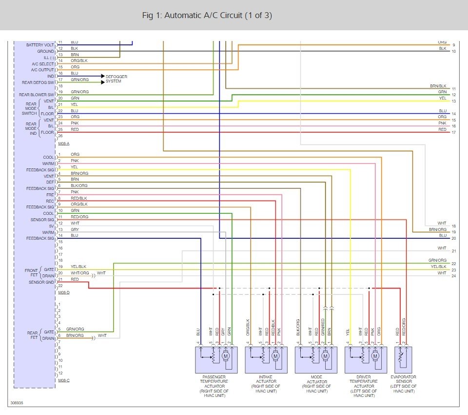

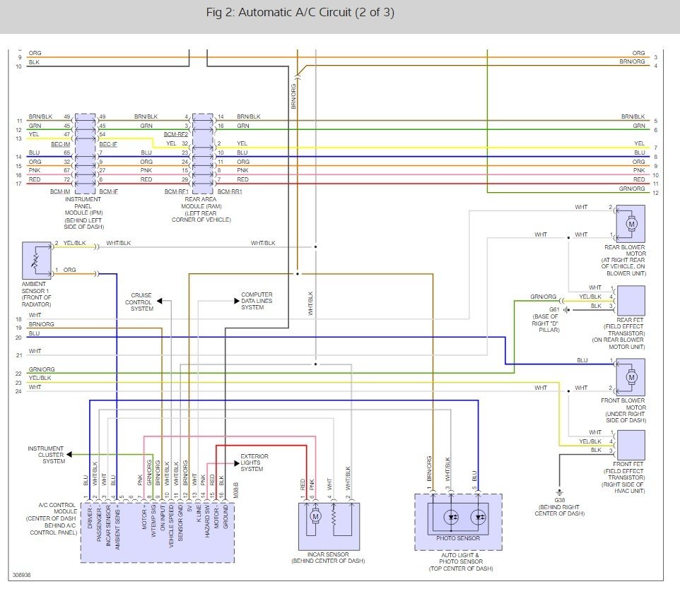

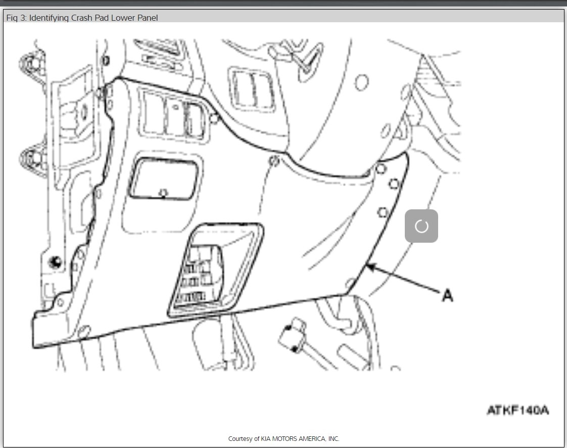

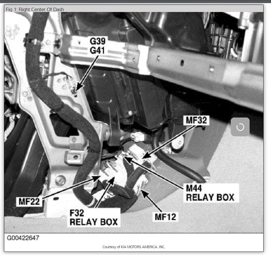

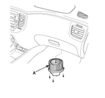

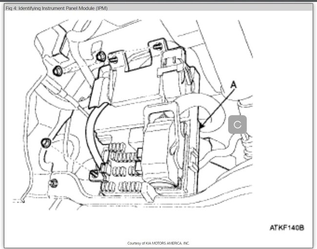

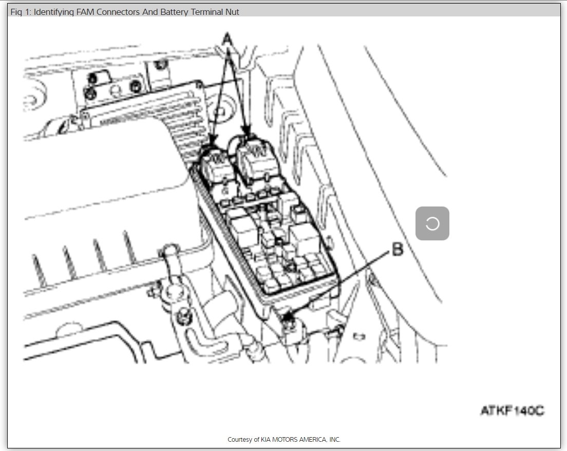

My air condition works in the rear but it will not blow at all in the front.
Jul 12, 2017 at 4:11 AM
Experienced Mechanic
55,766 POSTS

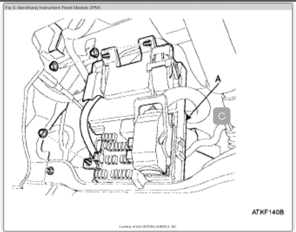

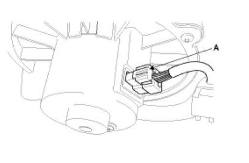

It sounds like you have a blower motor that could have failed. To be sure though lets check the easy stuff first.
Here is a guide to help check the fuses and relays:
and
and
and
https://www.2carpros.com/articles/blower-fan-motor-works-on-high-speed-only
Please run some tests and get back to us we are interested to see what it is.
