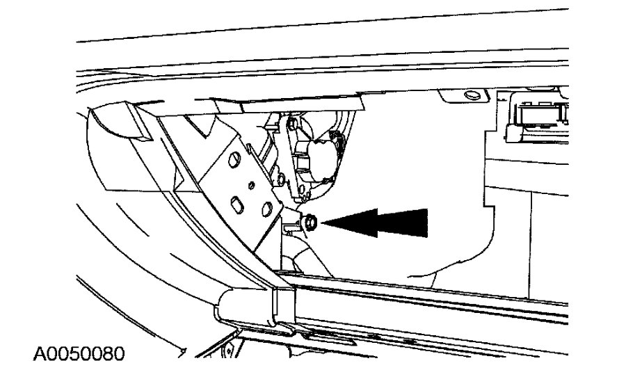

Turn the air condition on and the heat hand goes to hot in just a minute .no problem with heat just when you put it on air.
Jan 7, 2019 at 8:25 AM
Good evening,
Can you hear the mode door move when you command cold to heat and back?
Common issue is the blend door actuator. Do you have dual controls? driver and passenger side control?
The actuator for the left side is under the left side of the dash and the right side is behind the glove box.
Right side
TEMPERATURE BLEND DOOR ACTUATOR - RH
Removal and Installation
1. Disconnect the glove compartment door damper cable.
2. Release the stops and lower the glove compartment.
3. Remove the heater core tube cover screw.
4. Remove the RH temperature blend door actuator.
1 Remove the 3 temperature blend door actuator screws.
2 Disconnect the temperature blend door actuator electrical connector.
3 Remove the RH temperature blend door actuator.

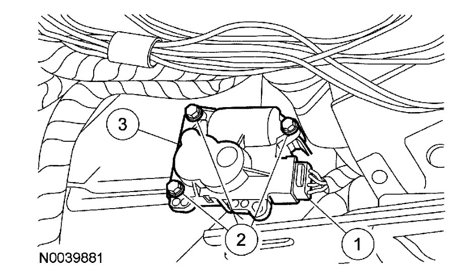

left side
TEMPERATURE BLEND DOOR ACTUATOR - LH
1. Remove the LH lower instrument panel insulator.
2. Remove the lighting control module (LCM).
1 Detach the vacuum line.
2 Remove the screws.
3 Disconnect the LCM electrical connectors and remove the LCM.
3. Remove the LH temperature blend door actuator.
1 Disconnect the temperature blend door actuator electrical connector.
2 Remove the 3 temperature blend door actuator screws.
3 Remove the LH temperature blend door actuator.
