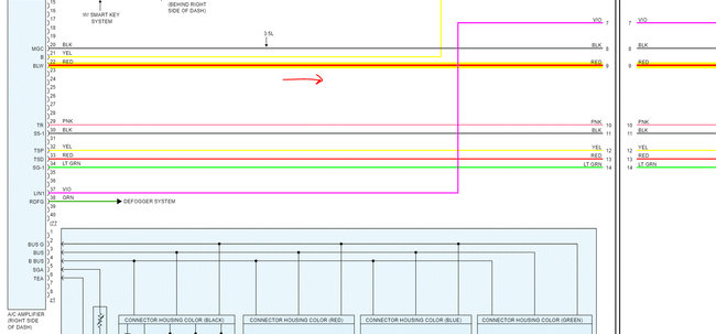

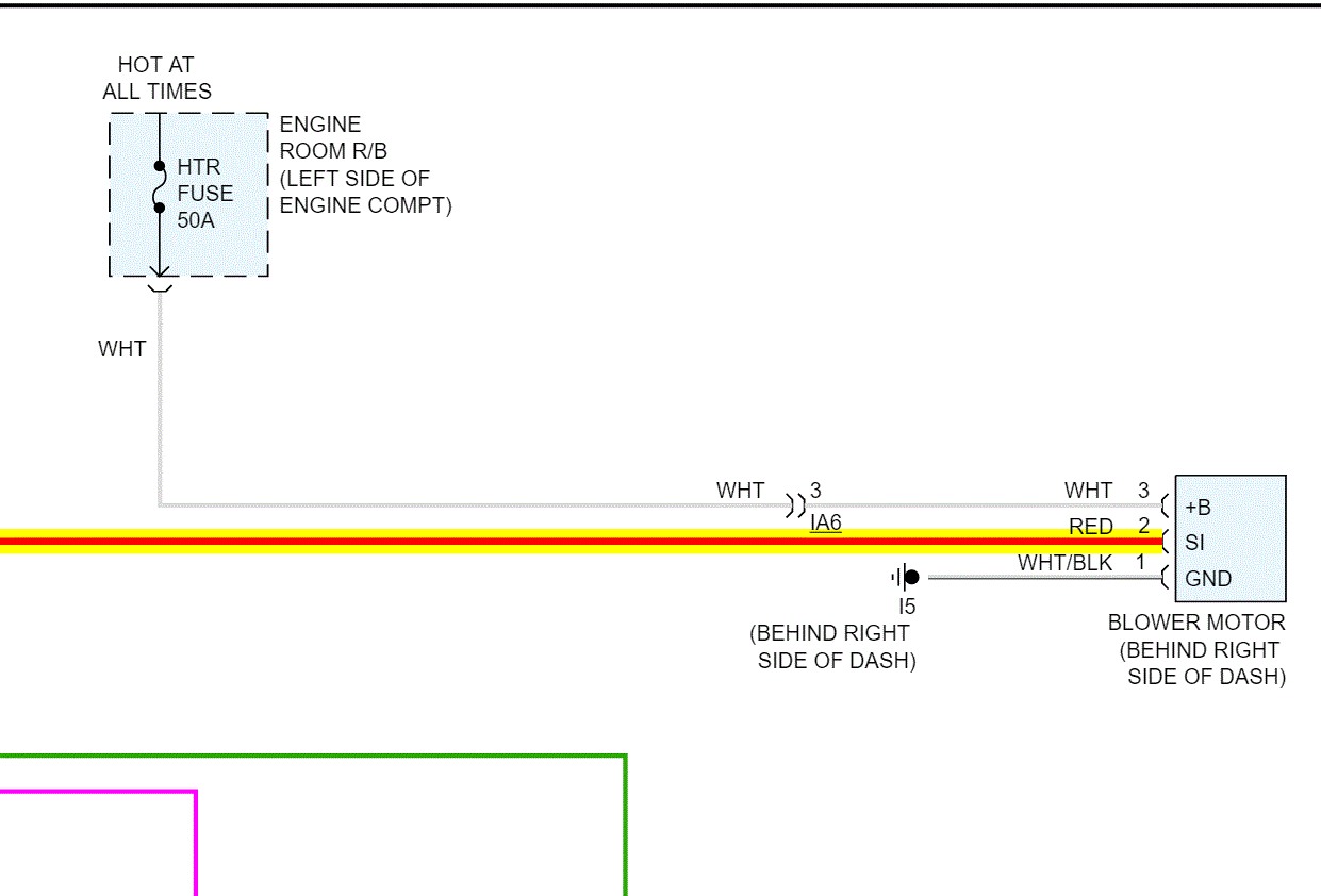

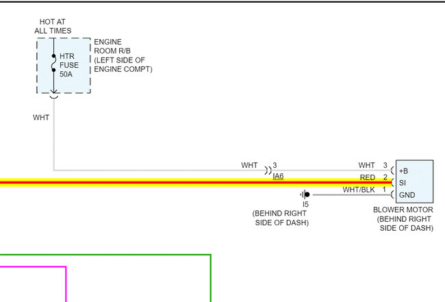

My blower motor does not work, I can confirm power 12v and ground, but no power or signal on red wire.
Sep 19, 2020 at 5:28 AM
  • 110,244 POSTS

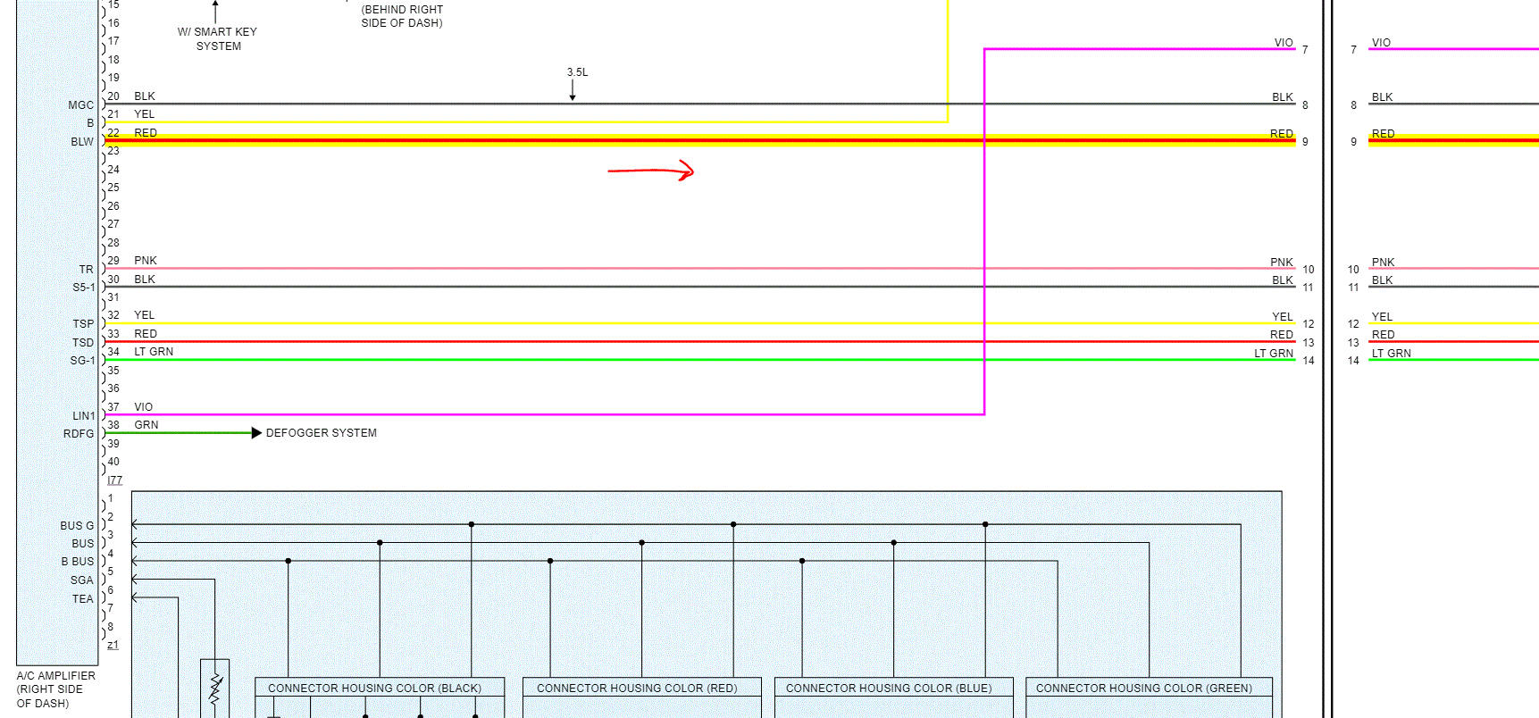

On the right side of the dash is the AC amplifier. Check for power at that point to the red wire. This guide can help
https://www.2carpros.com/articles/blower-fan-motor-works-on-high-speed-only
I attached two pics. Pic 1 shows where the red wire is coming from and pic 2 simply shows the blower motor and the fuse. I suspect you are referring to the white wire when you say there is 12v.

Correct the white wire has 12v. There is no power from the red wire at the A/C amplifier.

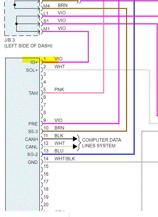

On the amplifier, check for ignition voltage at the violet wire (Pin 1). See pic 1.

Yes, violet wire has 12 volts when I turn ignition on.
Sep 21, 2020 at 7:43 AM
  • 110,244 POSTS
It sounds like the amplifier may be bad. One last test. Check for continuity to ground at the red wire.

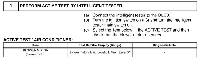

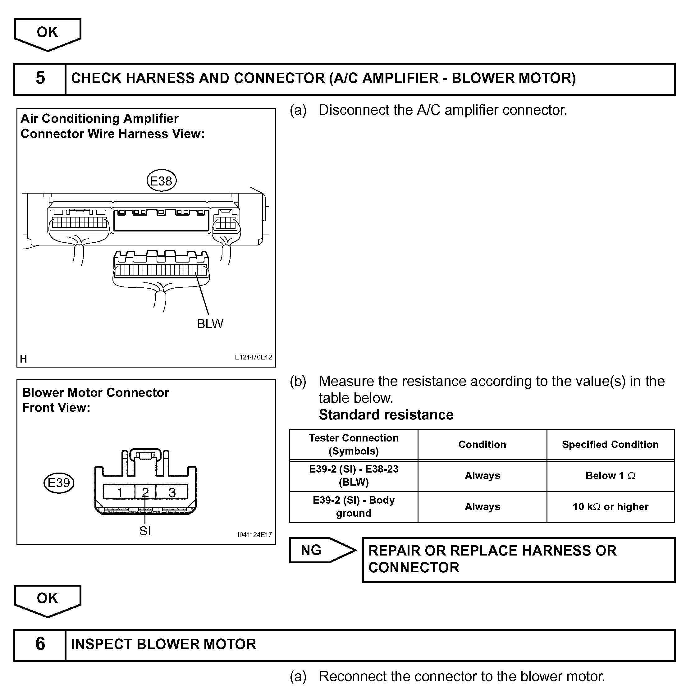

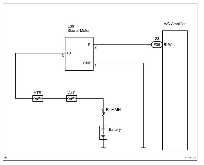

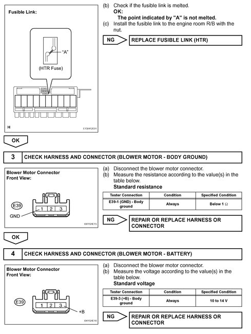

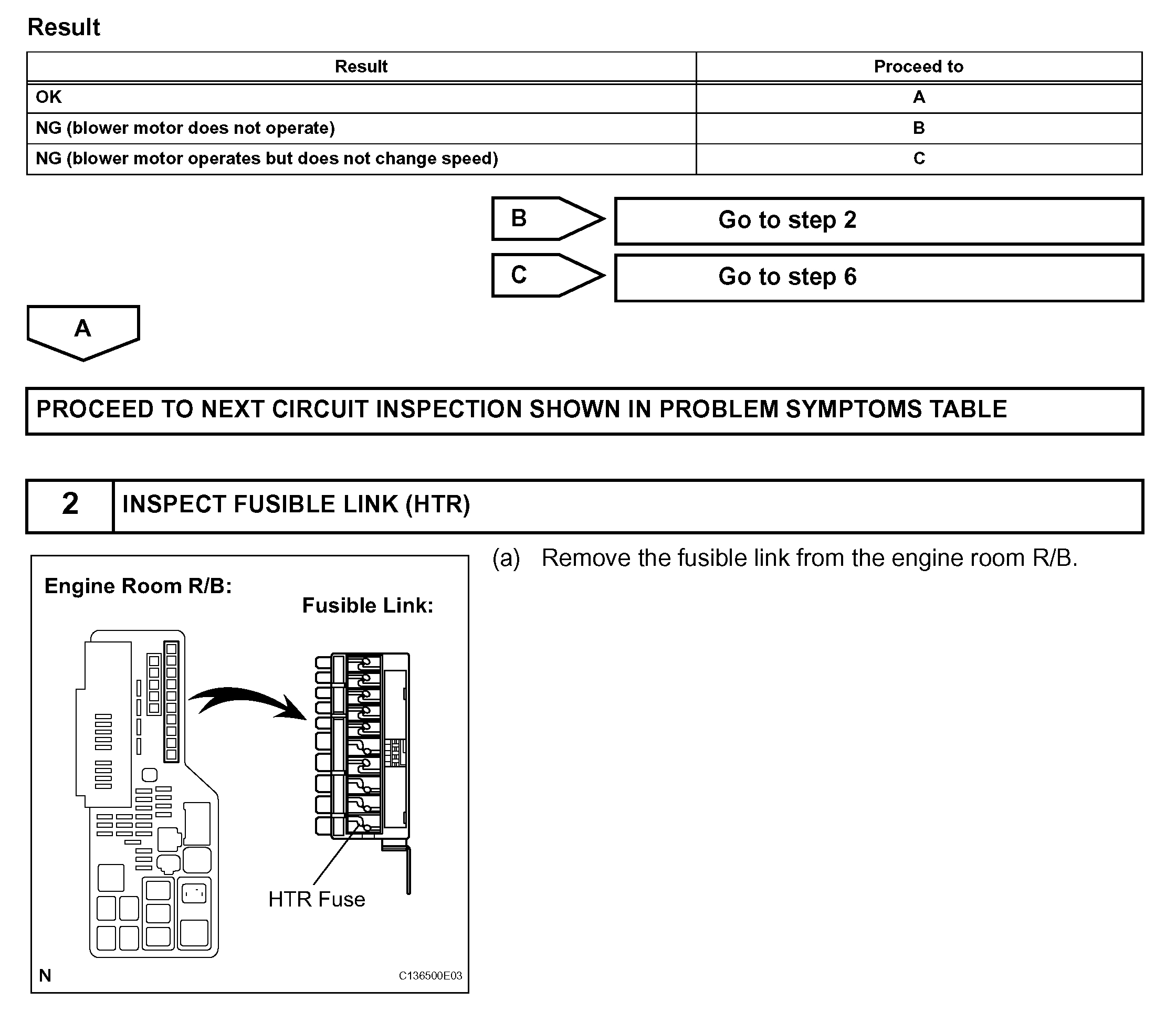

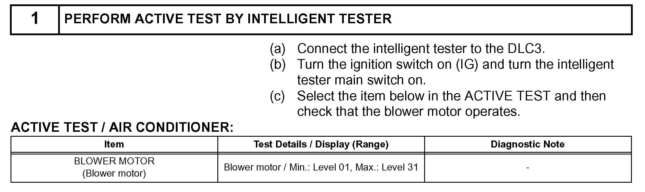

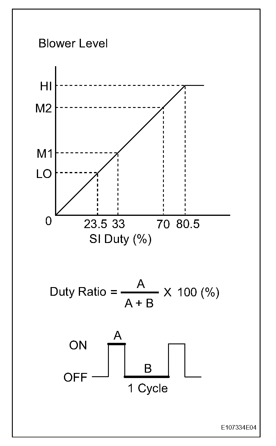

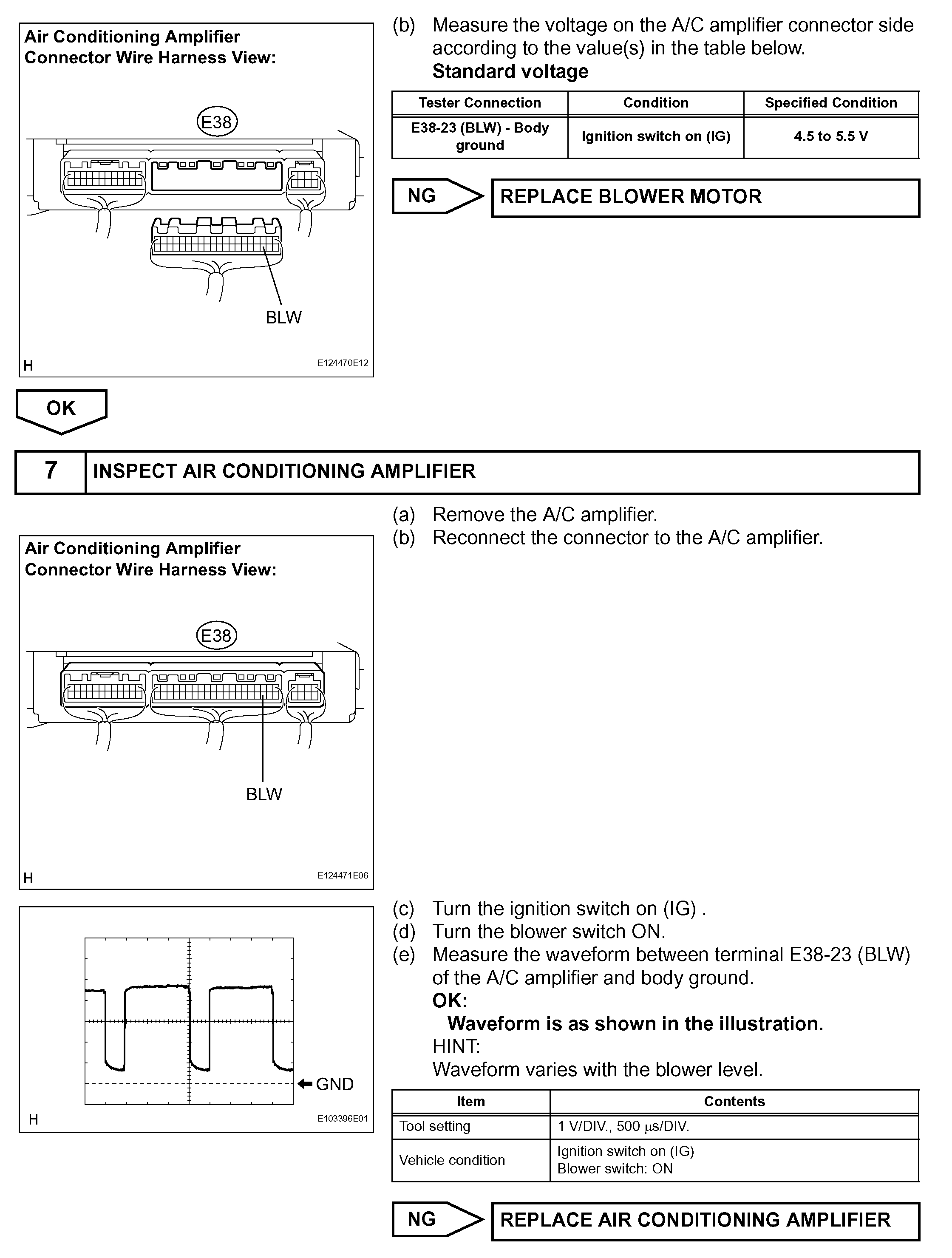

Also, I wanted to add the diagnostics for the entire blower motor system. The attached pics correlate with the directions.
The blower motor is operated by signals from the A/C amplifier. The blower motor speed is controlled using various duty ratios.
Duty Ratio: The duty ratio is the ratio of the blower motor ON time (A) to the total of the blower motor ON and OF time (A + B).
The blower motor controller controls the blower motor speed
INSPECTION PROCEDURE
HINT:
- AUTO A/C: Start inspection from step 1.
- MANUAL A/C: Start inspection from step 2.
