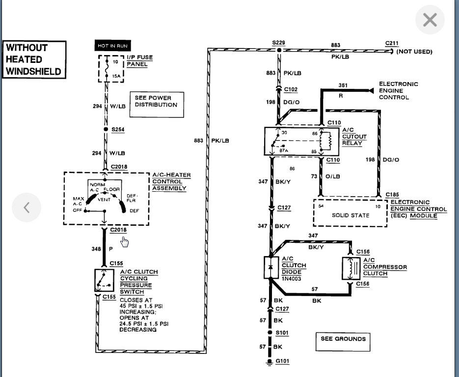

I replace A/C unit. A/C condenser,accumulator,orifice tube, A/C compressor,and pressure switch. had system recharge.every is working fine for a week. I notice the compressor staying on. It was not cycling on and off.then i notice a smell. The clutch burning.stop blowing cold air.does the A/C suppose be engage all the time?

The compressor is not supposed to be engaged all the time. If you smelled the clutch then more then likely the clutch has locked up and is not able to release. If you check power at the compressor I imagine it will not have power all the time but the compressor will still be engaged. If this is the case then your clutch is locked to the compressor and will not disengage. At that point, you can try and replace the clutch but if it were me, I would go ahead and take the compressor back if you purchased this as a unit.
Let me know if you have questions and we can figure out next steps.
Jun 5, 2020 at 12:32 PM

I will try to change the clutch. The compressor is out of warranty. What makes the clutch cycle off and on? I told you the clutch stay engage all the time. I think that why the clutch burned up.
Jun 6, 2020 at 1:58 AM

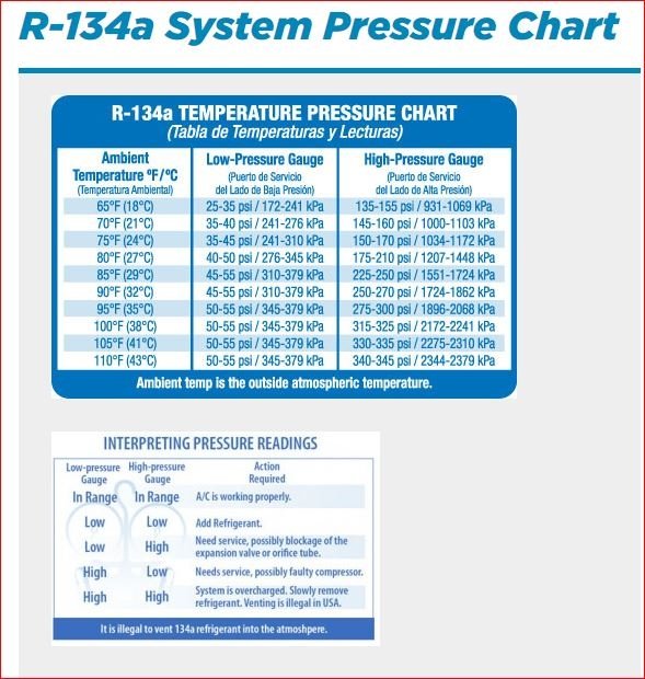

I understand it stays engaged all the time but to determine what is causing it to stay on, we need to check voltage at the compressor. Basically this will tell us if it is being commanded on all the time and if not, then the clutch is seized.
More then likely this is the clutch being seized. However, if the compressor doesn't cool at all then we need to check pressures to determine if the compressor has failed or if the clutch is just not disengaging.
I suspect the compressor has failed and not just the clutch because if the compressor doesn't disengage, I would expect there to be cold air coming out until the system built up too much pressure. The fact that the compressor stays on and there is no cold air, I suspect the compressor is not building any pressure and checking the high and low side pressures will tell us that.
