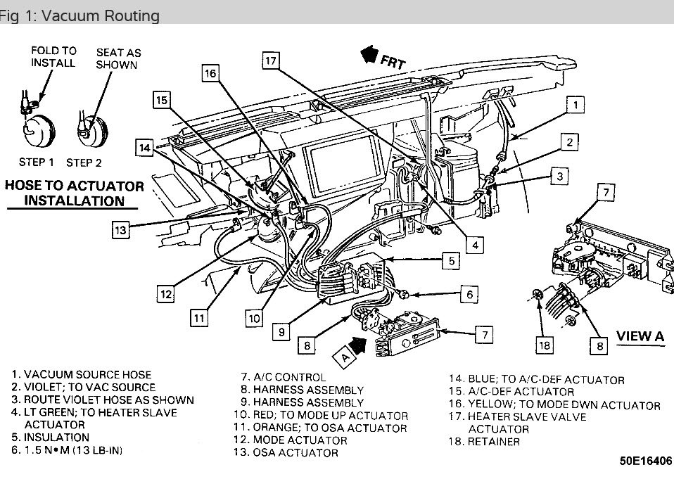

My cold air is not blowing through my front vents nor through defrost.

I am assuming this Is manual A/C. check for a vacuum leak it may be on engine side or leading to and including switch or vacuum motor. you want the vacuum motor that leads to defrost/heat/vent it is marked in picture.
