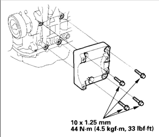

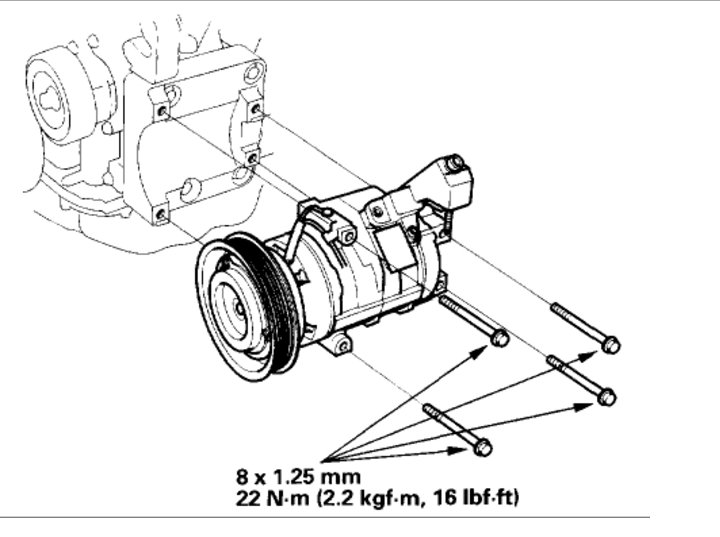

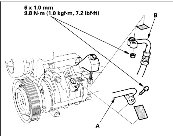

How do I fix the pump to A/C?
Monday, August 7th, 2017 AT 11:19 AM
KEN L
MASTER CERTIFIED MECHANIC
48,363 POSTS
Yes to change the compressor you will need to remove the refrigerant before you begin. Here is some guides and diagrams (below) to help you get the job done.
and
https://www.2carpros.com/articles/replace-air-conditioner-compressor
Images (Click to make bigger)
