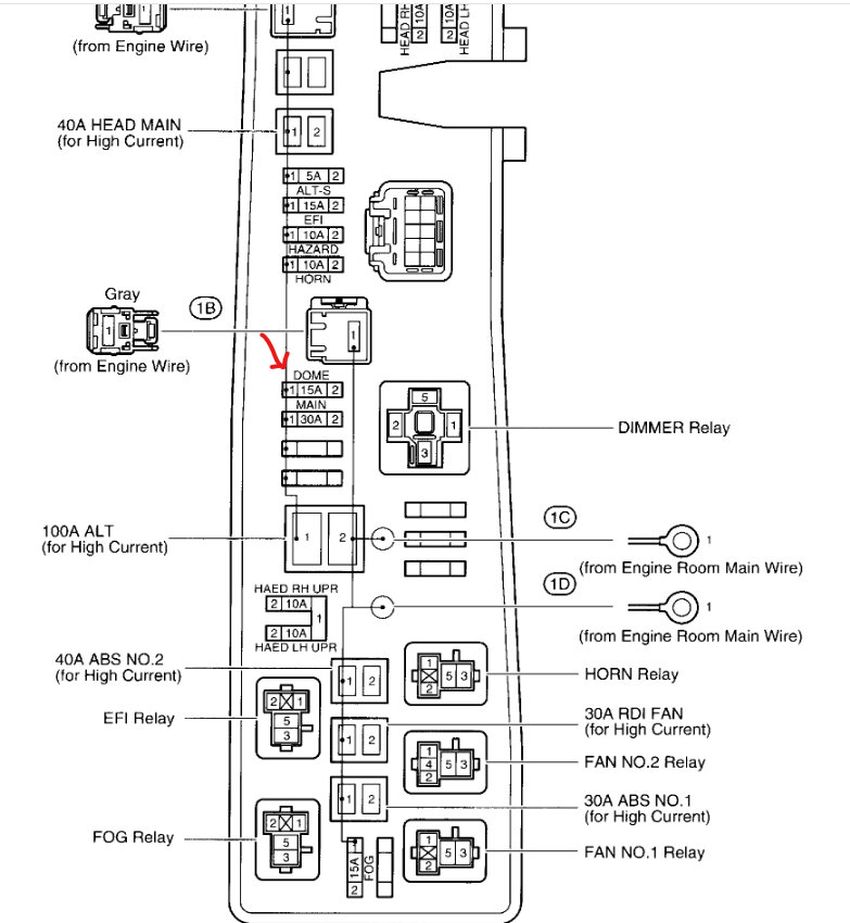

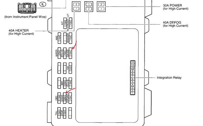

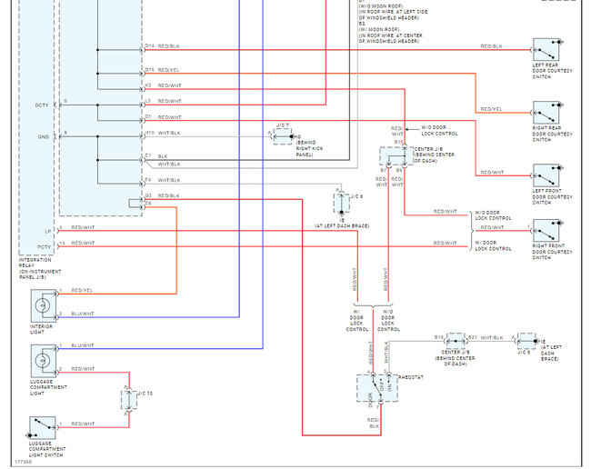

my A/C was working, and I installed an aftermarket radio in the dash but now the on/off button for the A/C doesn't light up when pushed to on and I have checked all the fuses and relays with no change in the problem. Please give me some insight into the cure.
Aug 19, 2024 at 1:48 AM
  • 55,721 POSTS

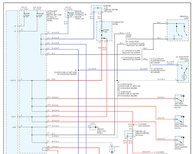

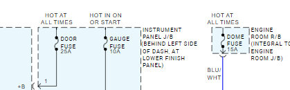

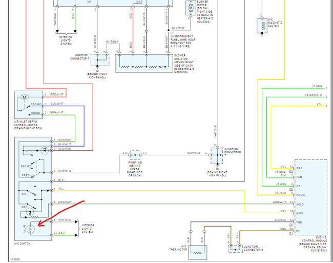

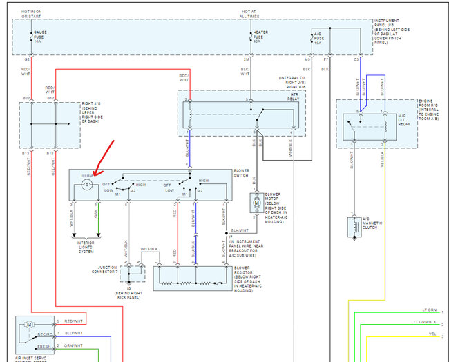

Was there a red and white wire you used to power the radio? If this wire was cut it powers the heater relay so you should put it back. Also, can I ask if the dome lights and dash illumination are still working? If not, I would check for power at the dome, gauge and door fuses here is a guide to help and I have included wiring diagram partials to help you see which fuses to check for power and how the system works.
The integration relay powers the button light. Check out the images (below). Please let us know what happens.
