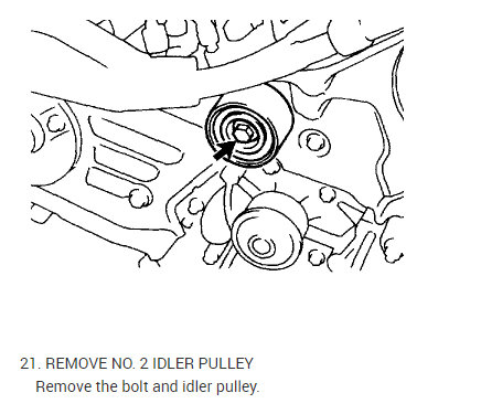

Deceased brothers' car. Bought it ran fine A/C worked fine for 800 miles... A/C quit. no cold air. Temperature gauge fine for nest 150 miles. Stopped 5 min. started car, blew cold air... 8 miles later temperature gauge on hot. Added hot water, temperature gauge came down to normal. I drove 100 miles slowly, the temperature gauge was okay, but still leaking coolant underneath the car. grinding sound from near water pump. Quit leaking made it home another 100 miles... Problem?

The water pump is driven by the timing belt. Are you able to see if there is any evidence of it leaking? You will need to remove the upper belt covers to see the pump fully. If you do this, see if there is any side-to-side play in the pulley.
If there isn't, we need to pressure test the cooling system to see where the leak is coming from. You will need a pressure tester, but most parts stores will lend one to you.

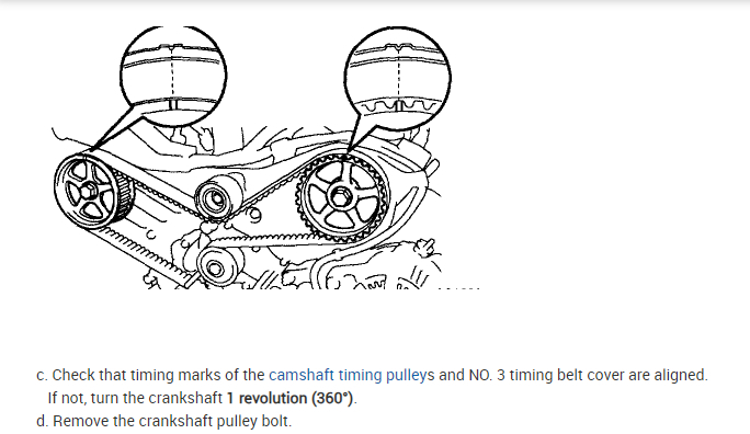

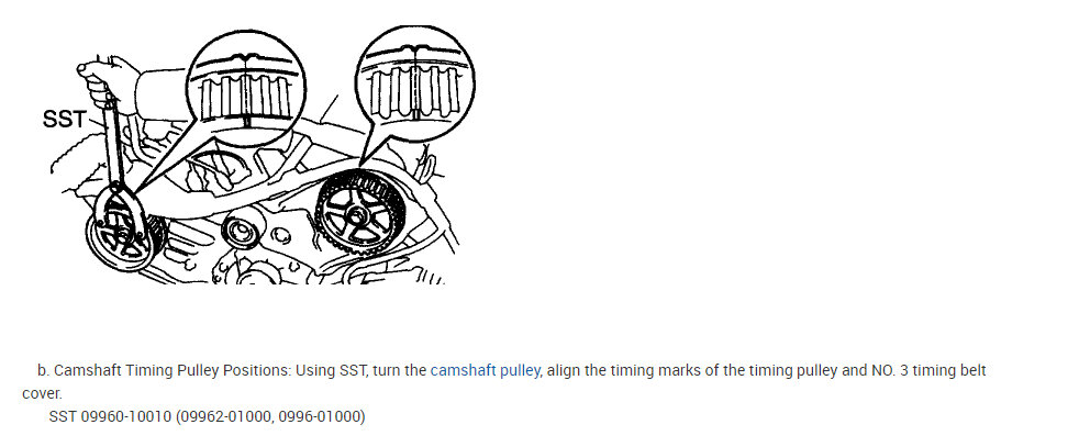

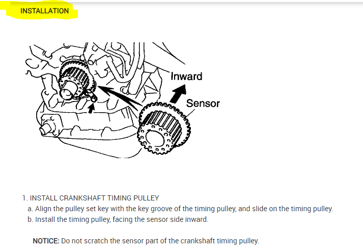

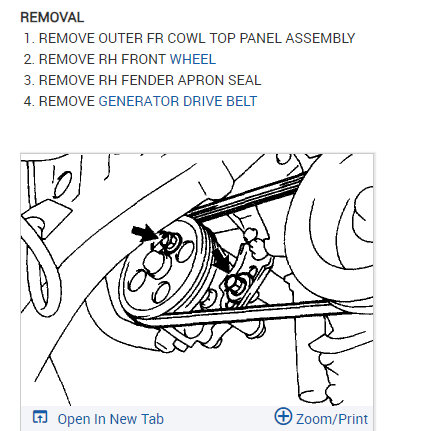

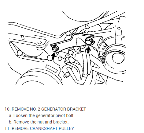

There is definitely a constant coolant leak dripping from underneath the water pump and weird abnormal noises coming from that area. I plan on having the water pump and timing belt replaced as there are 250,000 miles on the van. Is this a complicated job? I did this 50 years ago when cars were much simpler but at 72 years old, I am hesitant but can't afford a $1,000.00 repair bill either. Thanks.
Sep 4, 2024 at 12:35 AM
  • 110,248 POSTS

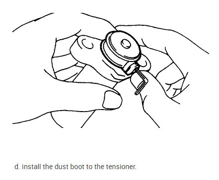

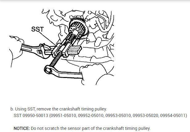

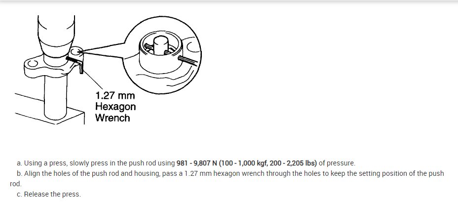

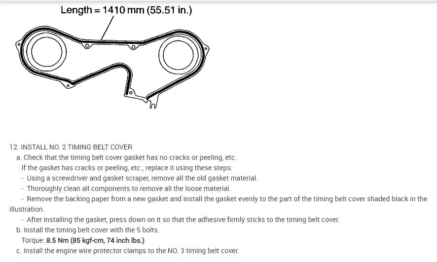

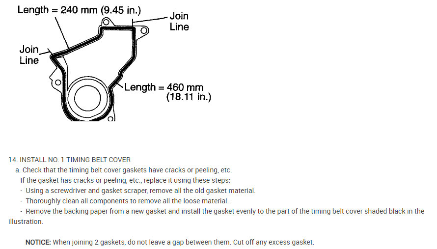

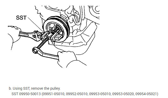

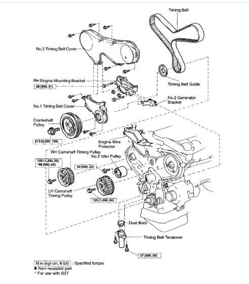

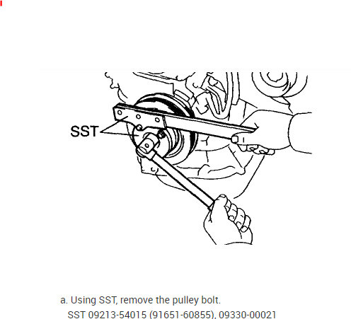

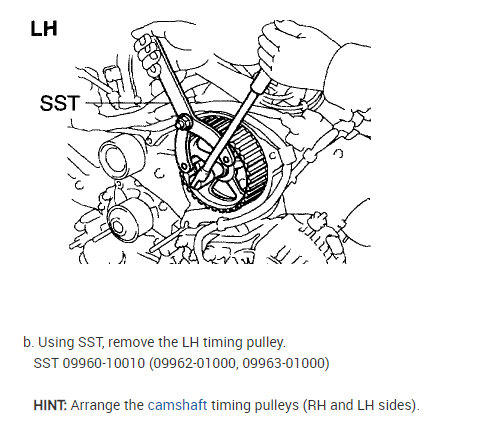

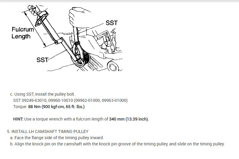

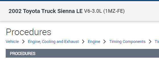

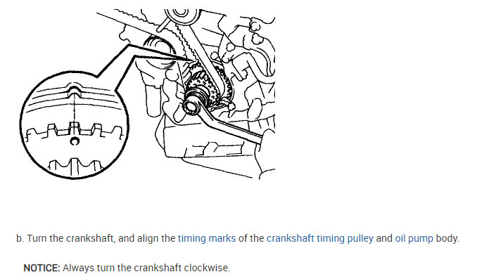

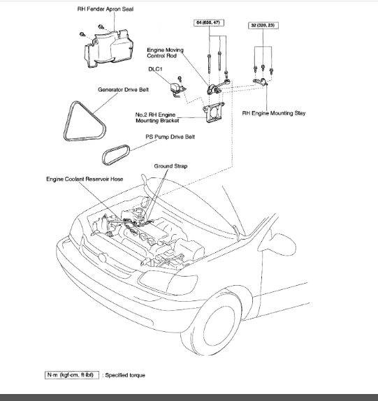

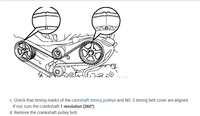

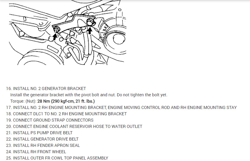

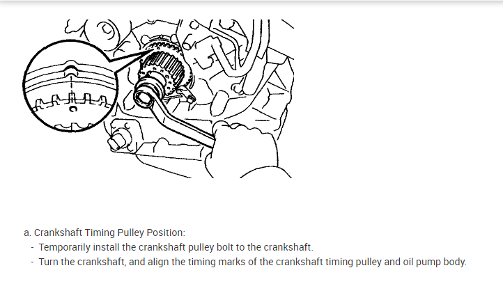

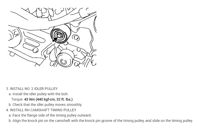

It sounds like that is where the leak is coming from. Also, 72 is the new 40, so you still have a lot of life left!!!

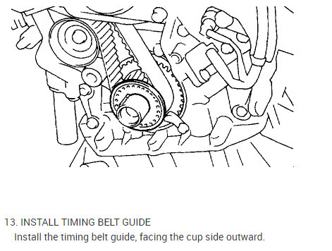

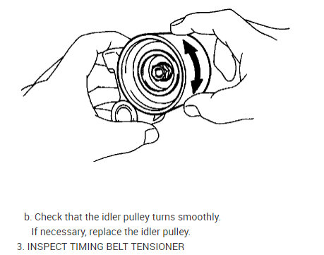

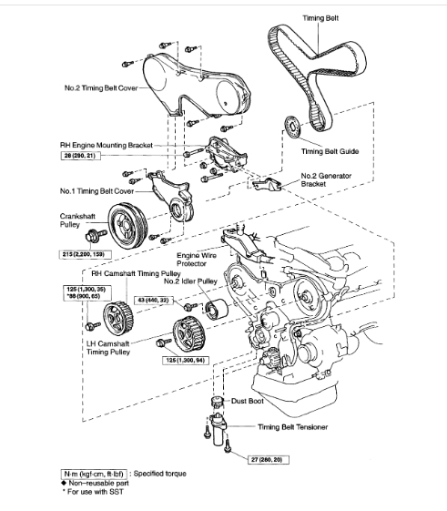

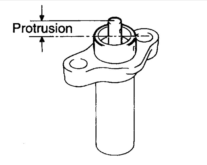

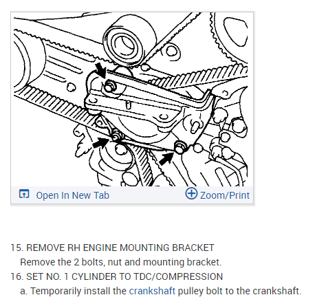

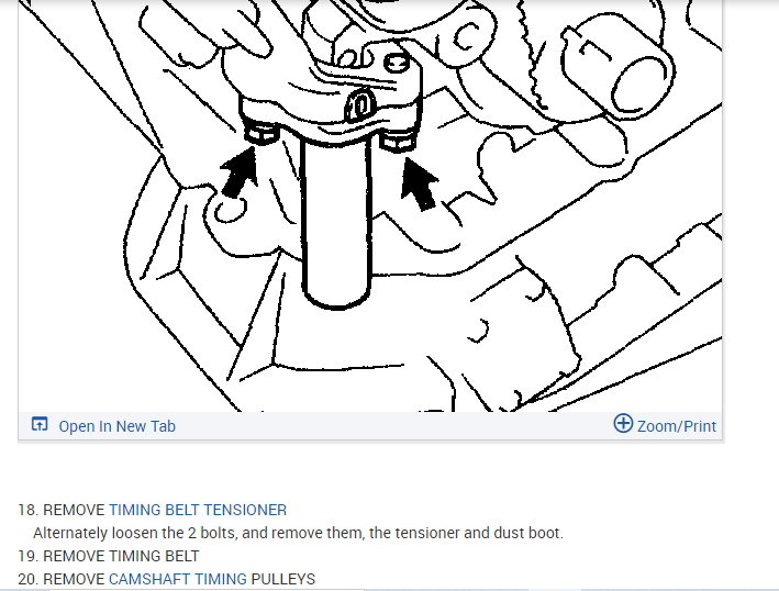

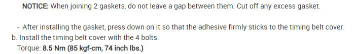

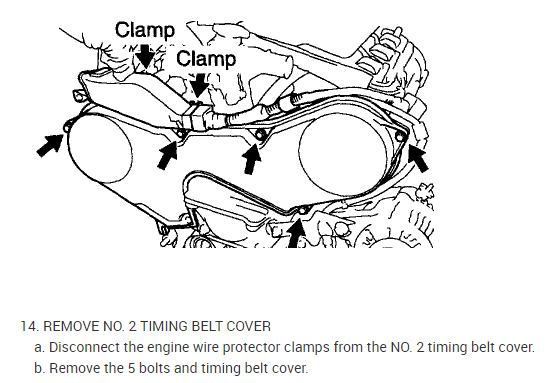

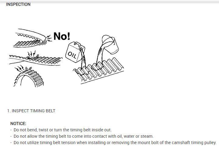

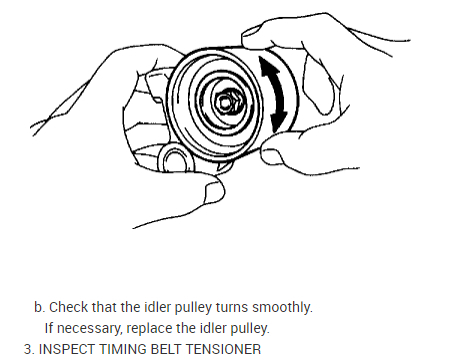

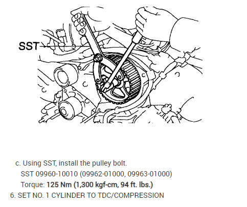

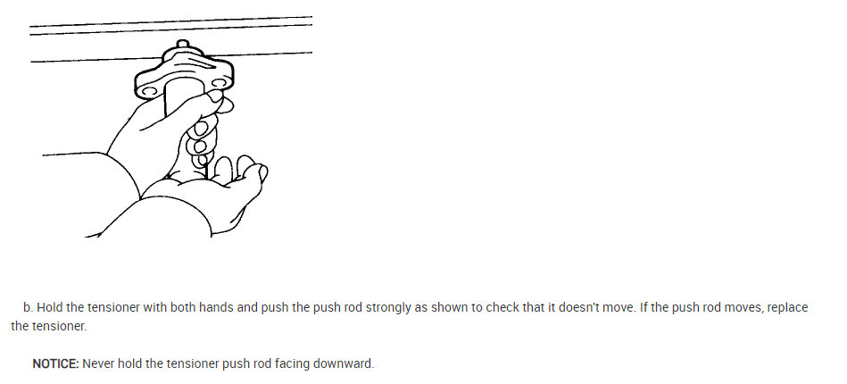

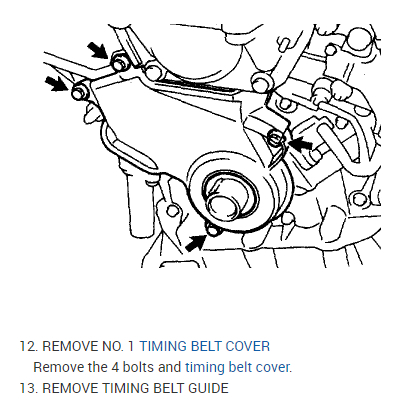

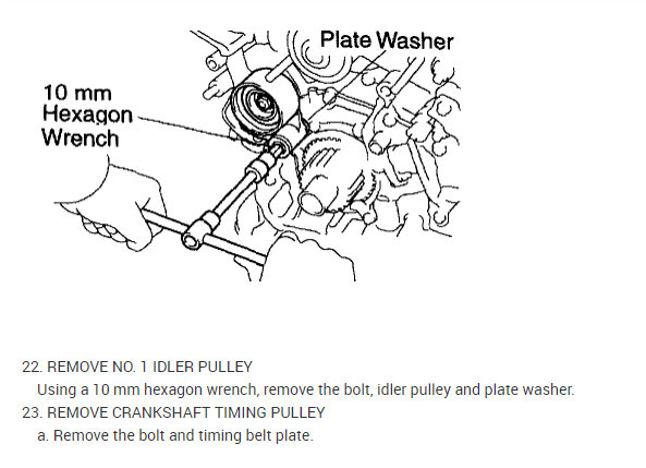

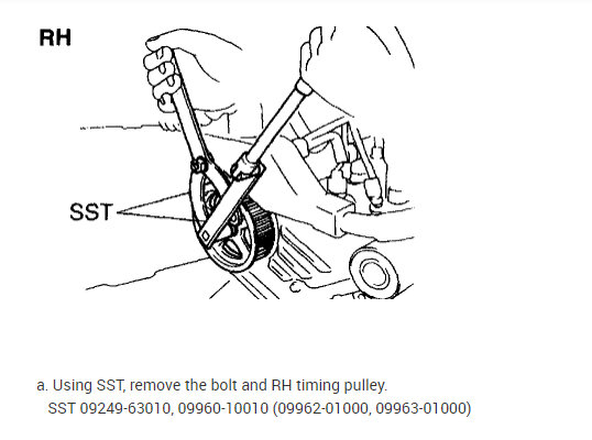

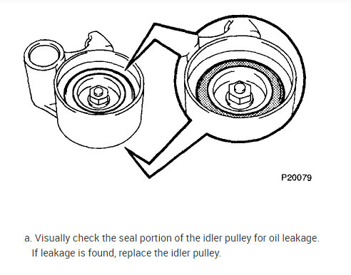

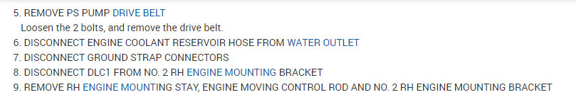

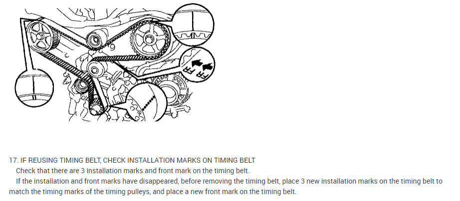

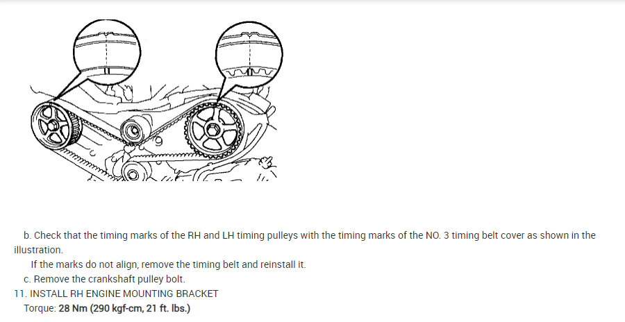

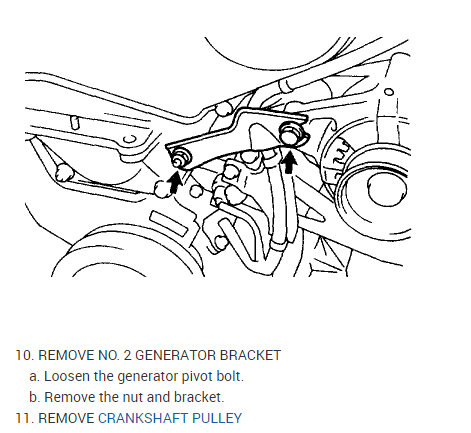

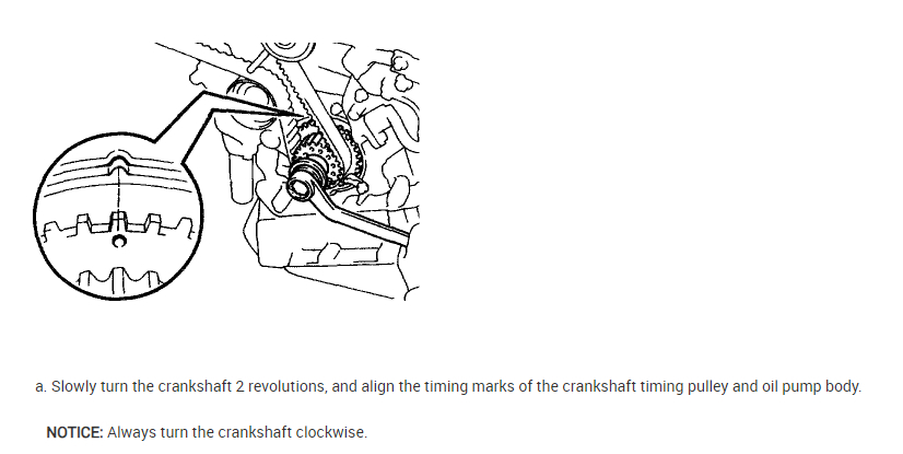

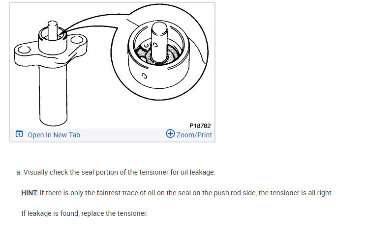

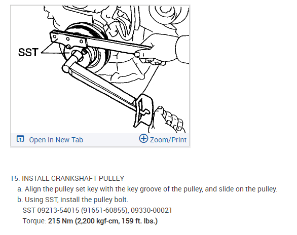

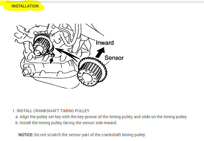

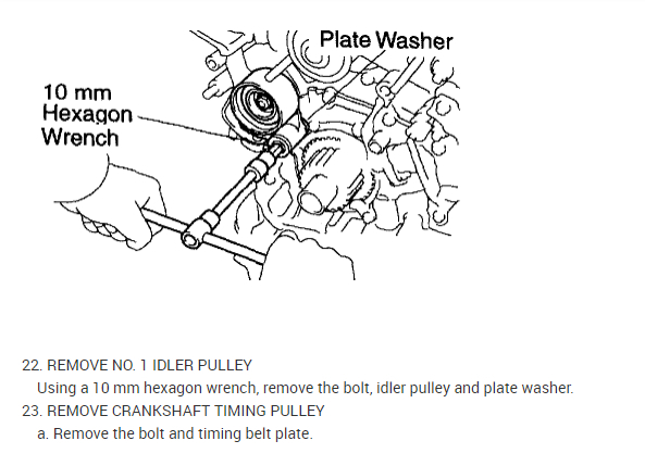

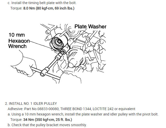

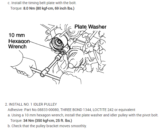

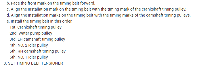

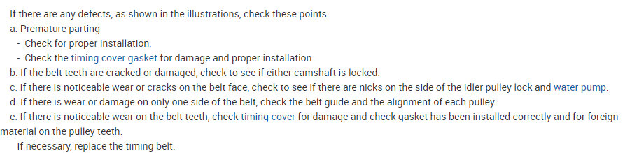

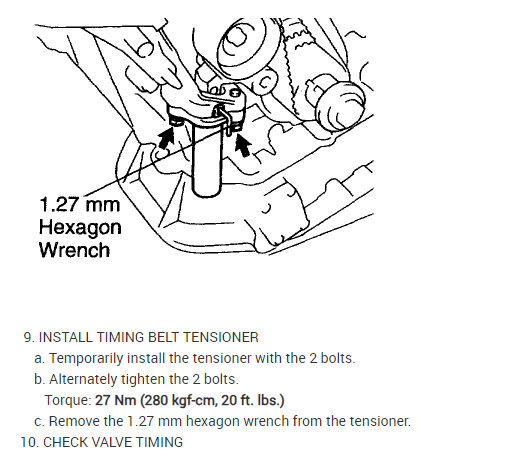

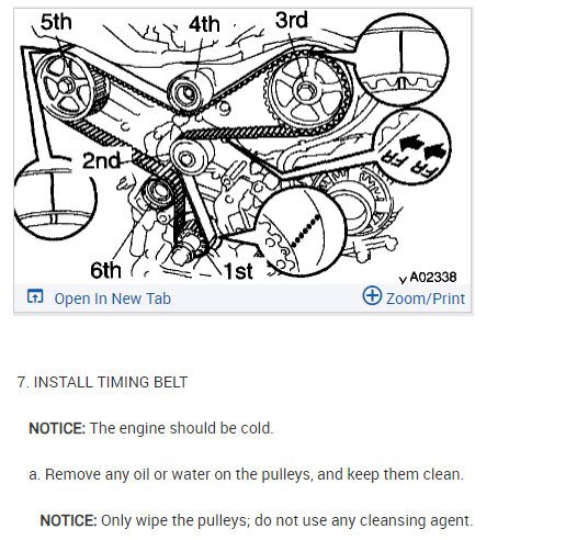

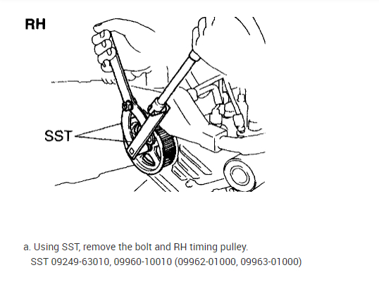

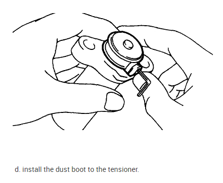

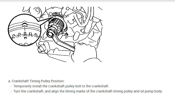

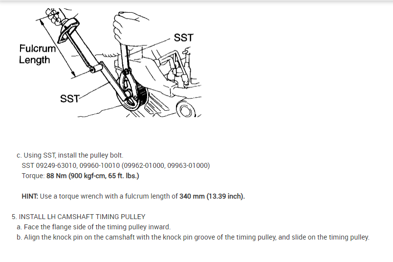

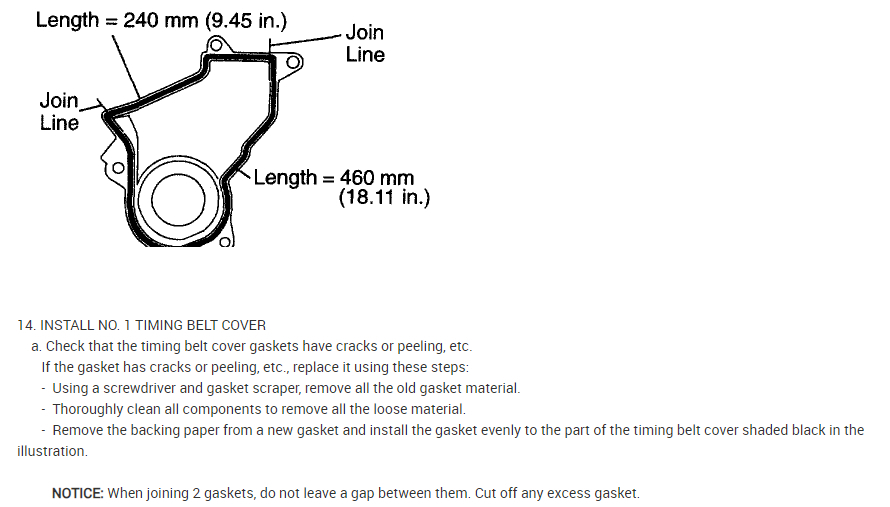

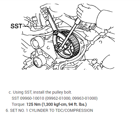

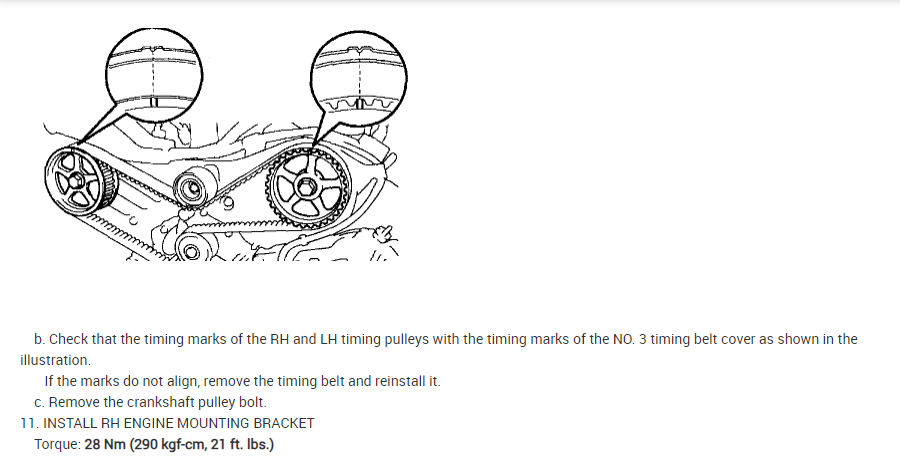

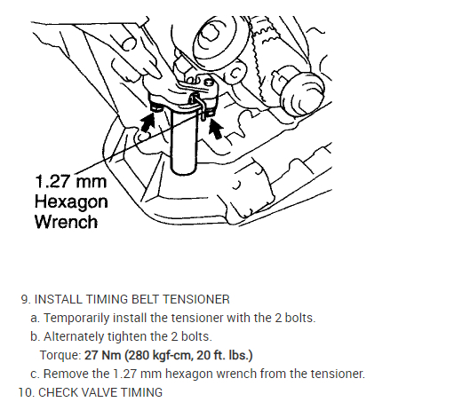

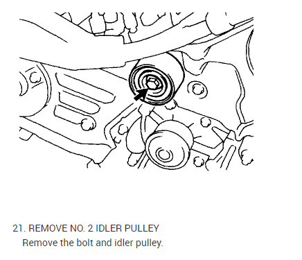

As far as replacement, it is a somewhat difficult job, but you should be able to do it. If you look below, I attached the directions for replacing the timing belt. Once it is off, you can access the water pump, and that part is straight forward.
Take a look through the (many) pics below to see if you are comfortable doing it. I can try to help from here if you have questions.
Let me know your thoughts.
Sep 4, 2024 at 12:59 PM
NOTAPROMIKE2
  • 32 POSTS
Thank you for the instructions and offer to assist. I contacted Toyota dealership yesterday....$950 labor, $850. parts. Talked to a local mechanic with a lifetime of experience...$450.labor. I ordered the parts from A-Premium for $100. Includes Water pump, timing belt, seals, tensioner, etc...Leaning toward hiring it done....If not, your input will be very helpful. Also watched a 30 min. you tube video with same van.
