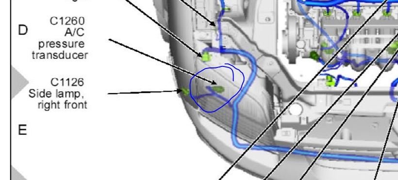

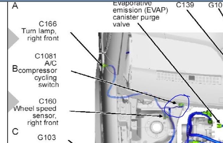

Air conditioner blows cool air out one vent but not cold and warm air out another. where is the pressure sensor located?
Mar 2, 2020 at 4:09 PM
Experienced Mechanic
52,796 POSTS
Good morning,
The pressure sensor is on the dryer in the A/C system.
Can you give me the high and low side pressures of the A/C when it is running?
Let us start with basics.
