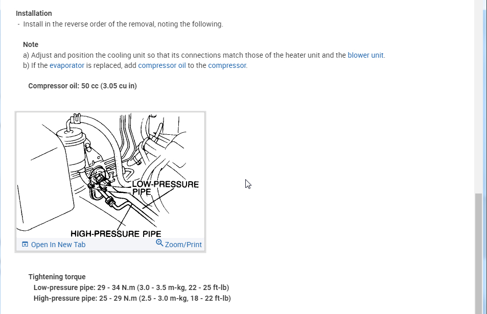

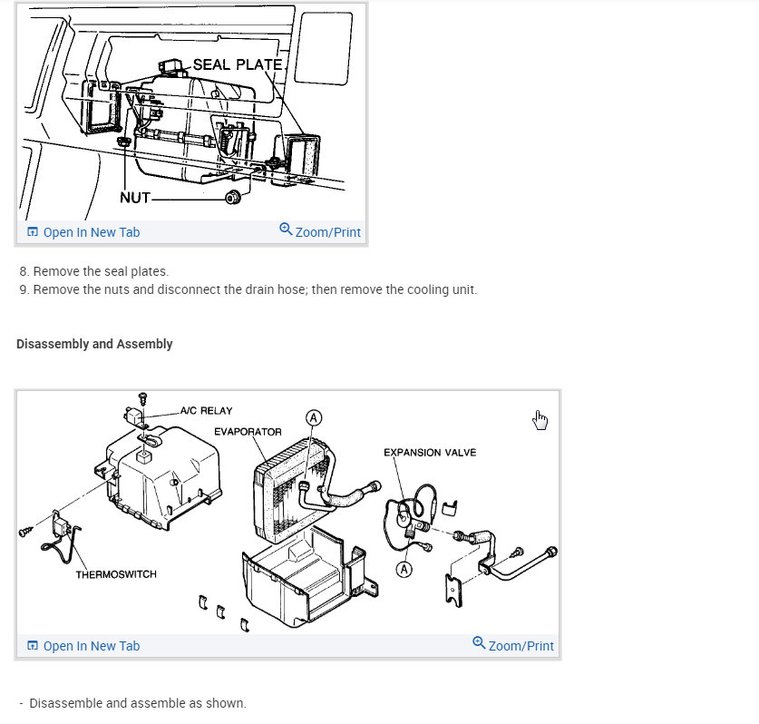

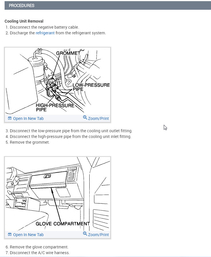

no pressure in system after i tried to get a little Freon in system. i used a leak detector and found a leak in line going to fire wall.
Oct 29, 2019 at 1:17 AM
Thanks for the update. Just make sure you check the evaporator to make sure there are no leaks there either.
