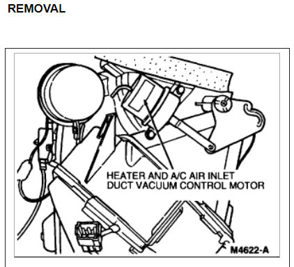

  • 55,583 POSTS
I would take a look at the mode door actuator to see if there is something wrong there here is the location.

  • 5 POSTS
Thank you. Took a look at it. It appears that everything is functioning normally. I even with the extra mile and take a look at the intake lines see if it was clogged and from the fan to all the vents. No clogs. That really leaves me with two options that I can think of now. A resistor is bad or the blower motor is bad. I took the motor out and tested it and i immediately regret that cuz I kicked up all the dirt from a passenger floorboard. Still a puzzle to me.
