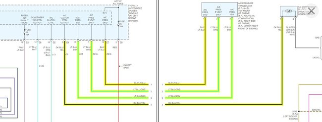

Air blowing hot after compressor is good. right level of Freon in. all blend doors and actuators doors working. what else can i check to see why still blowing hot air?

Can you give me the high and low side pressures while the A/C is on?
Is the compressor engaged when the A/C is on?
I attached a wiring diagram for you to view.

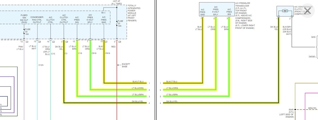

Good afternoon,
