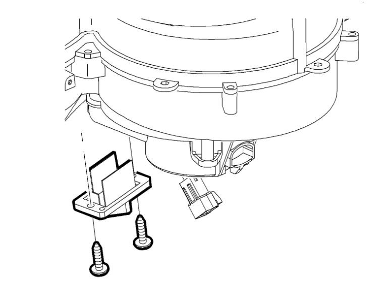

Air does not blow when placed on setting 1, 2 and 3 only 4.
Jul 17, 2018 at 8:42 AM
Good evening.

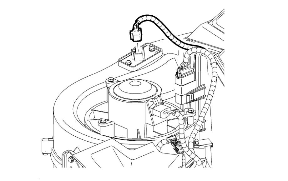

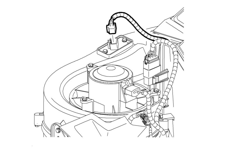

It sounds like the blower resistor is defective. That is what controls the blower speeds.
1. Disconnect the electrical connector from the blower motor resistor.
imageZoom/Print
2. Remove the blower motor resistor screws from the HVAC module.
3. Remove the blower motor resistor from the HVAC module.
