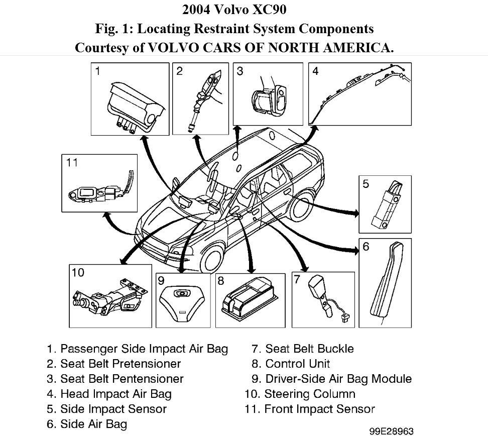

My airbag light stays on i got it diagnose and the deal told me that there an issue with wiring(350 for exact diag). Where do i start if i wanted to verify the wiring myself. which peice of wire might be the culprit? please help.

DTC E0211 is a fault with the front right impact sensor or its wiring circuit. It is the harness from the control unit to the impact sensor.
SRS system is of safety concern and repairs should only be done by trained personnels. Mistakes can be costly and could also result in personal injuries if the airbags are accidentally deployed.

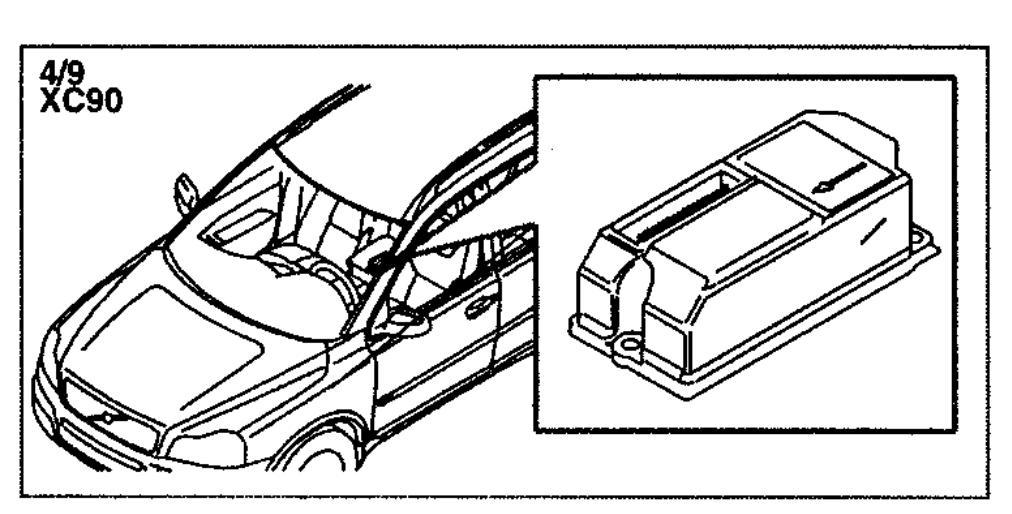

The dealer told me it's not the sensor but the wiring comm is faultiy. the control unit to the impact sensor where in the care is this located. I have an 04 XC90.
May 20, 2013 at 10:18 AM
KHLOW2008
  • 41,814 POSTS
Below floor console, behind gear selector lever.
