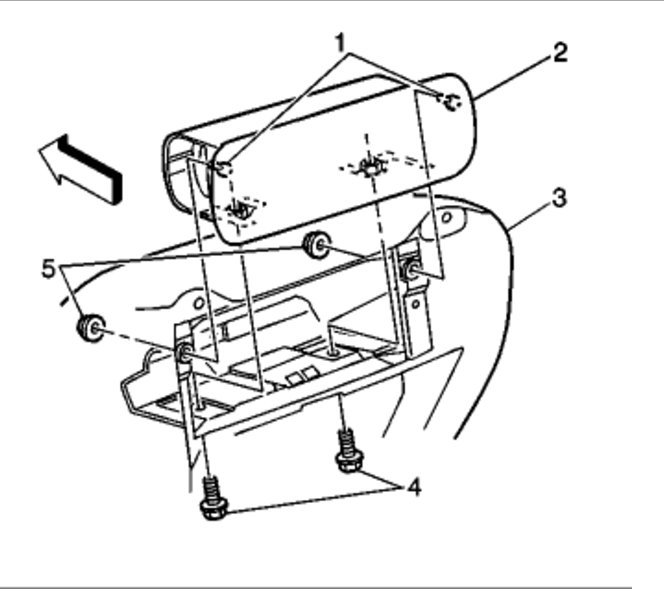

Passenger side airbag was deployed because of a collision. I have rebuilt the front end, but need to know how to remove the passengers side airbag so I can replace it.
Jul 13, 2017 at 10:36 AM
  • 55,433 POSTS
Here is a guide that will give you an idea on what you are in for when doing the job:
https://www.2carpros.com/articles/air-bag-removal-steering-wheel
and here is a diagram (below) on what it will take for your car.
