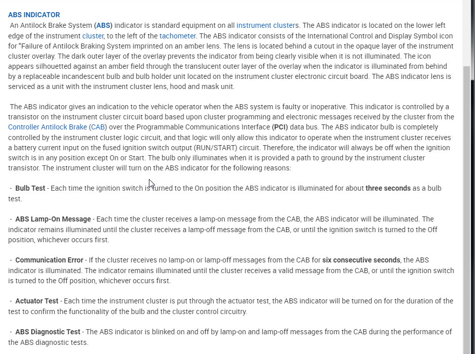

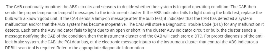

This could be a number of issues. If the light comes on it is best to scan for codes because if the light is on then there will be a code to go along with it. Just make sure the code reader is able to communicate with the ABS or it will return no codes.
Let me know what the codes are and we can go from there. Thanks
