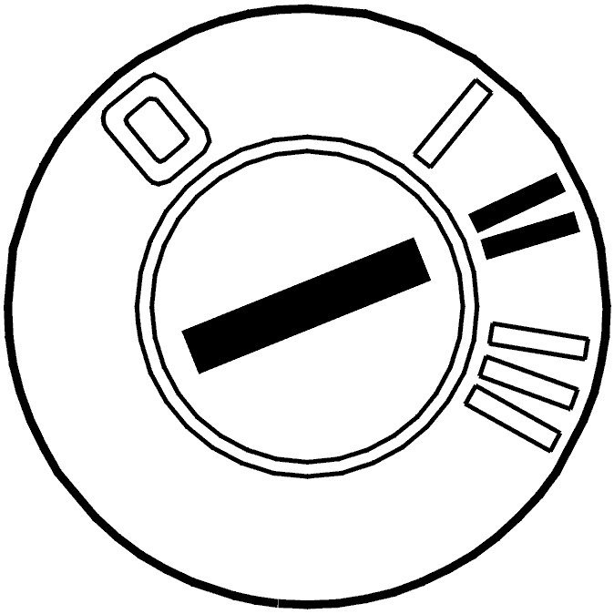

- Ignition off
- Disconnect the battery negative terminal

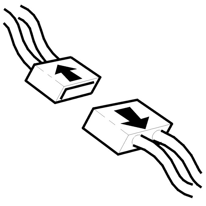

- Disconnect the seat connector
- Check the connector for contact resistance and oxidation. See Checking wiring and terminals. Permanent fault See: Computers and Control Systems > Component Tests and General Diagnostics > Checking Wiring And Terminals. Permanent Fault
- If the seat connector is defective it must be replaced
