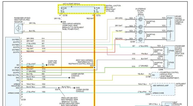

Airbag light is on and has a number 12 code and then it stays on the code says low battery feed. I have change the front end crash sensor, switched out battery, checked all 10 amp fuses and also tried to reset the light and it still come back to a code 12. checked all connections under the seats on the driver side and also good on passenger side good. also the sensor works that senses a passenger is in the seat and the the passenger airbag light goes off telling me the air bag is on. I tried all I know just cannot figure out the problem. is there anyway you could help me out? Surely would appreciate it. thank you
Jul 28, 2019 at 11:01 AM
Good morning,

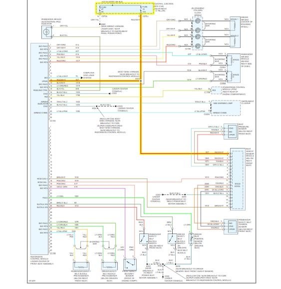

This code has to do with a power feed to the module for the airbag.

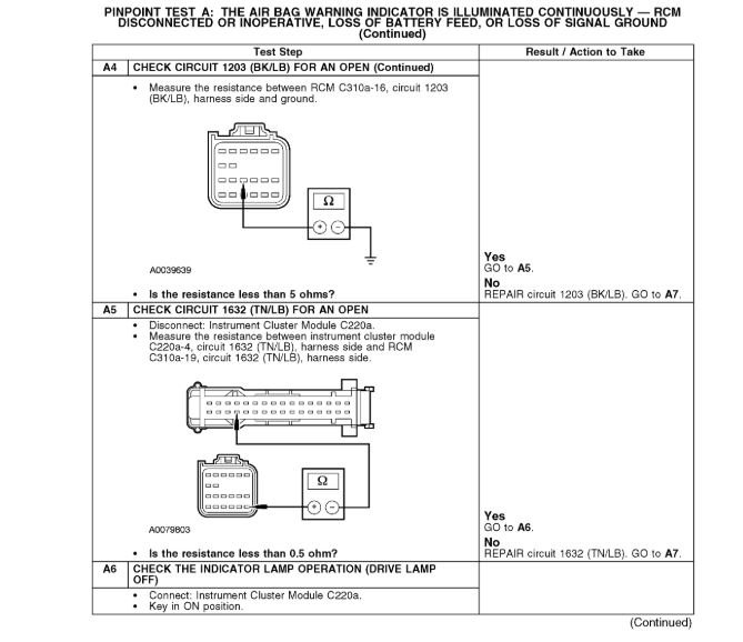

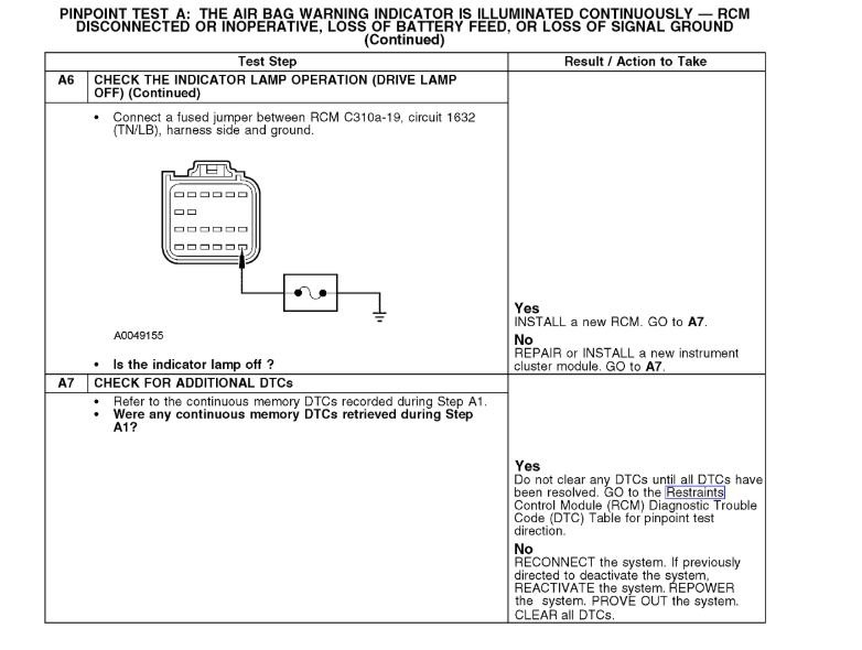

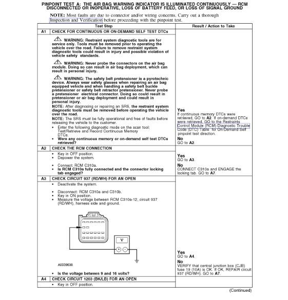

I attached a flow chart and description for the procedure to find the failure.
