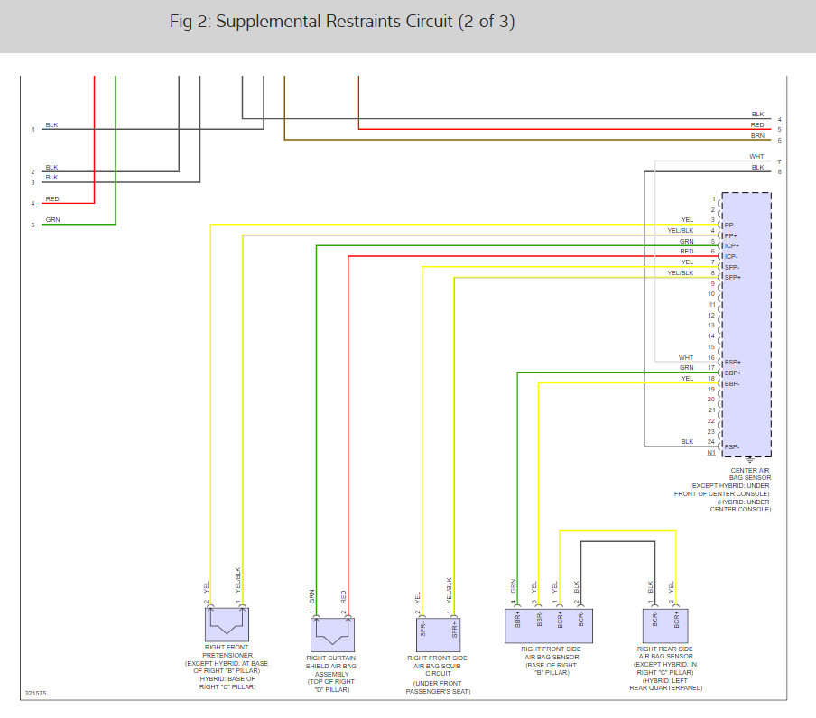

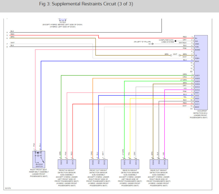

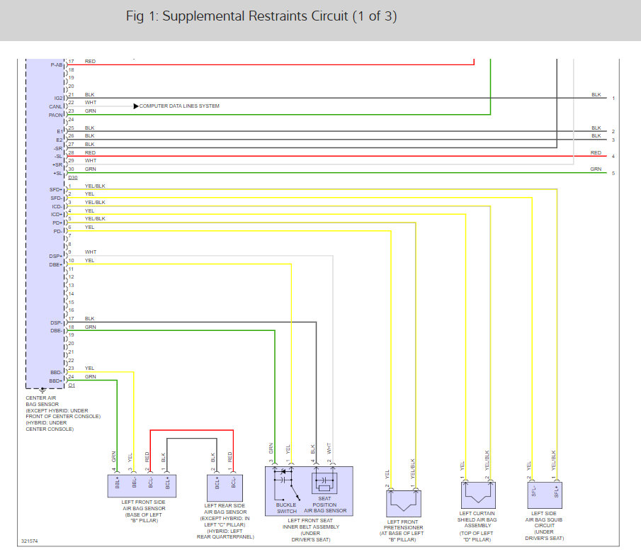

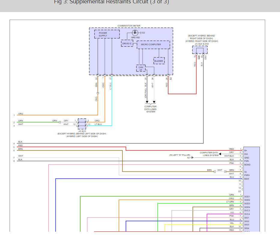

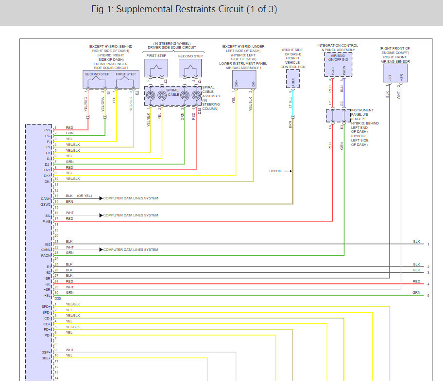

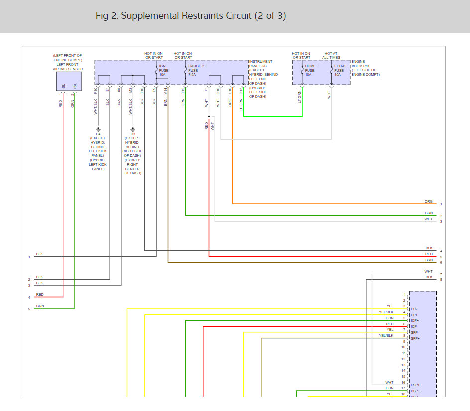

It sounds like the passengers side airbag needs to be connected or he has got the connector on wrong. Here is a video of how to connect the airbag:
https://youtu.be/VflcXgWKhqw
You can test the harness by following this guide and the airbag wiring diagrams below.
It is a real time system so once the connection is fixed the light will go out.
