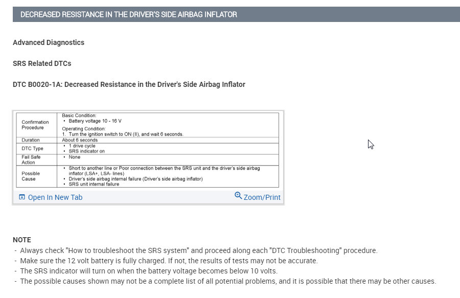

I got it icon on it said it was clock spring. got a new one put it in and light was on. took it to clear with scanner and light went out then came back on. what do you think it is? thanks
Apr 21, 2020 at 8:47 AM
Can you provide the actual code that you are getting? Then we can send the diag for that which will tell us what this is. There are a number of different issues that this could be so we just need to start with the code and go from there. Thanks
Apr 21, 2020 at 9:31 AM
AMBY MACKINNON
Code is B0020-1A.
Apr 21, 2020 at 11:33 AM

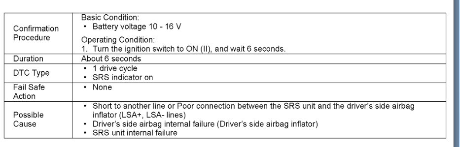

Okay. I attached the info about this code. Basically it is saying that there is a wiring issue from the airbag to the control module or it is one of these components.
Unfortunately we are not provided wiring information or any more detail about these circuits because they don't want just anyone to try to repair this system. Clearly it is a safety system so unless we just want to guess and start replacing components, we need to have it looked at.
