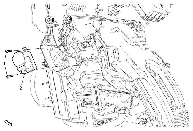

Sometimes my A/C and heat works and sometimes it doesn't, but when it doesn't I still hear the motor working. When it does work the air blows out really good but when it doesn't nothing out of the vents?
Jul 7, 2020 at 7:42 PM
  • CAR REPAIR CONTRIBUTOR
  • 110,190 POSTS

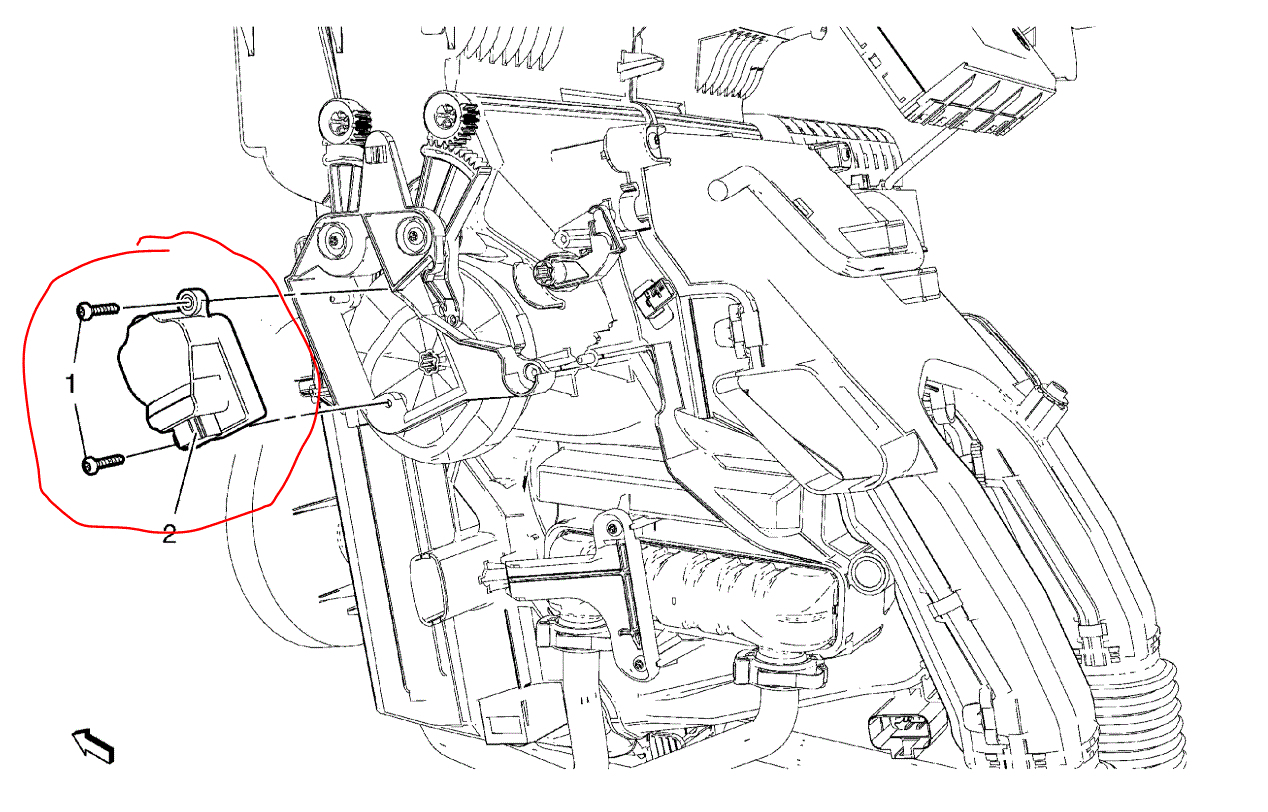

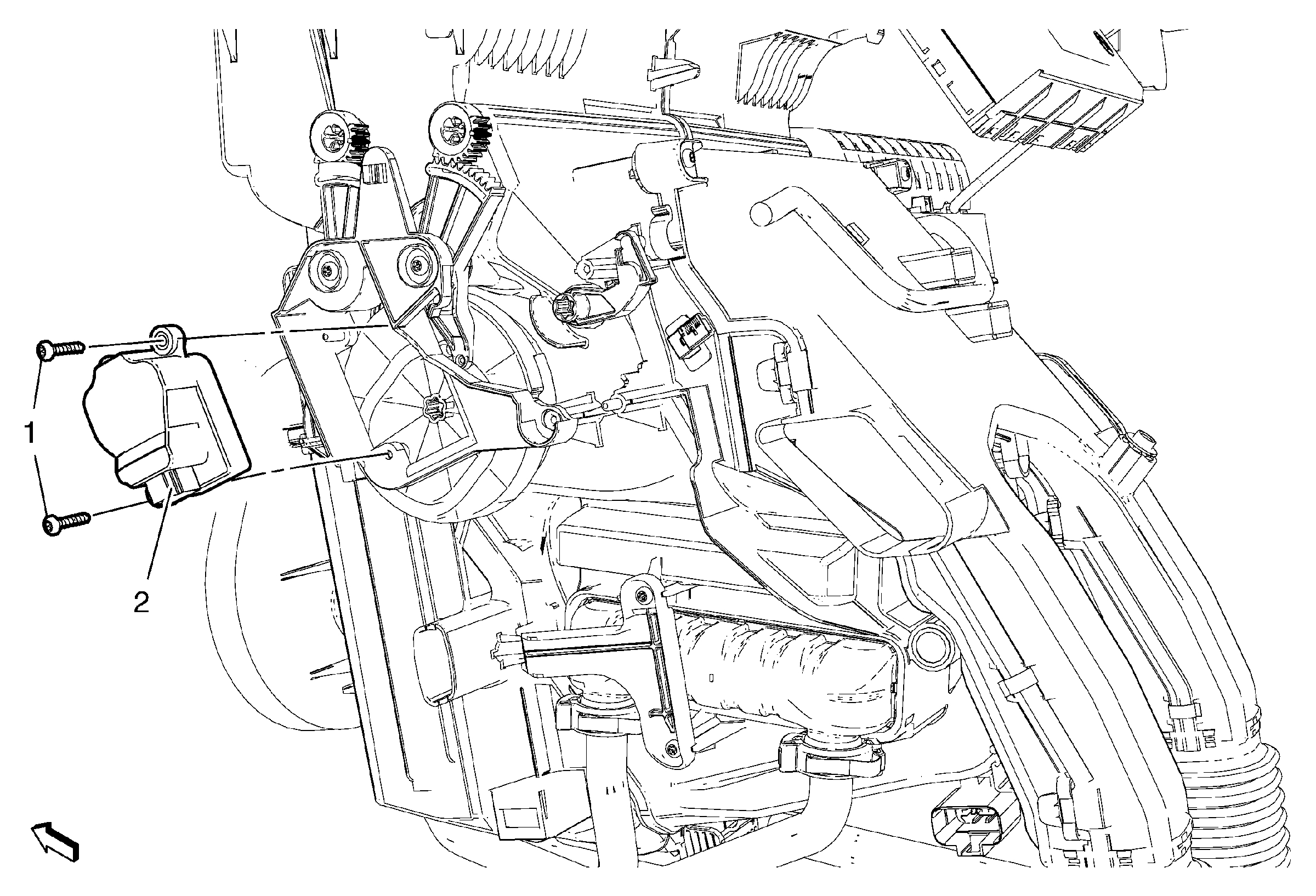

The air flow direction is controlled by a mode control cam actuator. If it is failing, you will lose control of the air flow direction.
I attached a pic of what I am referring below. However, the pic is for manual A/C. I need to know if you have a manual climate control or automatic.
Jul 7, 2020 at 8:07 PM
ROBERT ST
It's automatic.
Jul 8, 2020 at 8:08 AM
  • 110,190 POSTS

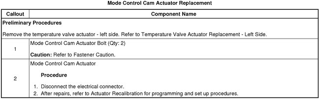

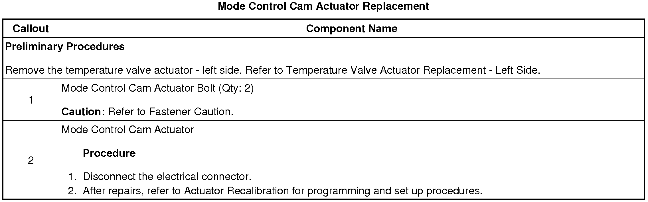

Here are the directions for replacing the part. However, before purchasing one, remove the old one and confirm it isn't working.
The actual directions are in pic 2.
____________________________________
2014 Buick Verano L4-2.4L
Mode Control Cam Actuator Replacement
Vehicle Heating and Air Conditioning Air Door Actuator / Motor Service and Repair Removal and Replacement HVAC - Automatic Mode Control Cam Actuator Replacement
MODE CONTROL CAM ACTUATOR REPLACEMENT
See pic 1
See pic 2
