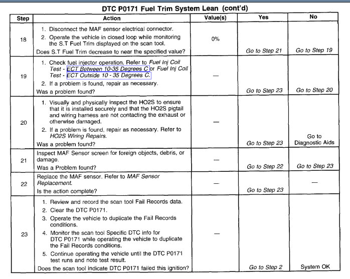

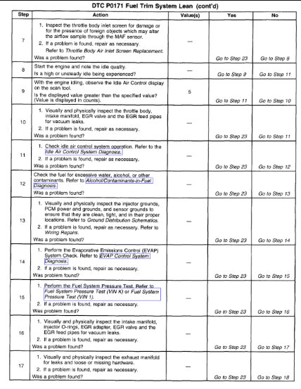

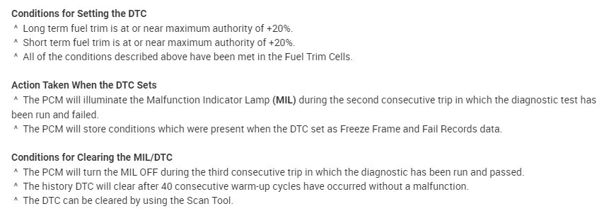

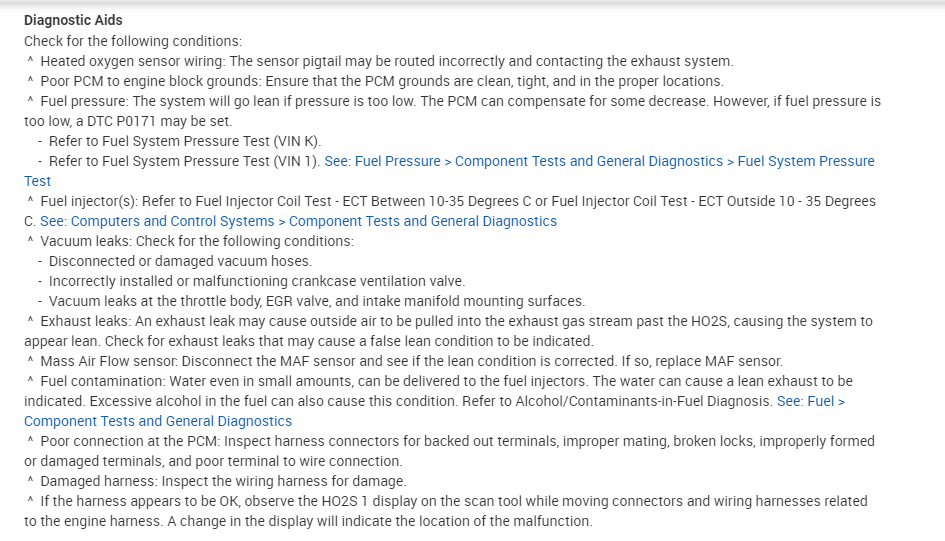

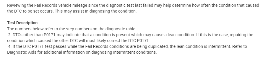

If the check engine light is flashing, that indicates a misfire is occurring. There should now be additional codes. Let me know what they are.
Now, in most cases, a lean mixture is the result of an engine vacuum leak. Have you checked for leaks?
Here is a link that explains how to check for leaks:

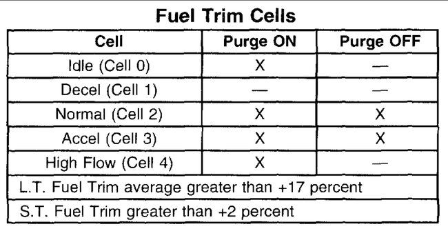

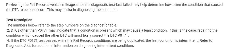

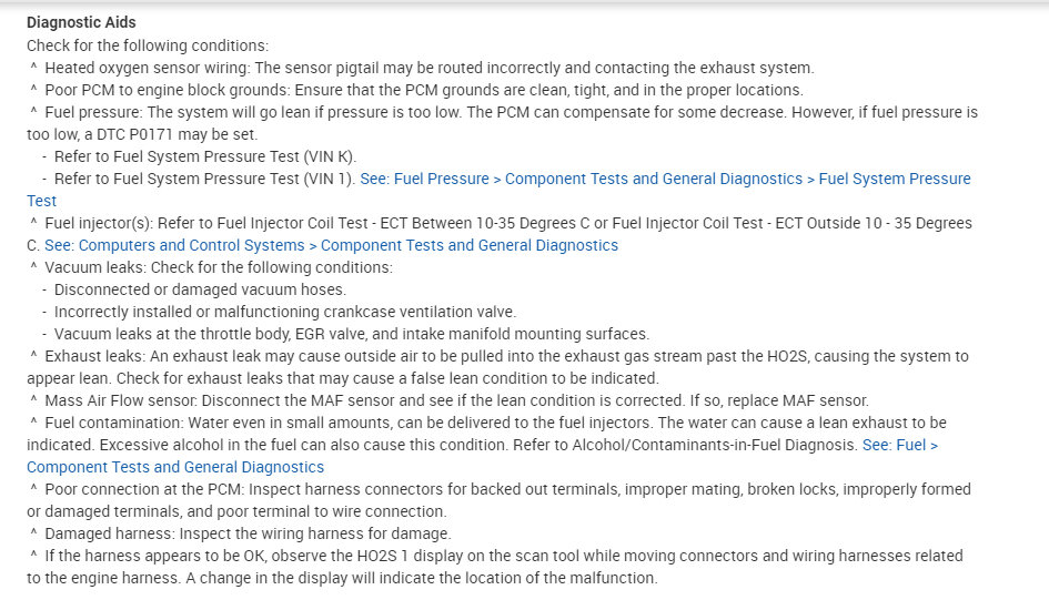

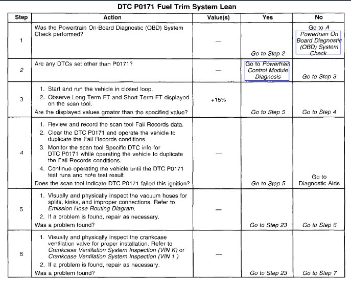

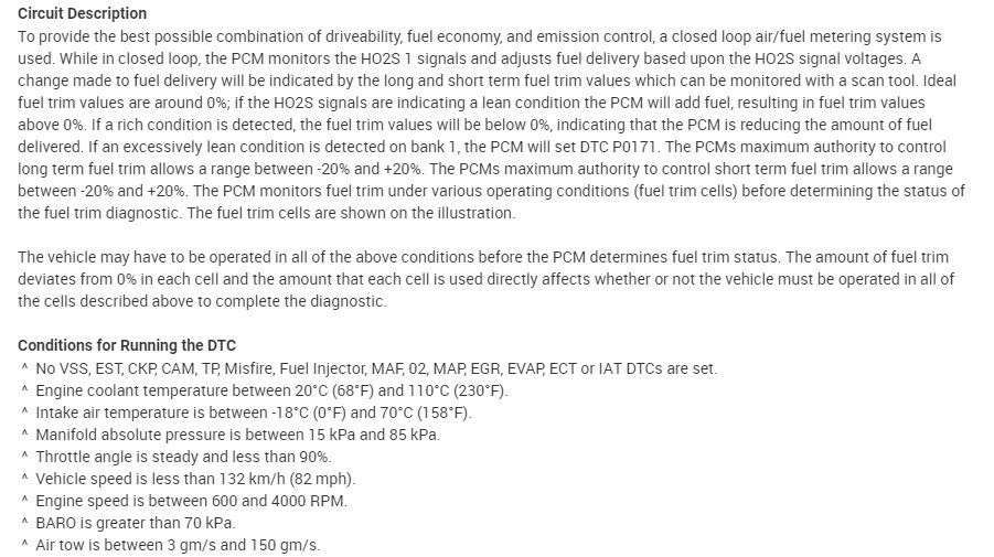

If you look below, I included the diagnostics for the P0171. Take a look through them and let me know if you are comfortable performing them.

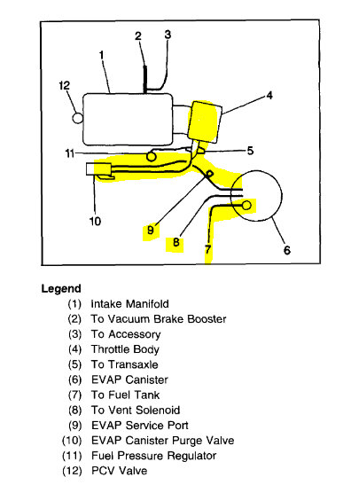

Could my fuel sending unit not being sealed properly cause a vacuum leak?
Oct 30, 2022 at 7:40 AM
  • 110,194 POSTS
If you are referring to the sending unit in the fuel tank, I would say no unless there is a hose off to the EVAP system (charcoal canister.)
If you look below, I attached the vacuum schematic for the evap system. I tried to highlight where vapors go, which wasn't simple because my highlighter is too big. LOL
Anyway, that is about the only thing that I could think could happen if there was a problem in that area.
See pic below.
