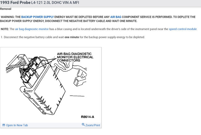

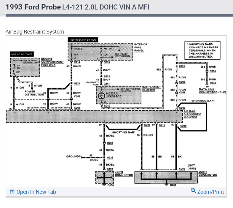

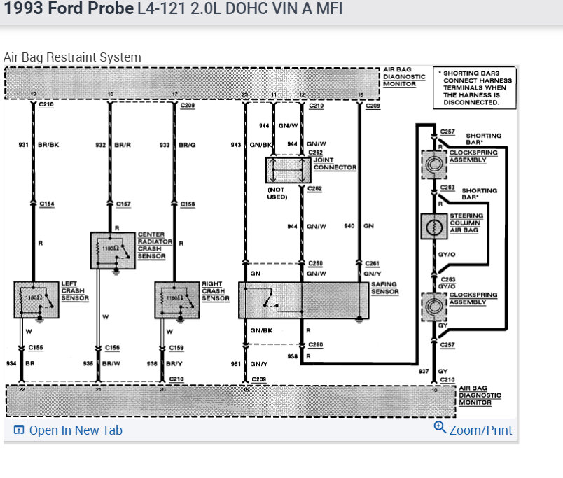

Usually, the clock spring goes out causing this problem. Here is a guide to help you test the wiring to confirm the issue and I have included the airbag system wiring diagrams so you can see which wires to test and how the system works.
Check out the images (below). Please let us know how it goes

Hmm, there are 4 grounds at the airbag monitor let's use this guide to see if they are working:
Check out the images (below). Please let us know how it goes.

Okay, I checked all the grounds on the Air Module. I checked all the voltages. All are correct except 11 and 12 which show no voltage. 11 and 12 are connected and are not shorted to ground. By removing the airbag the crash sensors are removed from the circuit. Those each tested ~1100 ohms. Where does pin 11 get its voltage?

When I check the wiring diagrams above pin 11 is not used?

"If the diagnostic Monitor measures a voltage of 2 volts or less at pin 11, the monitor will flash a code 13 to indicate a possible ground on the circuit" section 01-20B-22 of the 1993 Probe service manual. Also if you check your schematic, you will note that pin 11 is tied to pin 12 and through the safing sensor to the clock spring and airbag. This is all circuit 944 which fires the airbag. It normally has a small voltage.

My bad, good call, the pins are tied to one another. It sounds like the airbag diagnostic monitor is back feeding the module. I would check all power and ground sources for the system using the wiring diagrams above. Can I ask if the airbag light comes on?

I would check all wiring to see if anything is connecting to ground that should not be, please use this guide and the wiring diagrams above. Also, recheck power and grounds, I am wondering if the airbag itself has shorted as well. I would disconnected all parts of the system to test while not connected. Disconnected the battery.
Please go over this guide and get back to us.
