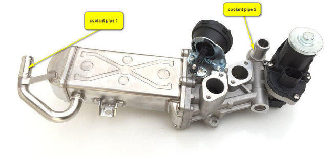

I would like to change the AGR Kühler (EGR Valve) on my car, could you send me a step by step diagram as always, how should I do it?

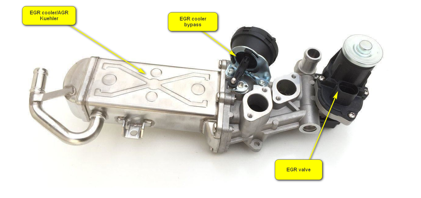

The EGR cooler (AGR Kühler) and the EGR valve are combined in 1 component. See image 1below.
It takes about 6 hours to replace the component.
The component is located at the rear of the engine, underneath the turbo.
Easiest accessed from underneath.

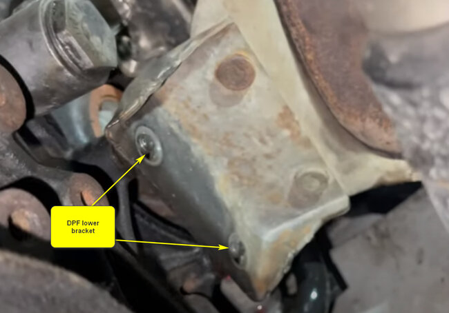

Loosen the securing bracket for the DPF and securing bolt on the other side so that it can be moved out of the way. See image 2 showing the lower bracket, held on with 2 nuts.
Before moving DPF ensure to loosen the wiring behind the oxygen sensor.
Under the vehicle remove the right front wheel and inner fender liner.
Loosen the DPF lower bracket.

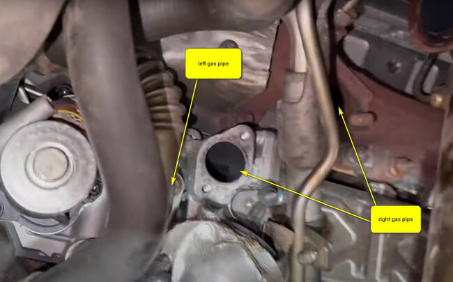

You can also access the coolant pipe to the EGR cooler, near DPF.
Remove pipe, ensure that you catch any coolant spill.
Remove the 2nd coolant pipe on the other side of the EGR cooler.
See image 3.

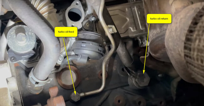

Remove banjo bolts for turbocharger oil return and feed pipes.
See image 4.

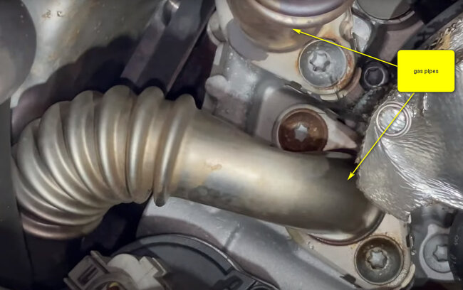

Loose and remove the right gas pipe from EGR cooler and exhaust manifold.
The left gas pipe is easiest accessed from the top by removing the intake air pipe.
See image 5+6.
Remove the oil return pipe for the turbo.
The oil feed pipe (thinner pipe) is best left attached to the turbocharger.
Loosen the 4 T30 torx bolts holding the EGR cooler and remove the component.
