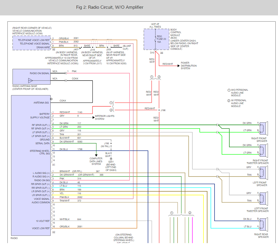

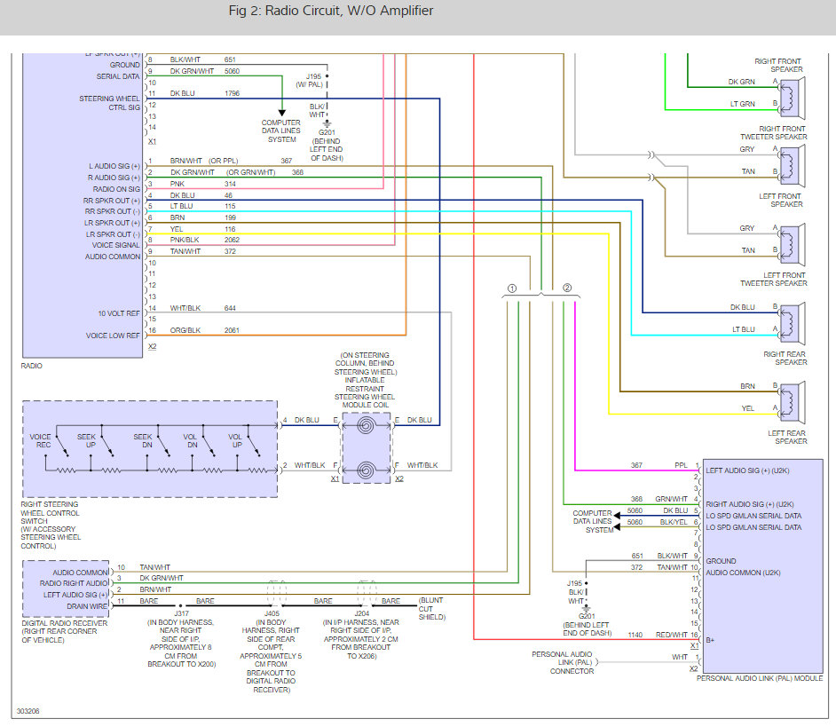

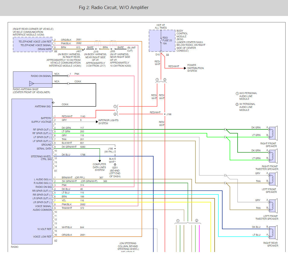

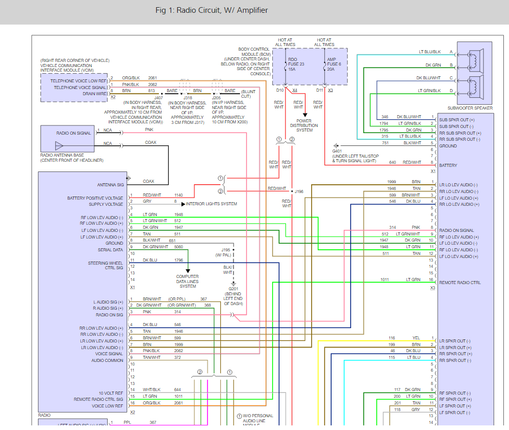

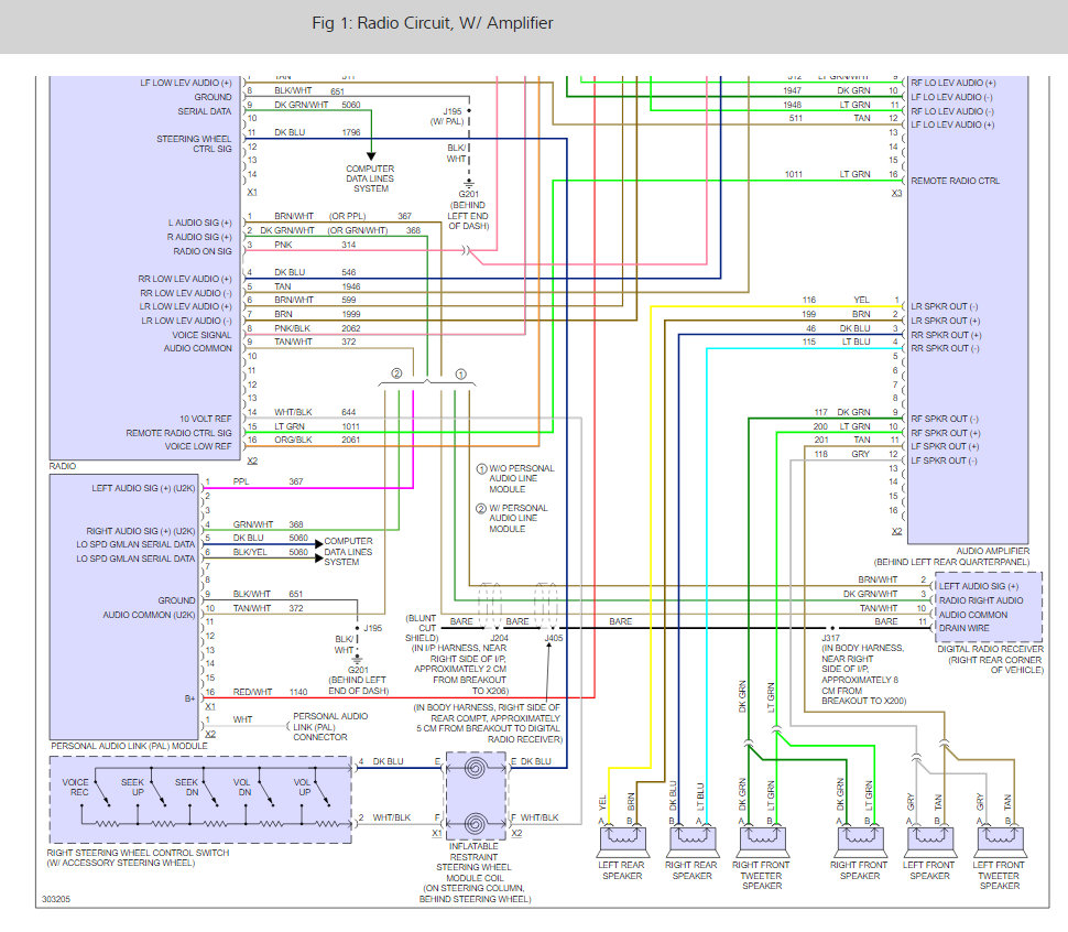

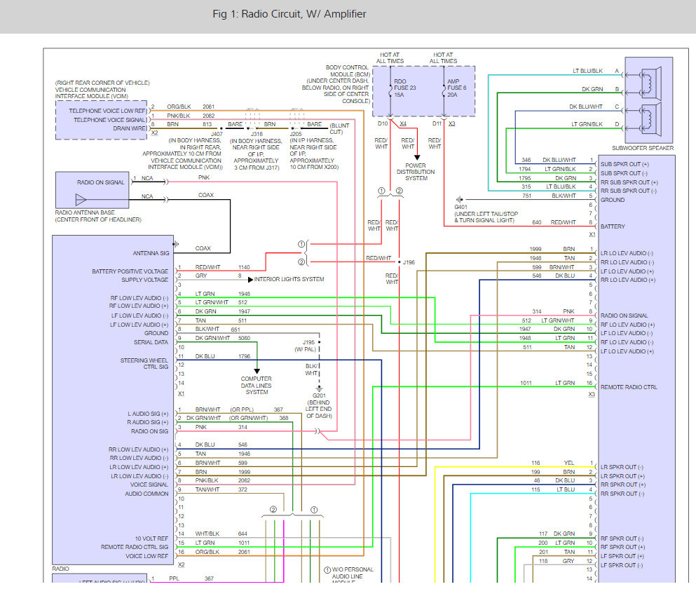

So i installed an aftermarket stereo a week or so ago and installed a sub because i did not want the package at the time and i installed a double din with a wiring harness and ran a remote wire to the back along with the RCA cables. i just realized now that my front right and rear left speakers are not working and because i did not notice before is because i have six speakers four large and two small ones on the top side of the door. i cannot seem to figure out the issue. if you need more information just ask.
Jul 24, 2017 at 9:29 AM
  • 55,221 POSTS
You must not have it hooked up, here is a wiring diagrams so you can connect the right wires.
