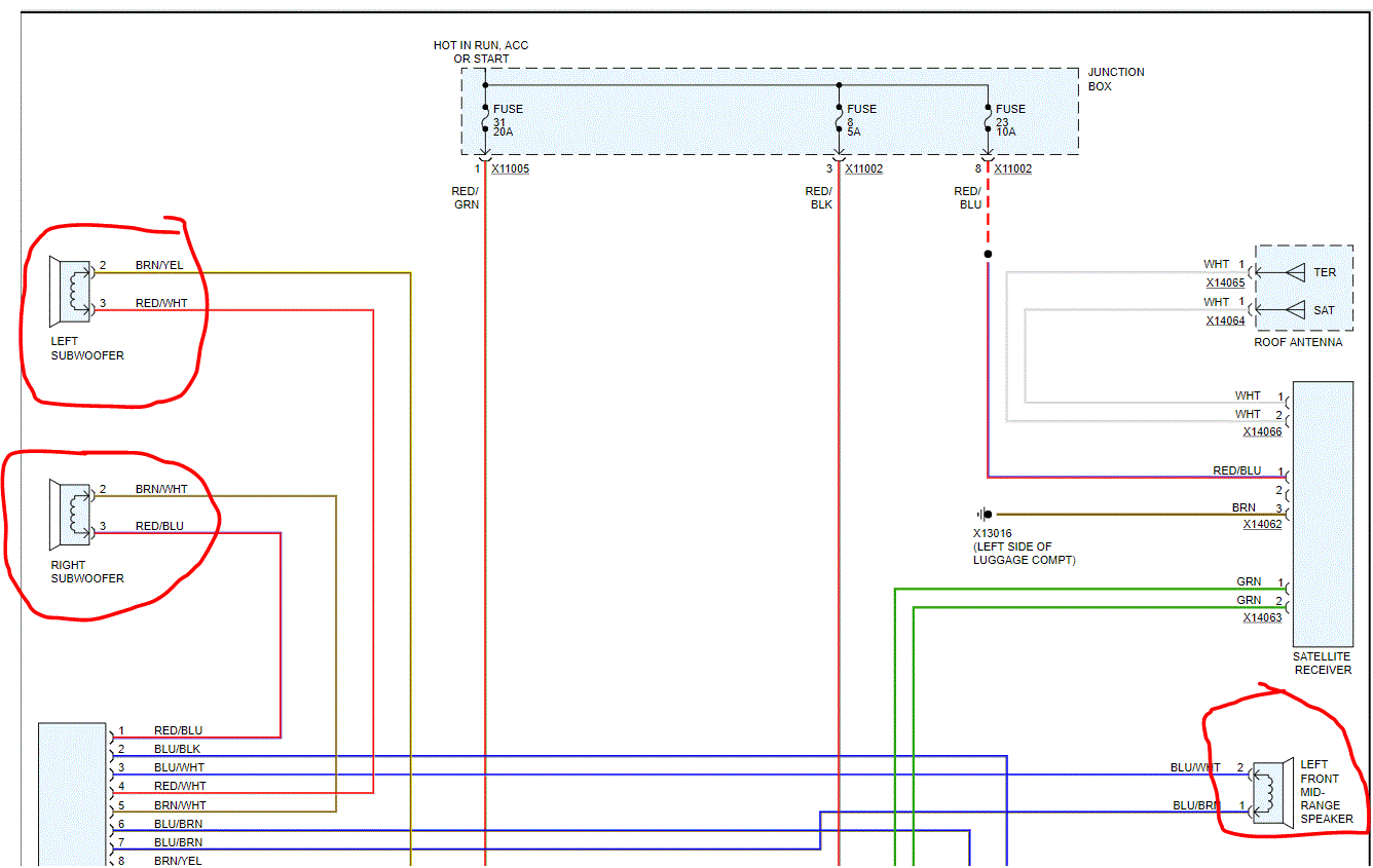

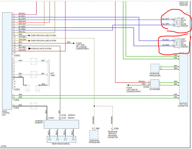

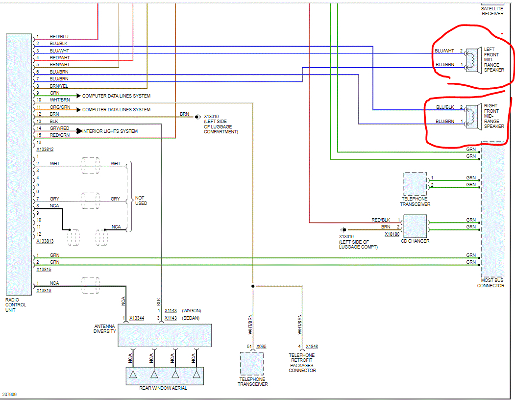

I’m switching out my radio. I have everything connected and the new radio powers on but no sound comes out. What do I do or maybe I have the wiring wrong.
Mar 4, 2021 at 5:40 PM
  • 110,240 POSTS
I attached a copy of the wiring schematic for the base radio on this vehicle. I had to cut the schematic in two to make it readable.
If you look at the pics, I circled each speaker. The wire color for each speaker is indicated in the schematic. Make sure you are connecting the new radio's output to the correct wires.
