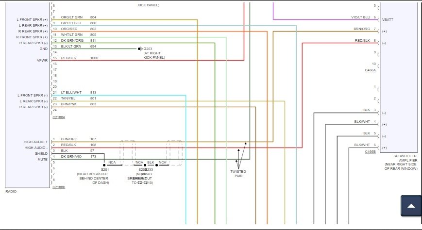

I have the vehicle listed above Adrenalin with a stock Pioneer head unit. It has the 6 disk CD changer and factory amplifier and sub-woofer. I’m connecting an aftermarket radio to it and trying to retain amp and sub. The wire harness kit I received has correct pins for main harness but I have a secondary 5 wire connector adapter for the amp and sub that is not correct for my Adrenalin. The connector adapter itself fits but the pin layout is incorrect and amp and sub is not working. I can’t find the correct wire diagram for my truck for those 5 wires. Every diagram I find has 4 wires and wire colors are incorrect. I’m hoping to find the correct diagram so I can re-pin the adapter I purchased.
May 3, 2020 at 8:41 AM
CJ MEDEVAC
  • 11,004 POSTS

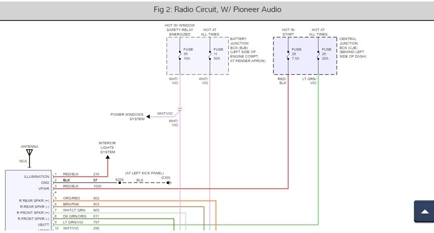

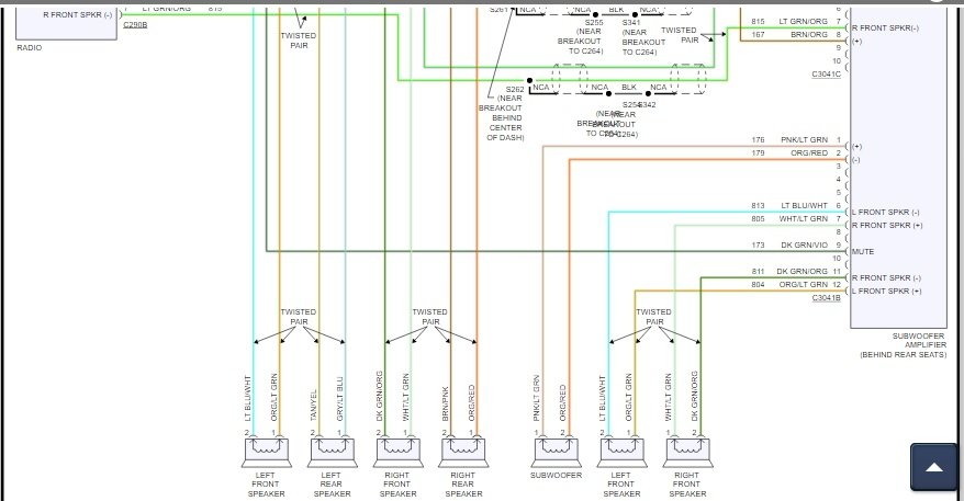

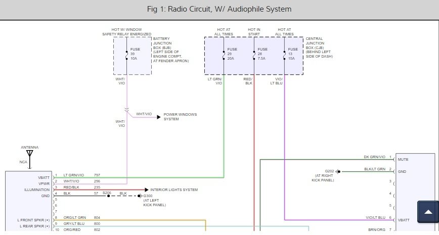

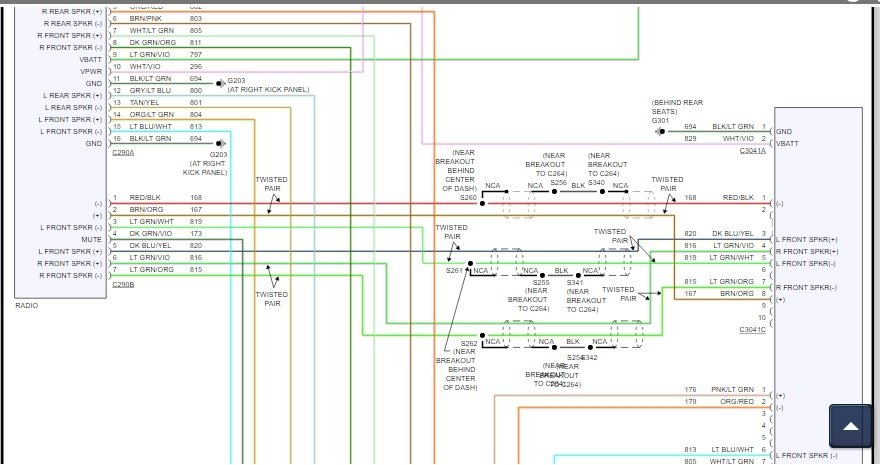

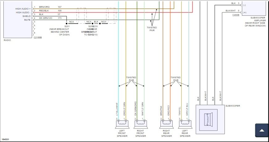

I had to screenshot these from "Prodemand"
2 diagrams.
3 shots for each one.
I think I have them overlapping!
Let me know if this helps.

No, I appreciate it but the 5 wires going to the amp and sub connector from the head unit are black, green, green and black, black and yellow, and red and blue. I can’t find a diagram for it anywhere.
