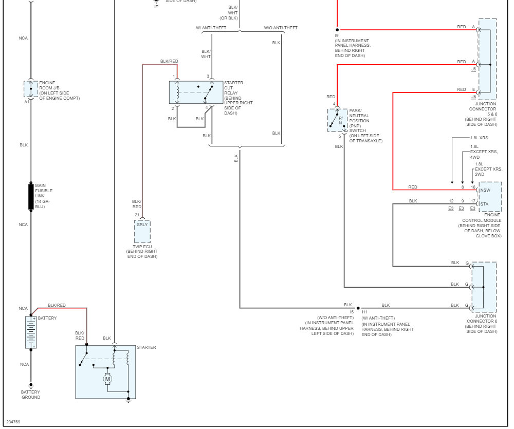

Hi, I bought a car at auction. I was given 2 keys. I never had a problem starting the car before. Neither key has a key fob on it. There are no old remotes on it whatsoever, just the keys. Apparently, the security push button Ignition was installed after the fact by the previous owner. I don't believe it's Toyota period, nonetheless, I can't get the car to start. Change the battery all powers a go. Security light will not stop flashing and the car will not start; can you help please?
Sep 12, 2023 at 3:29 AM
  • 55,433 POSTS

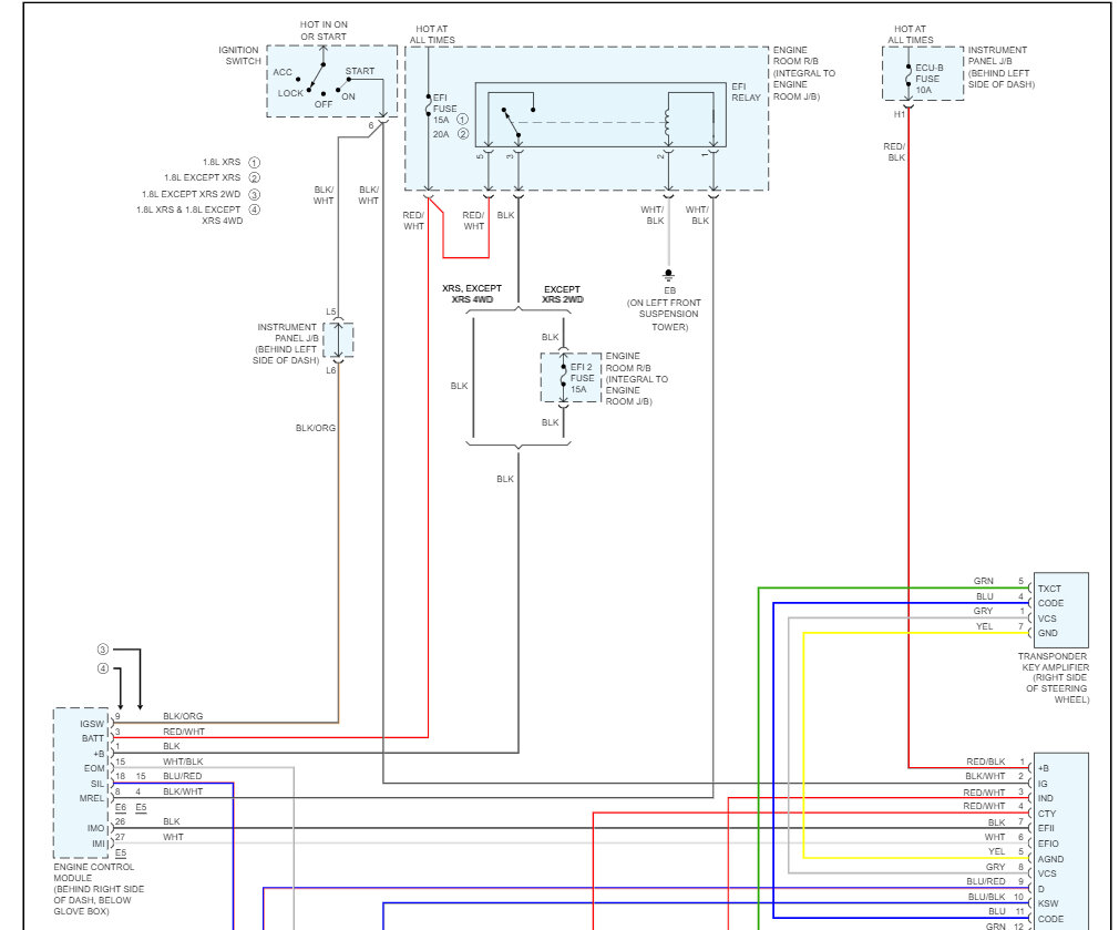

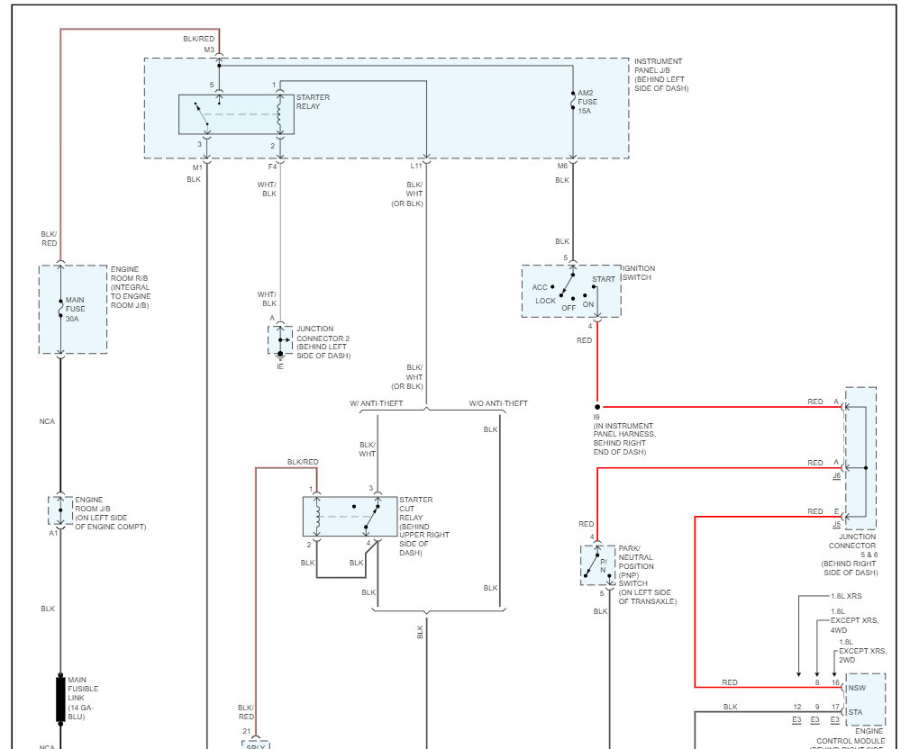

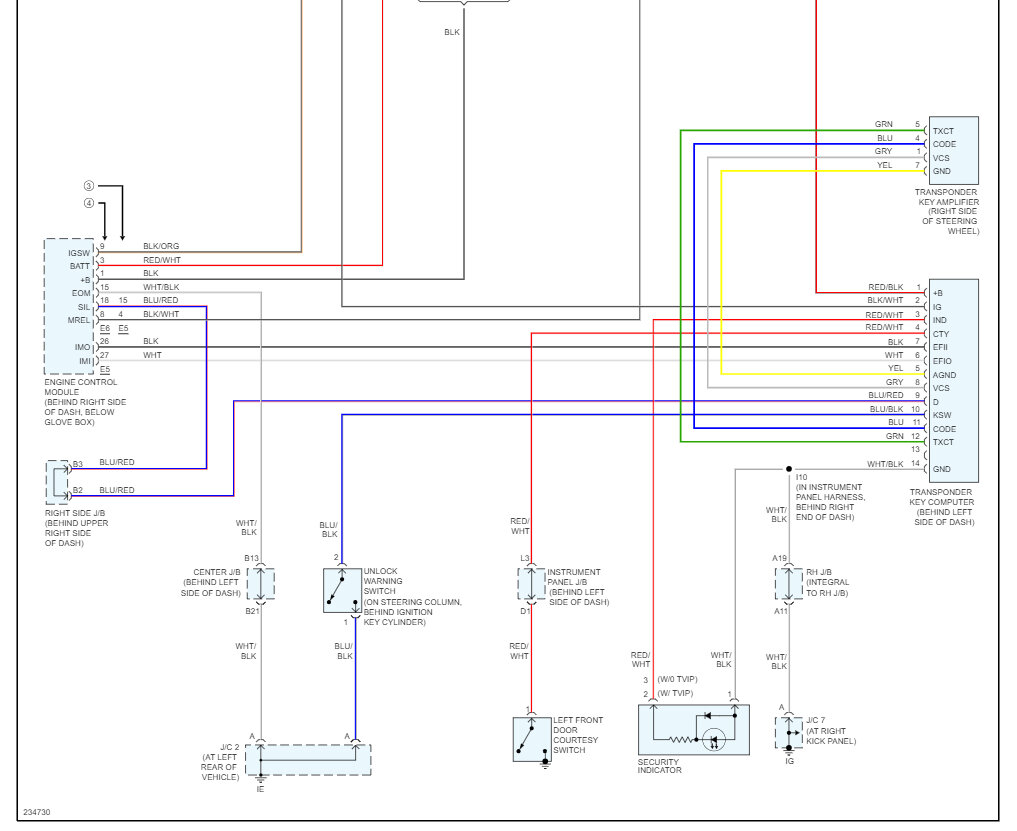

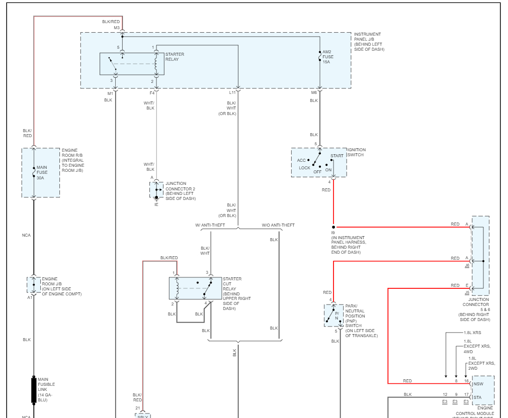

The first thing I would do is remove the aftermarket security system. Here are the wiring diagrams so you can see how the system works. Next, I would do a hard reboot of the electrical system.
