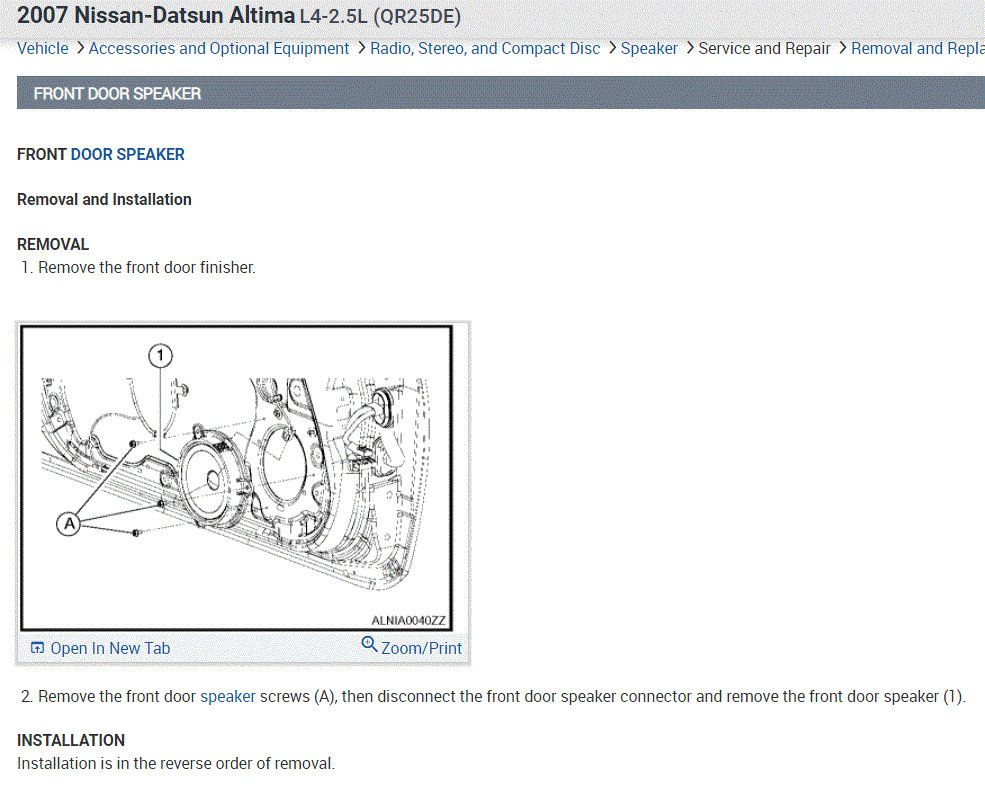

The pic below shows the replacement directions specific to this vehicle. Take a look through them and let me know if you have questions.
See pic below

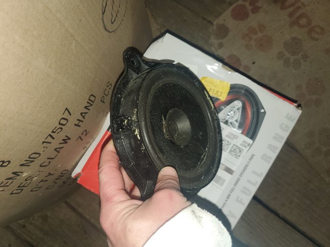

Yes, the speakers are the same size. i assumed you had to get an adapter because the old speakers are already connected to an adapter.

Are you able to reuse the original adapters? That should take care of the problem unless the new speakers are thicker.
