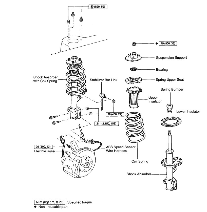

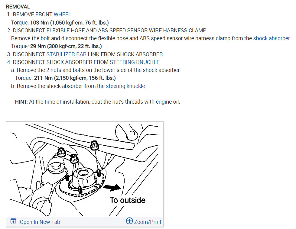

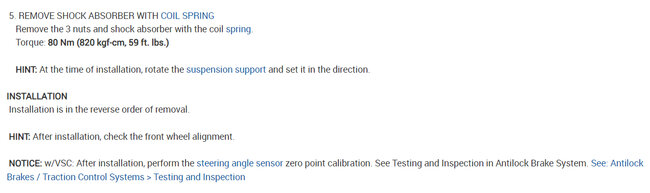

Yep, it sounds like the steering rack needs to be replaced or you have a strut bearing plate that is locked up. I would raise the front of the car and try steering it to see if there is an improvement, if not I would suspect the rack and if so, I would replace the front struts as a unit not just the shock absorber part. Here is a set for $150.00:
https://amzn.to/4dwPwAZ
Here is how to replace the struts. You may need to get the car aligned once the repair is completed. Check out the images (below). Please upload pictures or videos in your response of any problems so we can see what to help you with.
