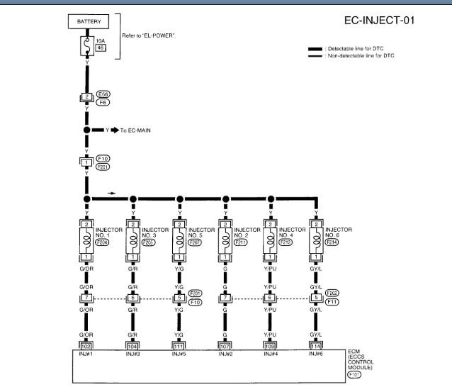

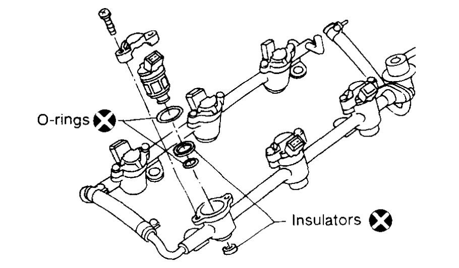

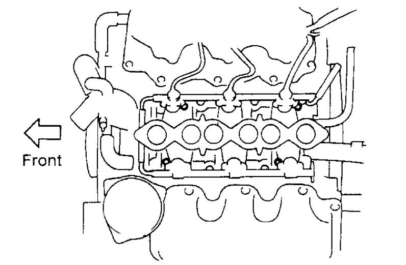

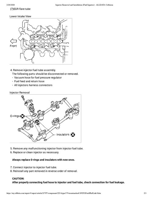

Sir, will remove the fuel injector and clean. we replaced the injector back, the car that is starting before now refuses to start. sir, what can be the problem?

Hey KUJORE,
Would it start before injector cleaning?
Does it crank but not fire at all or does it try to start?
Can you please check for fault codes and report back?
Guide to checking for fault codes below:
Please let us know what codes you have stored.

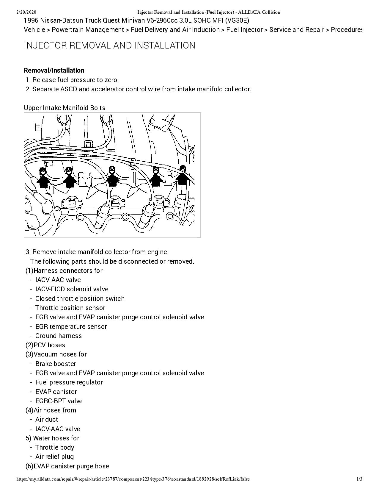

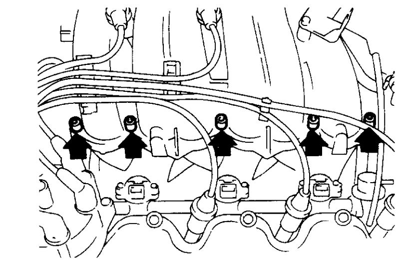

I would advise rechecking all of the plug connections that you disconnected during the injector repair.
Did you replace the gasket for the upper intake?
I would advise if you cannot find anything obvious also check all the fuses in the under hood and interior fuse panel. Guide to checking fuses below:

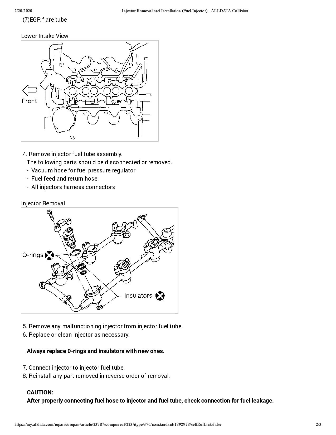

I have attached instructions for replacing injector so you have a list of items to recheck.
Regards, Joe
