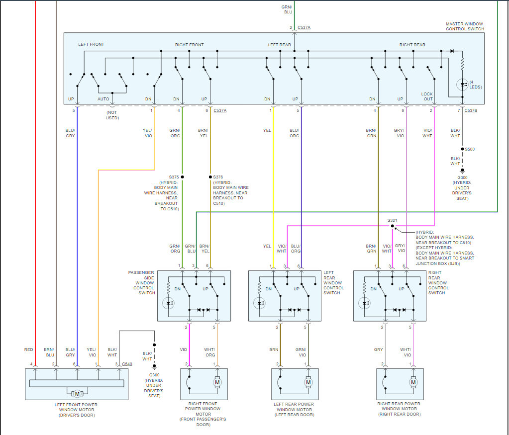

Passenger side interior handle cracked. Removed and replaced the handle.
The passenger side power window switch will run the passenger's window up and down. The driver's side power window switch for the passenger window, only works down, will not run it up. The driver's side switches work okay on the other 3 windows.
Any suggestions for troubleshooting and repair? Should I do a Power Window Reset procedure or is it a wire harness issue?

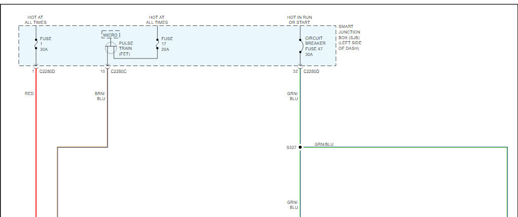

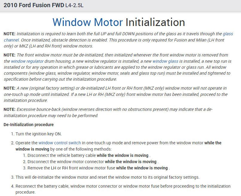

This could be due to a wiring issue. However it will probably be a good idea to do the relearn process and see it that takes care of it.
I have attached the window motor reset and wiring schematics for your reference.

Thank you. I'l give the reset process a try first. I can do that without opening the door panel.
