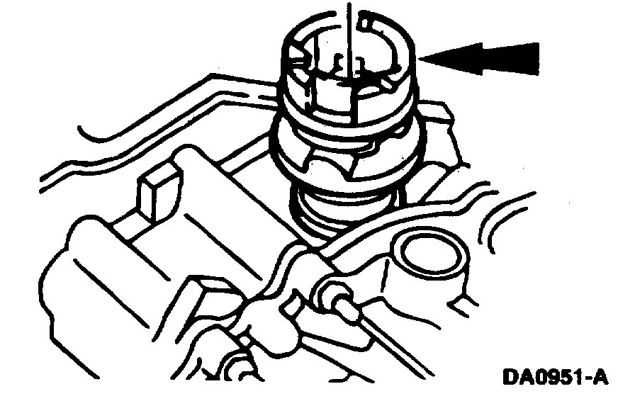

After replacing camshaft synchronize still have code P0340
2002 FORD F-150
140,000 MILES • 4.2L • 6 CYL • 2WD
CHRIS BULLARD

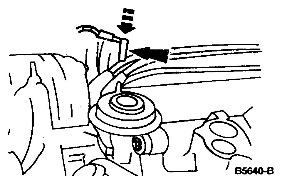

I was getting the P0340 code so I replaced the camshaft sensor and synchronizer. But I'm still getting codes. What might be the issue that is causing this? Also it has a miss or smothers like going down the road.

I suspect the sensor and synchronizer may not have been timed correctly. I am going to provide the directions for the synchronizer install. Check through them to see if you did it correctly.
2002 Ford Truck F 150 2WD Pickup V6-4.2L VIN 2
Camshaft Synchronizer
Vehicle Powertrain Management Sensors and Switches - Powertrain Management Sensors and Switches - Computers and Control Systems Camshaft Position Sensor Service and Repair Procedures Camshaft Synchronizer
CAMSHAFT SYNCHRONIZER
NOTE: Ford does not provide a TDC (Top Dead Center) mark or determination procedure for this engine in this vehicle.
ALLDATA users have reported success using aftermarket tools to determine TDC on this engine.
Alignment Gauge, Synchronizer
pic 1

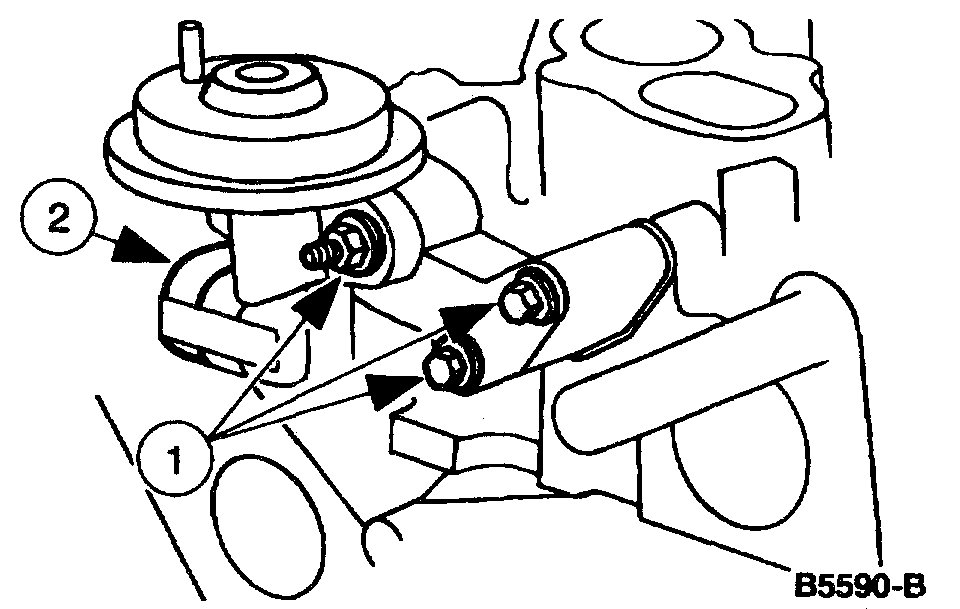

2. Remove the camshaft position (CMP) sensor.
pic 2

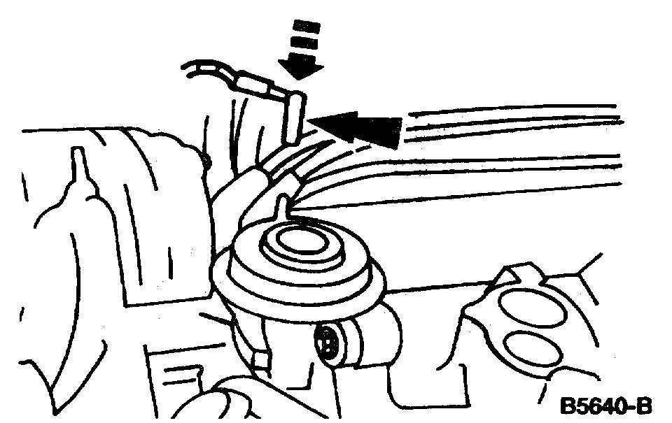

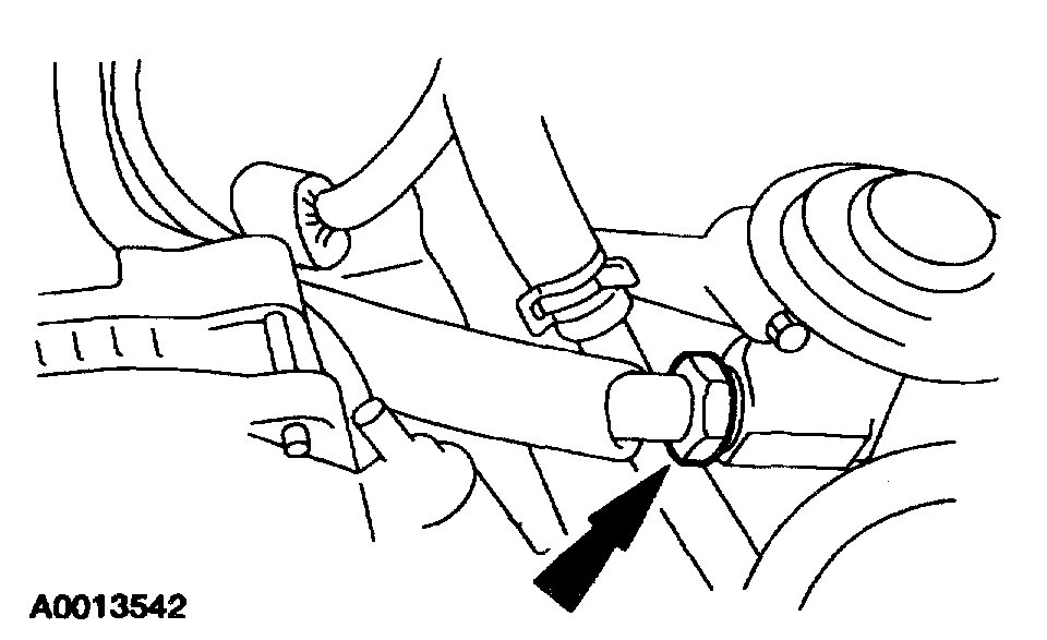

3. Remove the Exhaust Gas Recirculation (EGR) valve vacuum hose.
pic 3

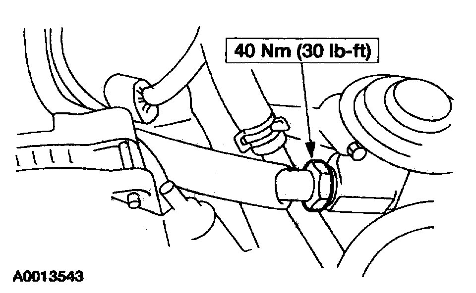

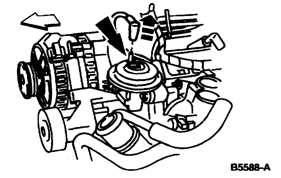

4. Remove the EGR valve tube upper fitting.
pic 4

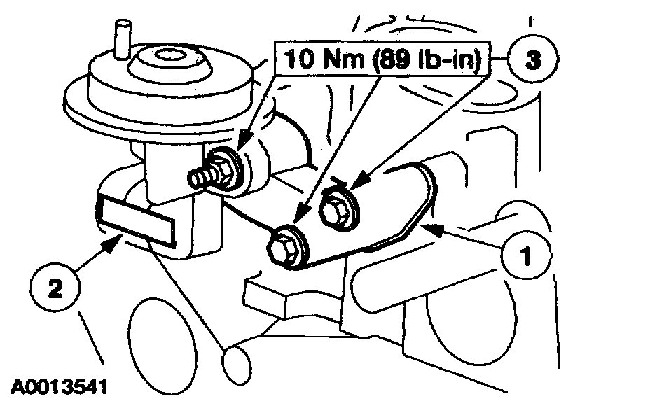

5. Remove the EGR valve and the adapter.
1 Remove the nut and the bolts.
2 Remove the EGR valve and the adapter assembly.
pic 5

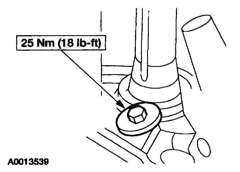

6. Remove the camshaft synchronizer bolt.
pic 6

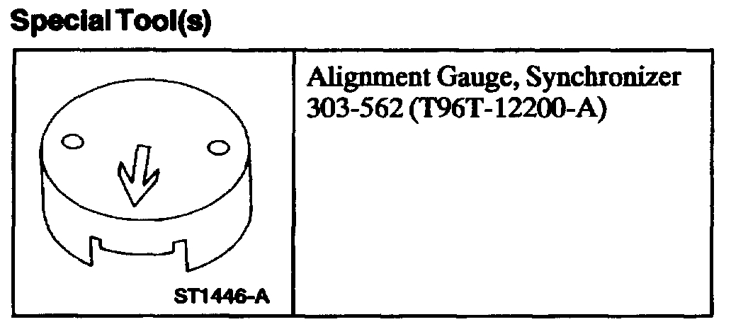

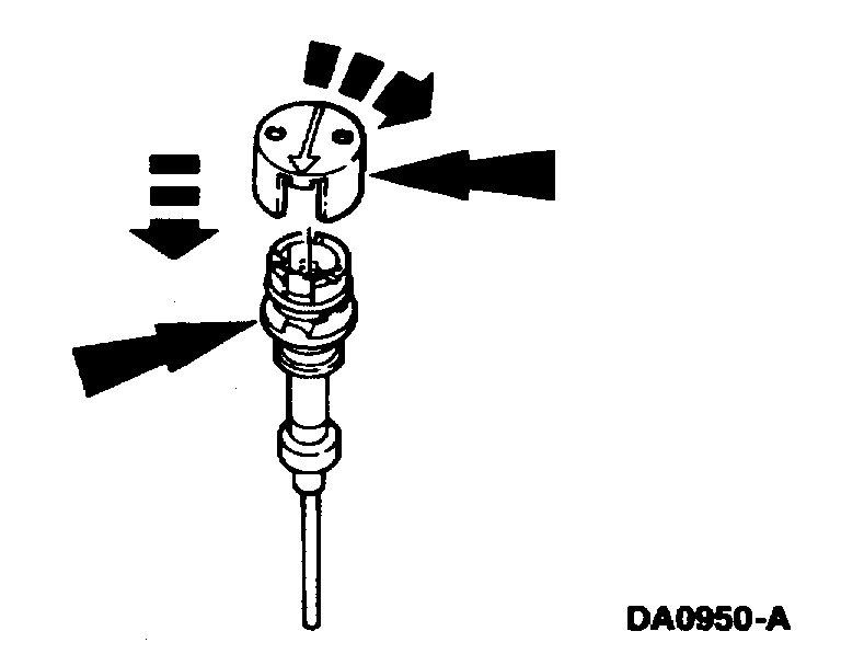

1. Install the Synchro Positioning Tool on the camshaft synchronizer by rotating the tool until it engages the notch in the camshaft synchronizer housing.
CAUTION: A Synchro Positioning Tool must be used during the installation of the replacement synchronizer assembly. Failure to follow this procedure will result in the fuel system being out of time with the engine, possibly causing engine damage.

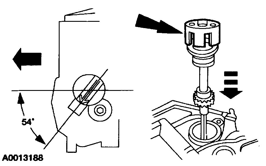

2. Install the camshaft synchronizer housing assembly so the arrow on the Synchro Positioning Tool is 54 degrees from the centerline of the engine.
NOTE: During installation, the arrow on the synchronizer alignment tool will rotate clockwise as the gears engage.

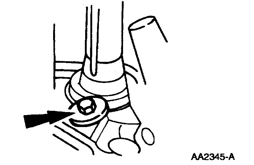

3. Install the camshaft synchronizer bolt.

5. Install the EGR valve tube upper fitting.
pic 12
6. Install the EGR valve vacuum hose.
