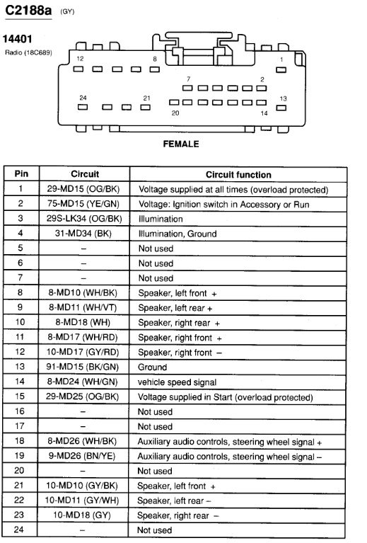

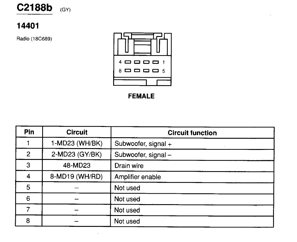

I just got the car listed above SES. I am wondering if i need anything special to wire up an aftermarket deck other than the actual harness. Is there an anti theft device if i pull out the stock radio? or am i good to go?

Awesome, i have already ordered all of it and have it all wired up ready to go was just making sure i didn't need anything else before i install it into the car. Thank you
