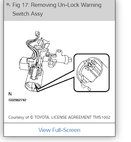

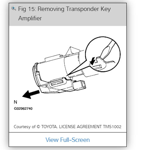

My car key will not turn inside the key slot. When I insert the key, the immobilizer recognizes the key, but the ignition lock cylinder has some glitches to it that makes my key not turntable. So, I am planning to replace the ignition lock cylinder. The new ignition lock cylinder comes with two keys. If after replacing the cylinder, I can mechanically turn with the new keys, but I won’t be able to start the car because the immobilizer doesn’t recognize the new key. In that case, do I need to program my new key to match with the immobilizer? Or I can avoid this hassle by just carrying my old key around because it has the microchip that communicates with the immobilizer.
Jul 3, 2023 at 5:18 PM
  • 54,832 POSTS

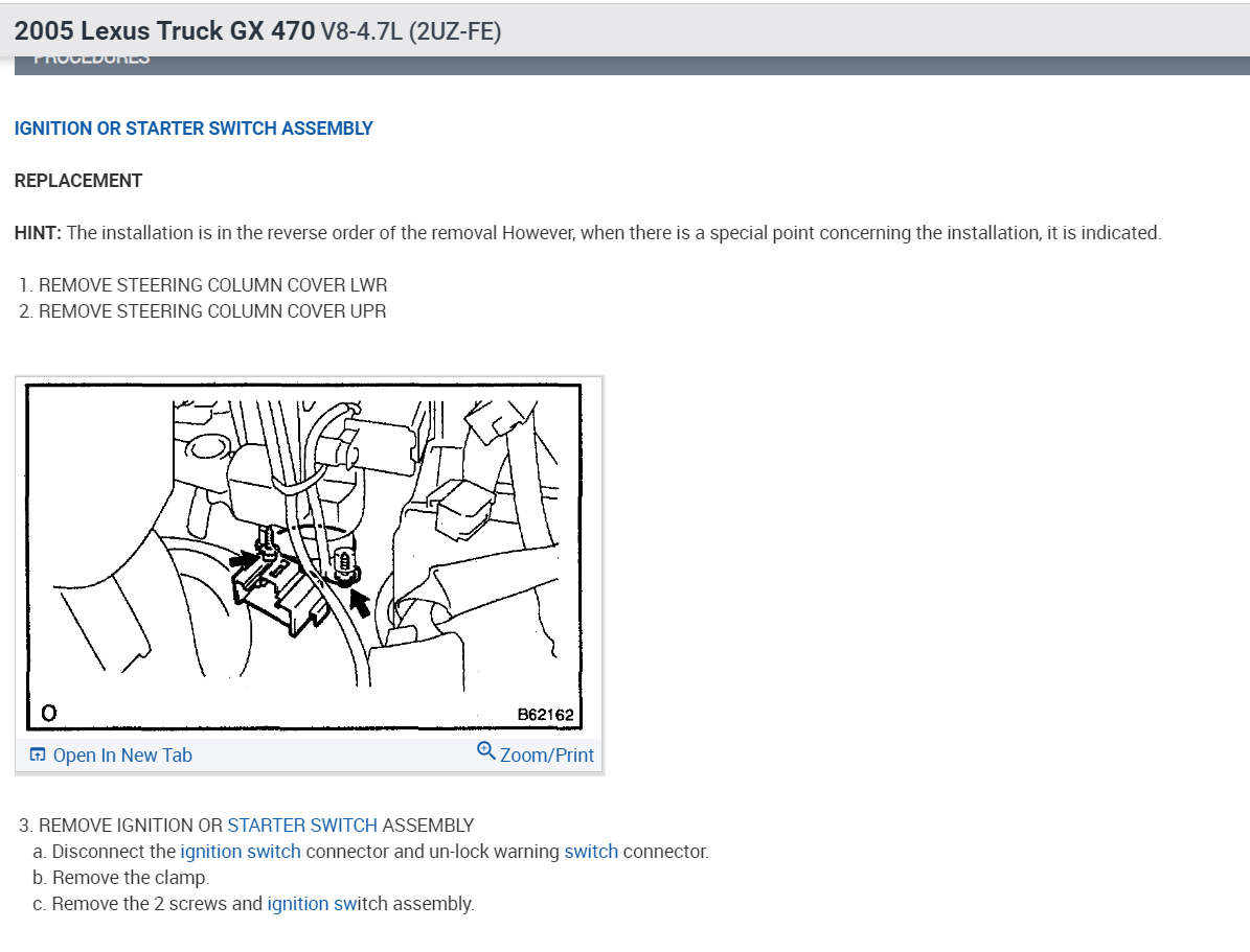

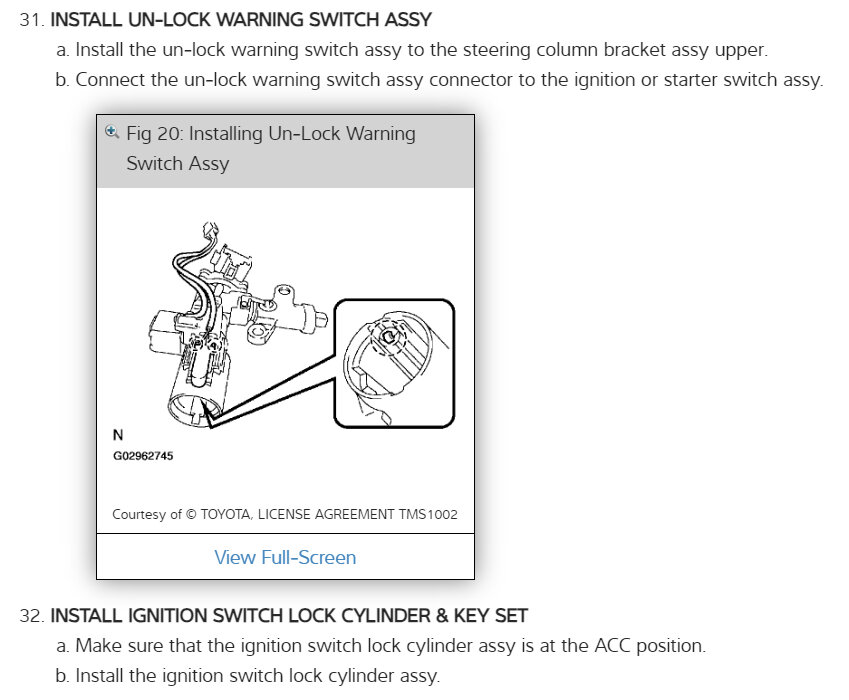

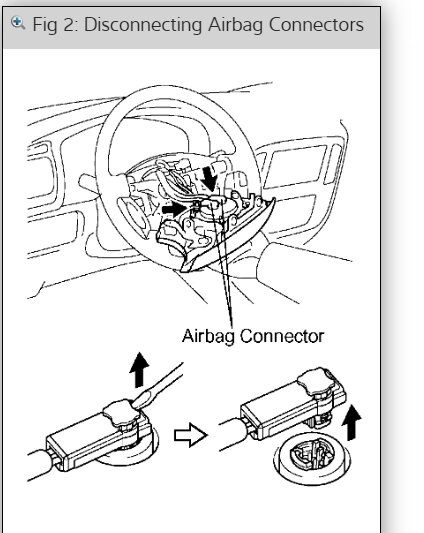

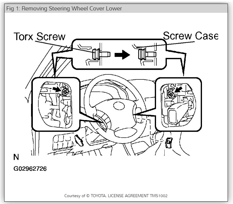

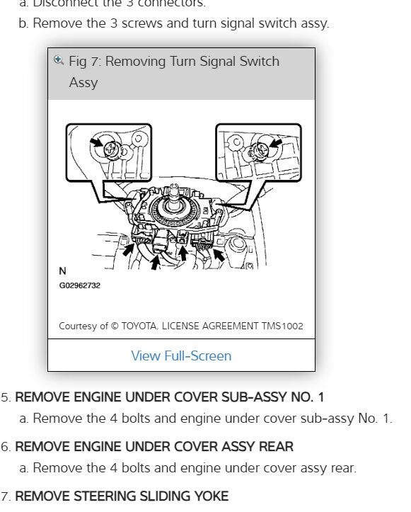

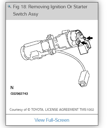

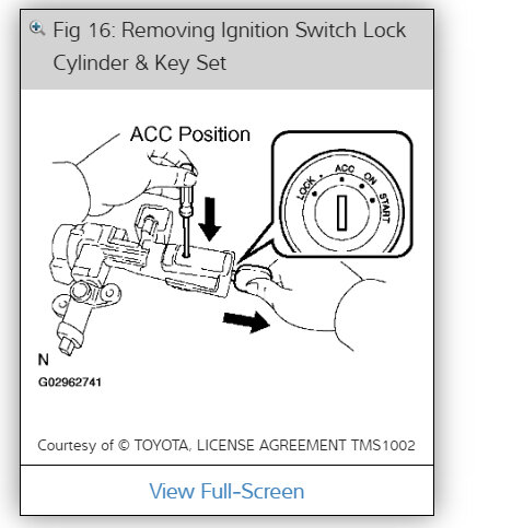

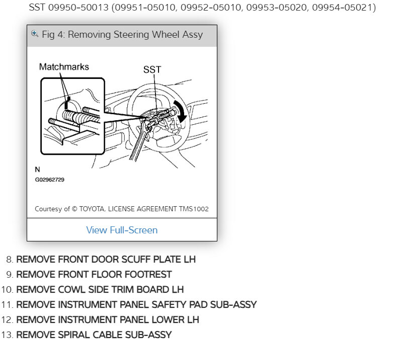

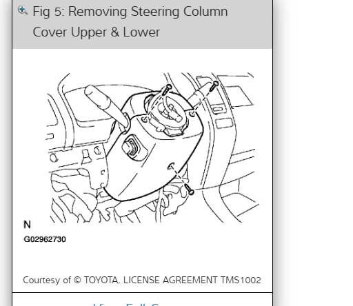

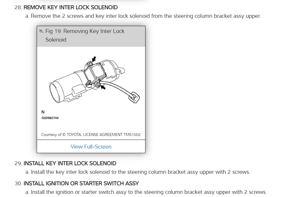

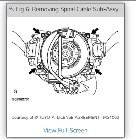

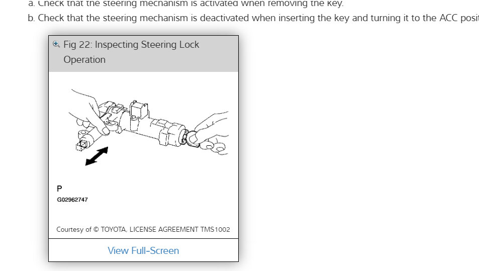

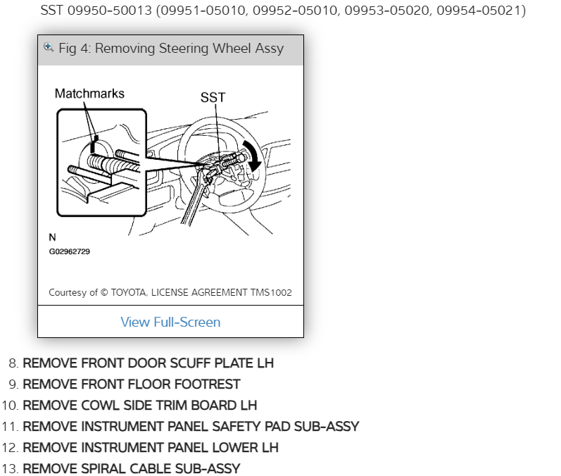

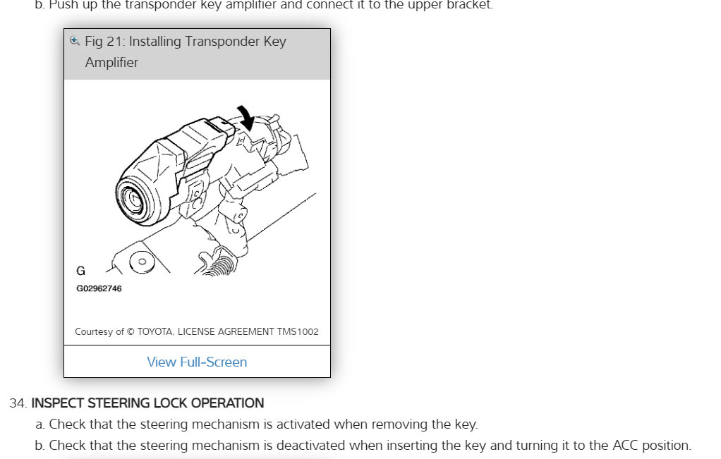

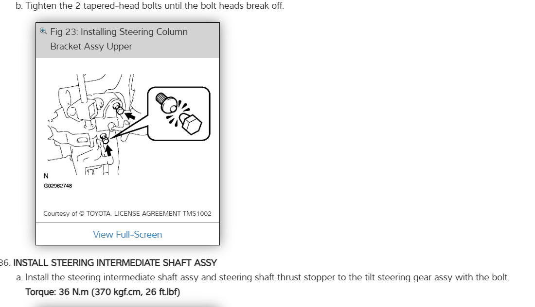

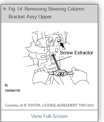

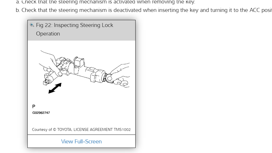

I would try some wd40 in the keyhole first. Also, if the key is recognized by the immobilizer, then just have the key with you. This guide may help you and I have included the ignition lock replacement instructions as well.
https://www.2carpros.com/articles/ignition-switch-wont-turn-stuck
Check out the images (below). Please let us know how it goes
