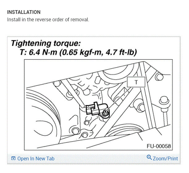

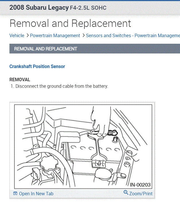

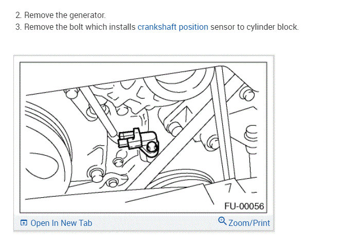

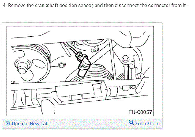

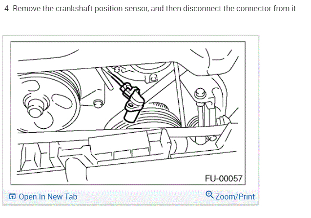

Has anyone checked the crankshaft position sensor? When they begin to fail, oftentimes, they will fail when they get hot. Once they cool, they work again for a bit of time, and then the same thing happens.
Take a look through this link and let me know if you feel it mirrors what you experience:
If it does, you can check if the RPM signal is lost during cranking when it won't start. Or you can check to see if the spark plugs lose spark. Here is a link that explains how that is done:
https://www.2carpros.com/articles/how-to-check-for-ignition-spark

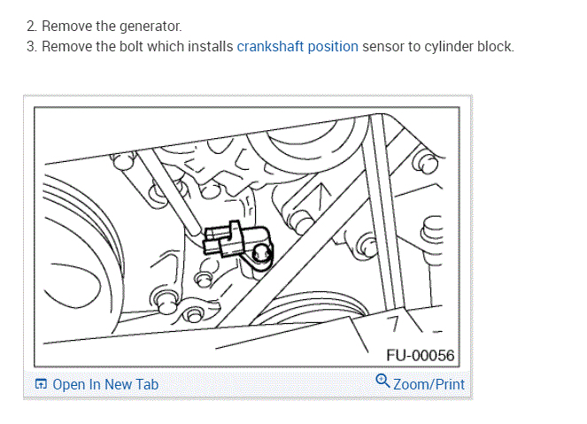

If you find that there is no spark or no RPM signal, here is a link that explains in general how to replace the sensor:
I attached the directions below specific to your vehicle.

No, but this makes perfect sense. The crank sensor, I thought about this, I'll check.

I got the sensor and after 1/2 hour it starts stumbling until it stalls. David

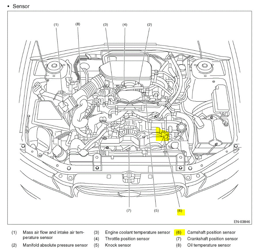

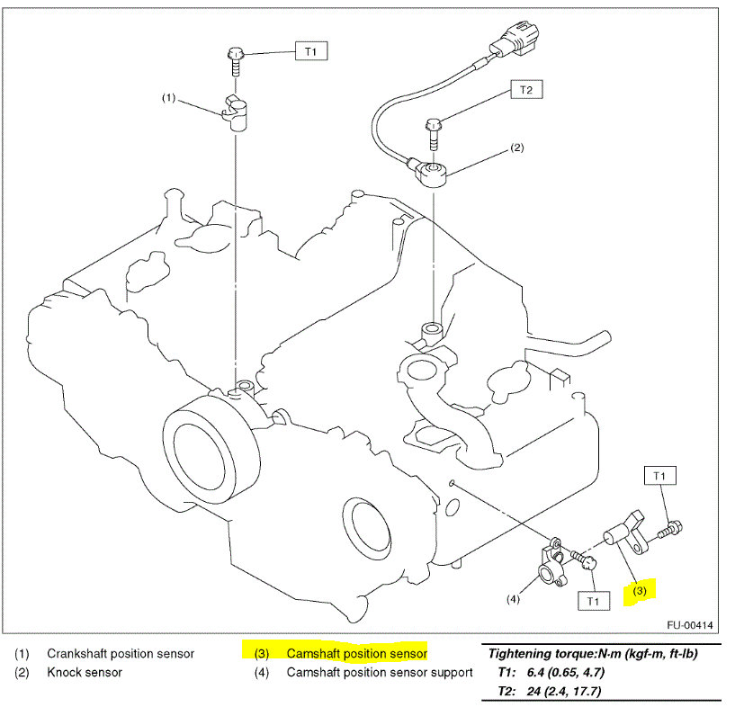

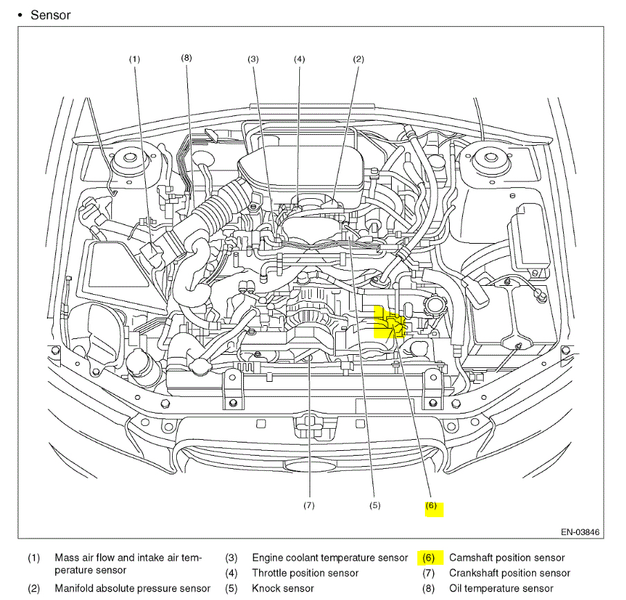

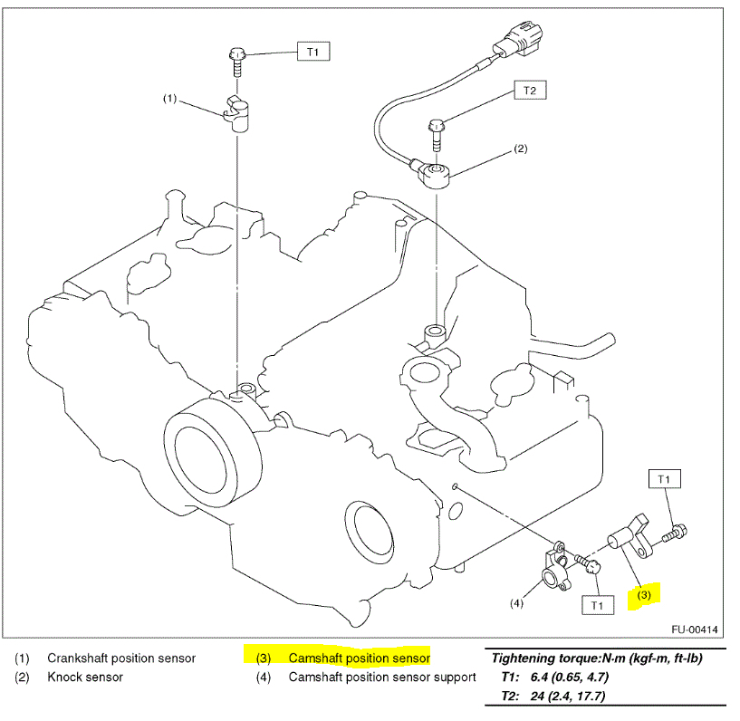

We replaced the crank sensor. I think this thing has Cam sensors too. Just to throw this on the table?
May 19, 2022 at 6:53 PM
  • 110,240 POSTS
You are correct, it does have a cam sensor. See pics 1 and 2 below. So, if I understand, each time you got a code, it was repaired by replacing the component. Are there any codes at this point?

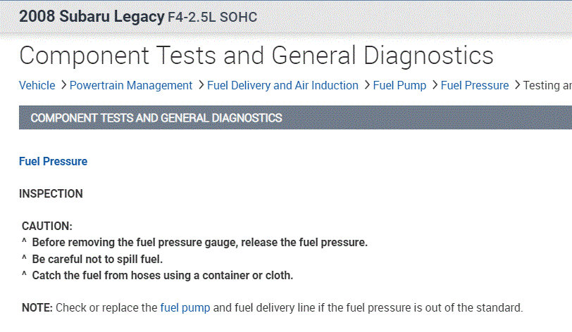

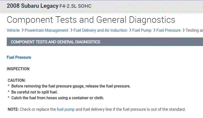

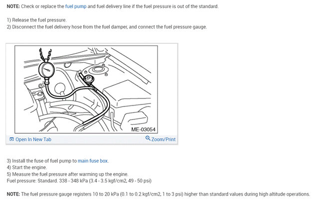

If you have a negative 51, the computer is trying to lean the fuel mixture. At this point, we need to check fuel pressure and how quickly the fuel pressure is dropping off.
Fuel pressure drop (in this case) could indicate leaking fuel injectors causing the engine to run rich. Here is a link that explains how it's done:
Most parts stores will lend you a fuel pressure gauge if you need one.
Also, I listed the directions specific to your vehicle which include fuel pressure specifications below.
Let me know what you find or if you have already done this.

I checked the fuel pressure. At start I have 50.7 to 51.4. Good. When warmed up and beginning to stall it is 50.8 to 51.3. I have a window in the fuel tester and was looking for bubbles. No bubbles. Thank you, David
Jun 14, 2022 at 3:45 AM
  • 110,240 POSTS
Hi David,
The fuel pressure is nearly perfect. Have any of the codes returned? Also, by chance do you have a voltmeter gauge in the vehicle or is it a light?
I think it's time to look at other possible issues. For example, low voltage. Let me know if you have a gauge or light in the vehicle.
