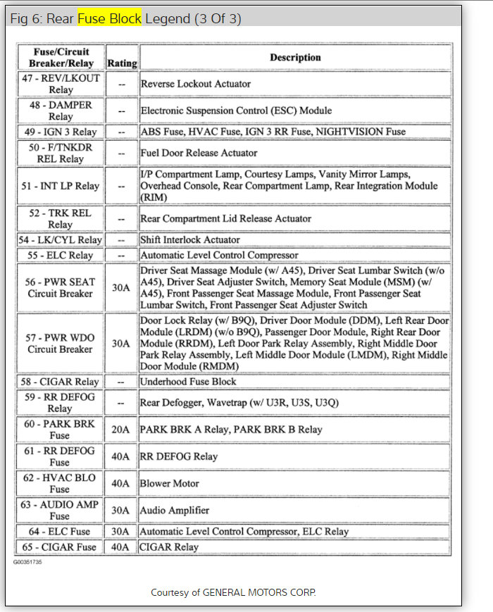

All hazards work the flasher was tries. the turn signals don't work or click at the same time. the speedometer got stuck on 0 even if I drive 40 mph.
Barry Garvin. I had a stroke in 2006 on social security now.
Mar 8, 2019 at 11:28 AM
  • 55,721 POSTS

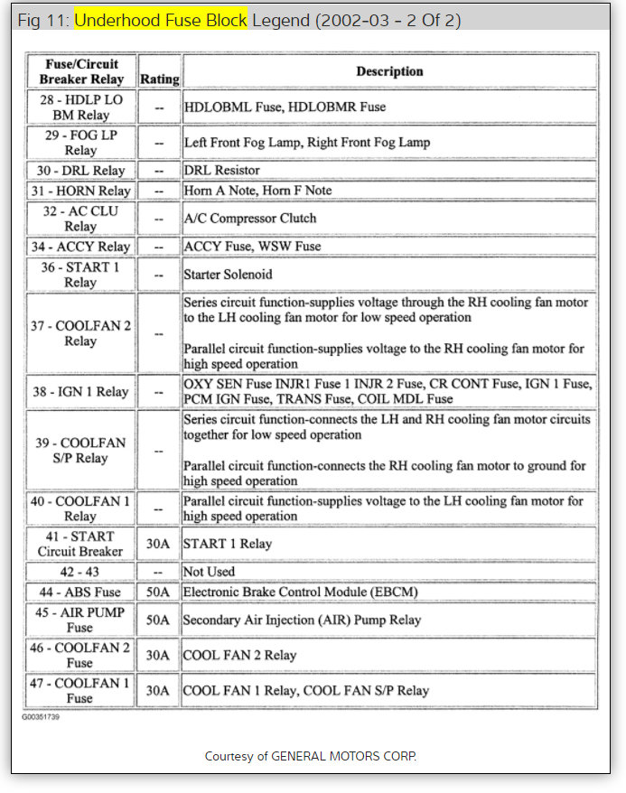

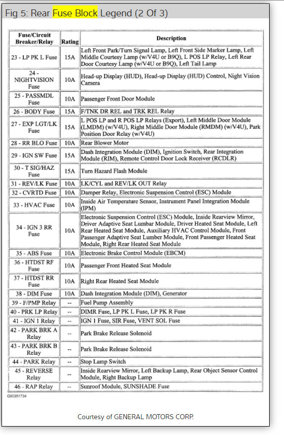

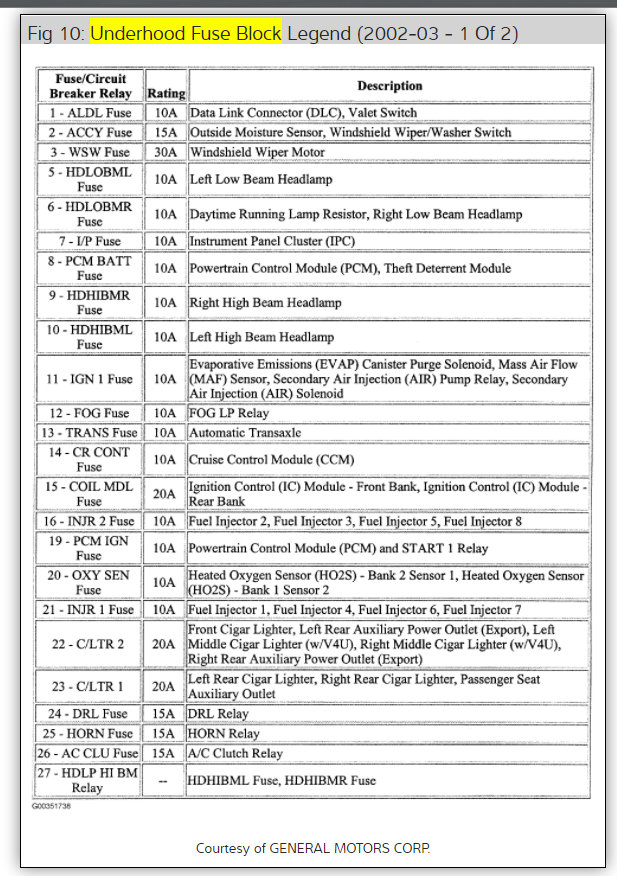

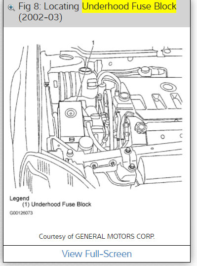

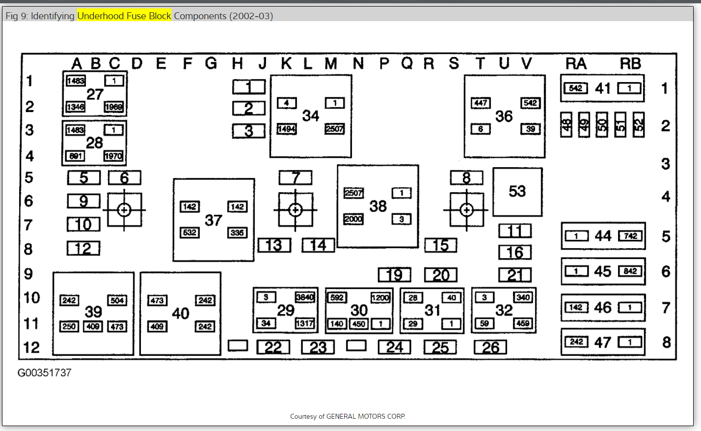

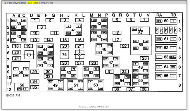

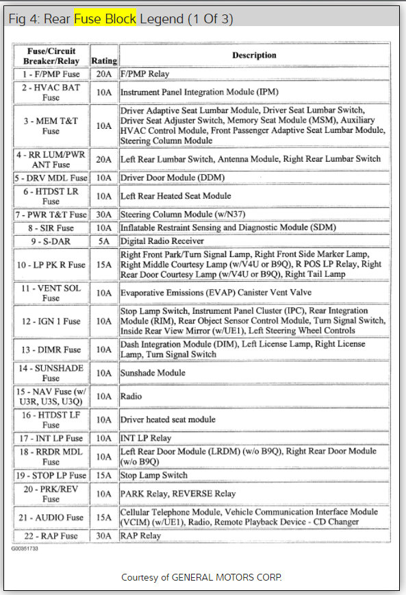

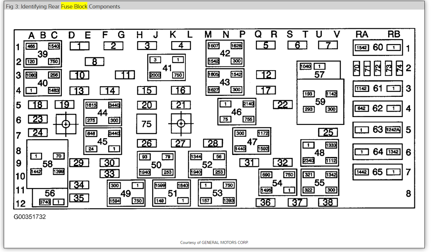

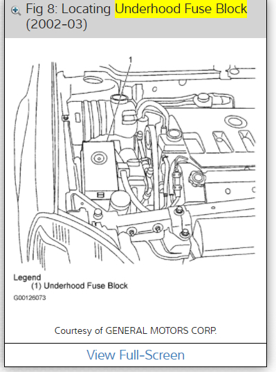

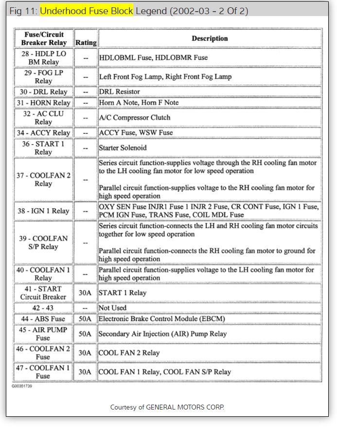

It sounds like the BCM has gone out but lets start by checking the fuses first. Here is a guide and the fuse locations to get us started:
