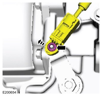

after 50 miles trasmition try to change by herself to reverse.
Oct 23, 2020 at 1:03 AM
  • 110,244 POSTS
The transmission gear selection is identified by a transmission range sensor. Did you see a change in gear select or did it actually go to reverse?
Pay attention to the gear indicator to see if it is accurate. Also, take a look at the shift linkage under the hood to make sure nothing is loose or disconnected. Note there are
two different transmissions for this vehicle. Let me know if this has a 6 speed automatic.

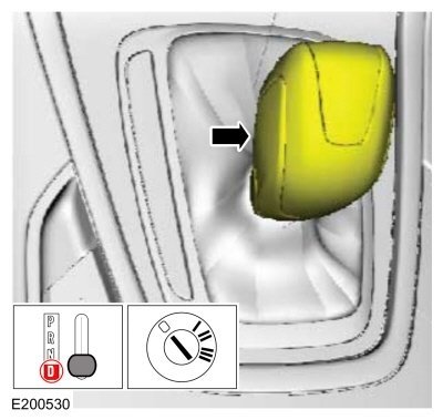

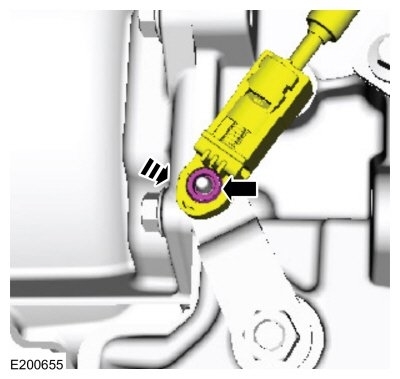

1. Position the selector lever in D (Drive). Turn the ignition off.
pic 1

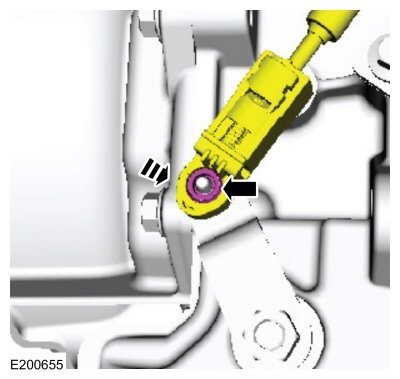

3. Disconnect the selector lever cable from the manual lever.
pic 2

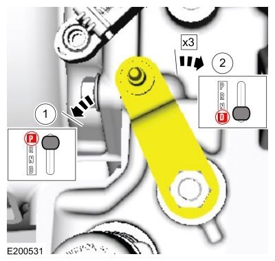

4. Position the manual lever in D (Drive).
1. Rotate the manual lever counterclockwise until it stops.
2. Rotate the manual lever 3 detents into D (Drive).

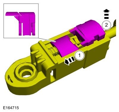

5. Unlock the adjuster.
1. Slide the spring-loaded tab forward.
2. Lift up the adjuster lock.

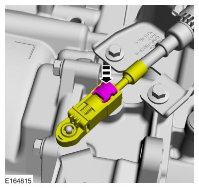

6. Connect the selector lever cable to the manual lever.
pic 5
