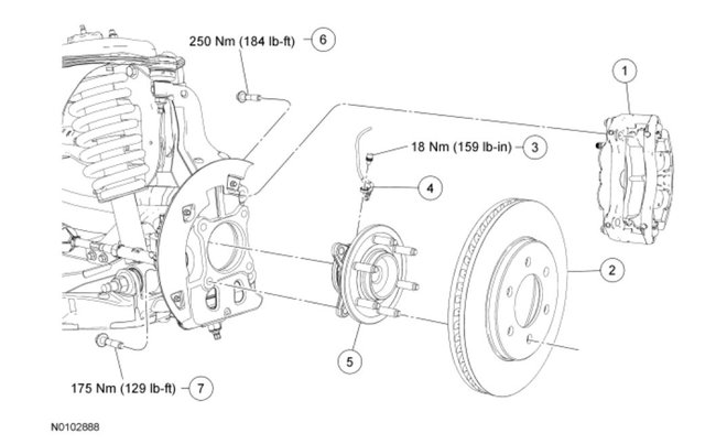

My AdvanceTrac light is came on on my dashboard stating it needs servicing and it acts as though my power steering is out. It is very difficult to steer. Can you tell me what could be causing this?
Nov 15, 2018 at 8:24 AM
  • 55,423 POSTS

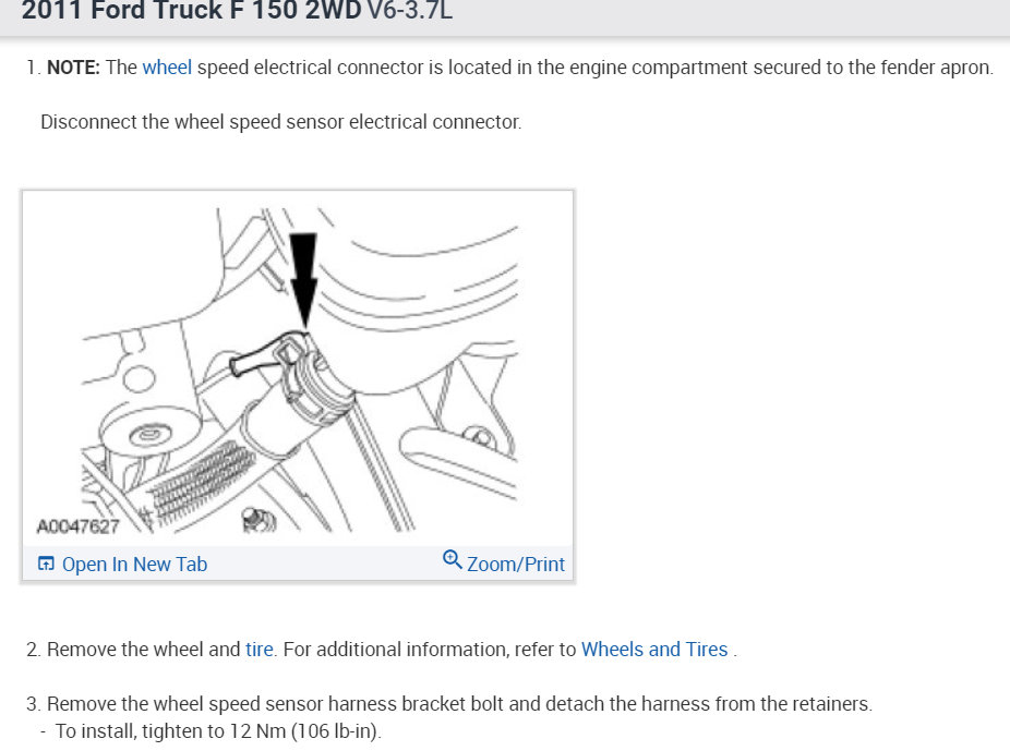

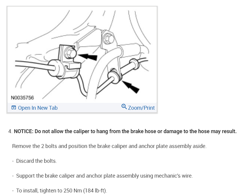

It sounds like you have an ABS wheel speed sensor going out which will cause the issue you are having. Here is a video to help you run the codes so you can see which sensor it is. Probably the front wheel bearing hub.
https://youtu.be/rTtAnsOlZU4
This video shows the job being done on a similar truck.
https://youtu.be/ZgiPRG6jffc
