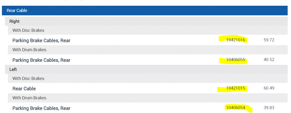

Spring wouldn’t disengage or loosen, just kept getting tight. Even soaked it but it was so rusty when I get it to loosen it kinda stripped on me. So it looks like I am going to have to get a replacement Parking brake cable. Do you know which part numbers are for both passenger side and drivers side? Passenger side wraps around near fuel tank to the drivers side where there is a spring meeting the drivers side cable.
Mar 9, 2020 at 1:29 PM
  • 110,194 POSTS
That happens more than you know. I attached a picture below. It shows the original equipment part numbers. You may want to consider getting them from a parts store. They will be much less money.
Let me know of this helps.
