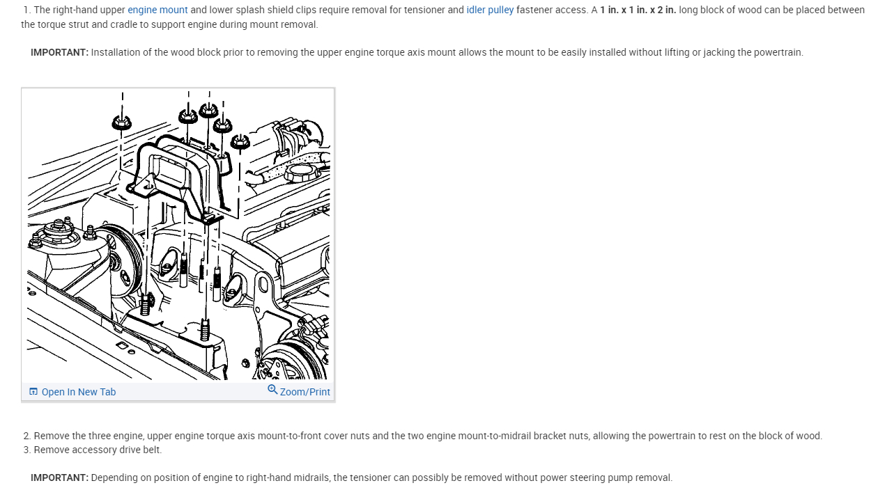

I need access to the belt tension adjusting part.
Dec 19, 2021 at 6:02 AM

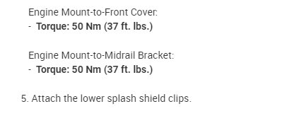

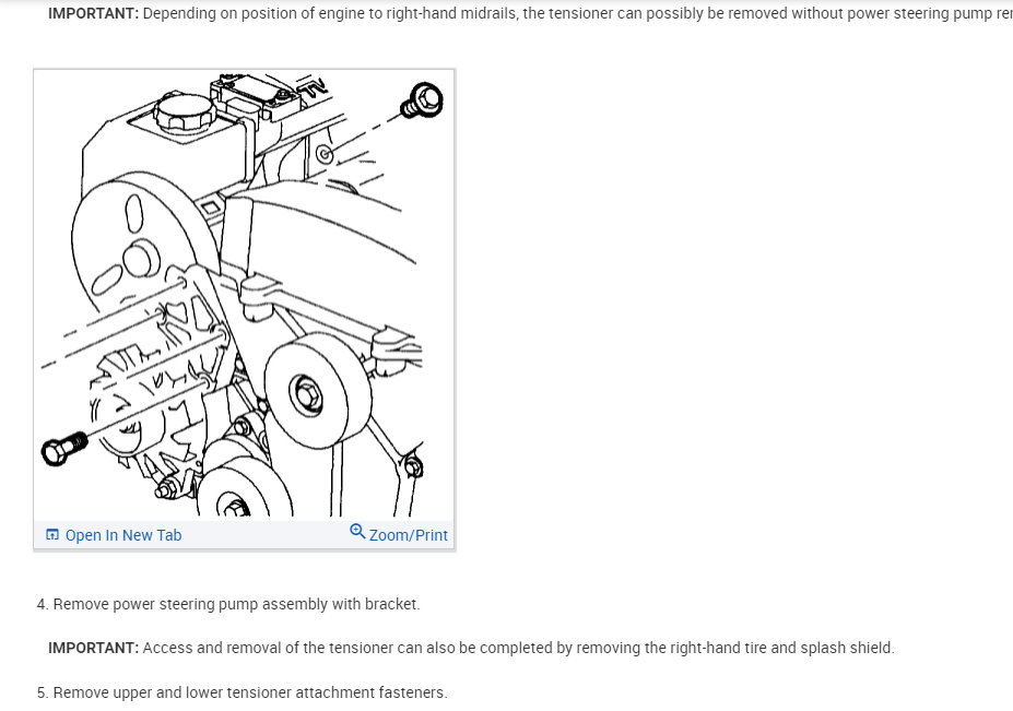

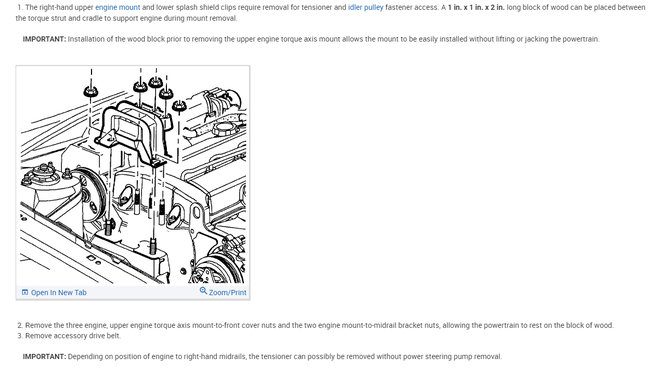

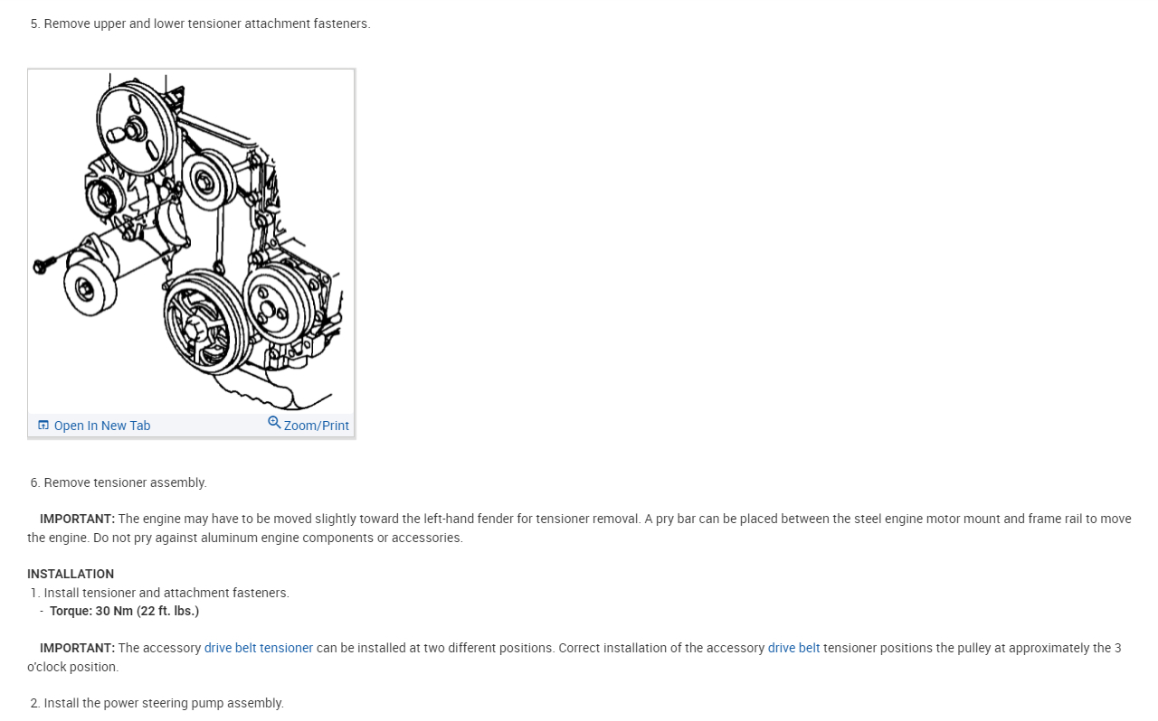

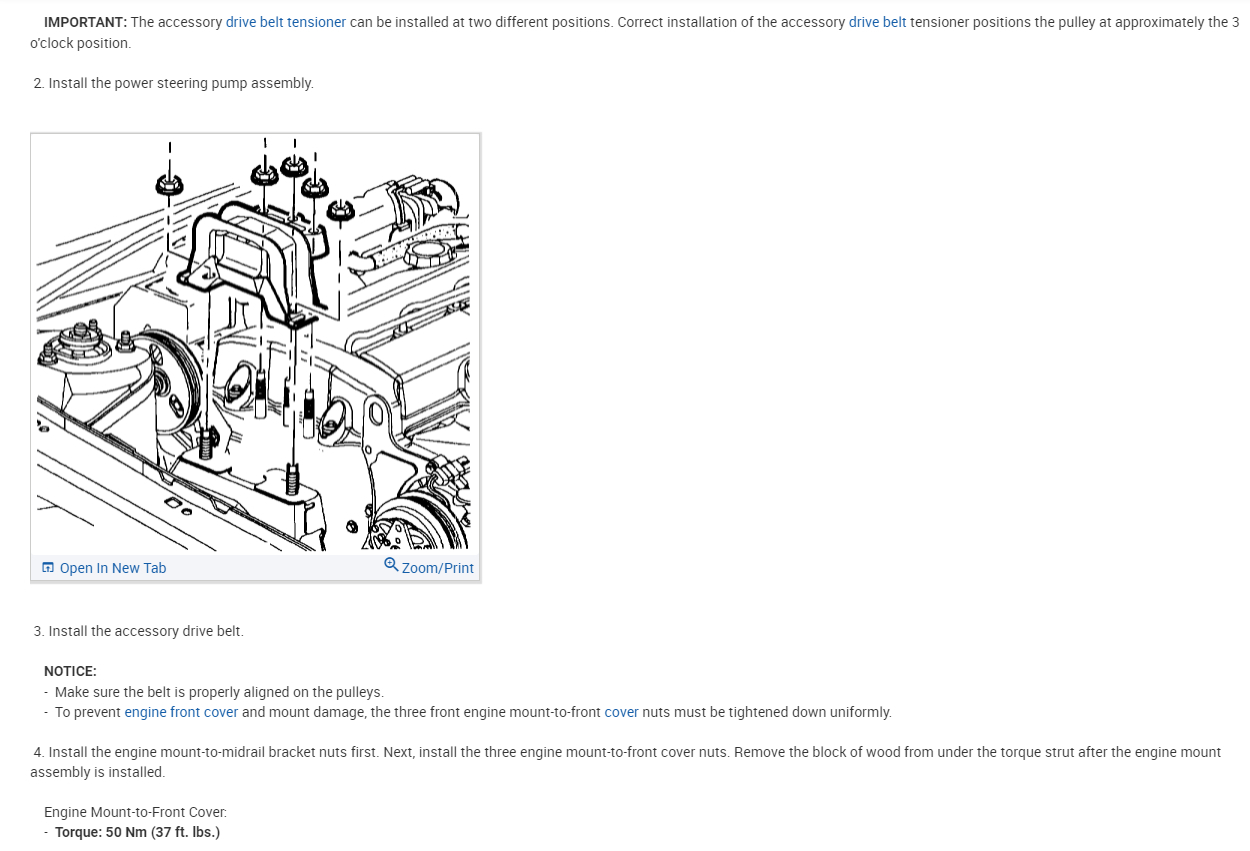

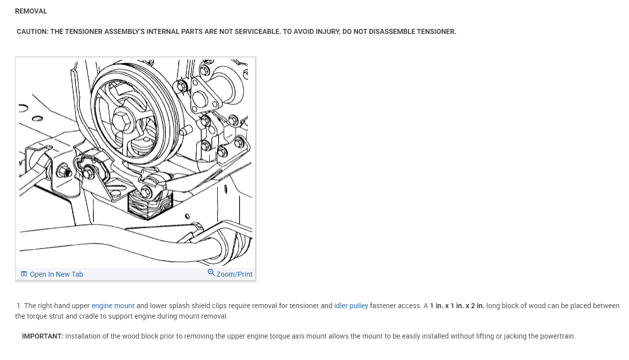

Good afternoon,
I attached the procedure for removing the tensioner and installing it for you below so you can gain access to the struts.
https://www.2carpros.com/articles/how-a-serpentine-belt-tensioner-works
Let me know if you have any other questions.
Dec 19, 2021 at 6:42 AM

I can't read the type.
Dec 19, 2021 at 7:17 AM
I don't understand. Please explain.
Dec 19, 2021 at 7:19 AM
TB.CARES
  • 5 POSTS
Never mind. I was able to enlarge it to read text.

Well, I think lifting the engine was quite a bit more work than I intended to try to do. I sprayed some belt rejuvenator or conditioner or whatever that stuff is called on the belt and I'm hoping that'll hold for a while. Thanks for your help.
Dec 19, 2021 at 9:13 AM
That is very temporary. It will wear off very quickly.
