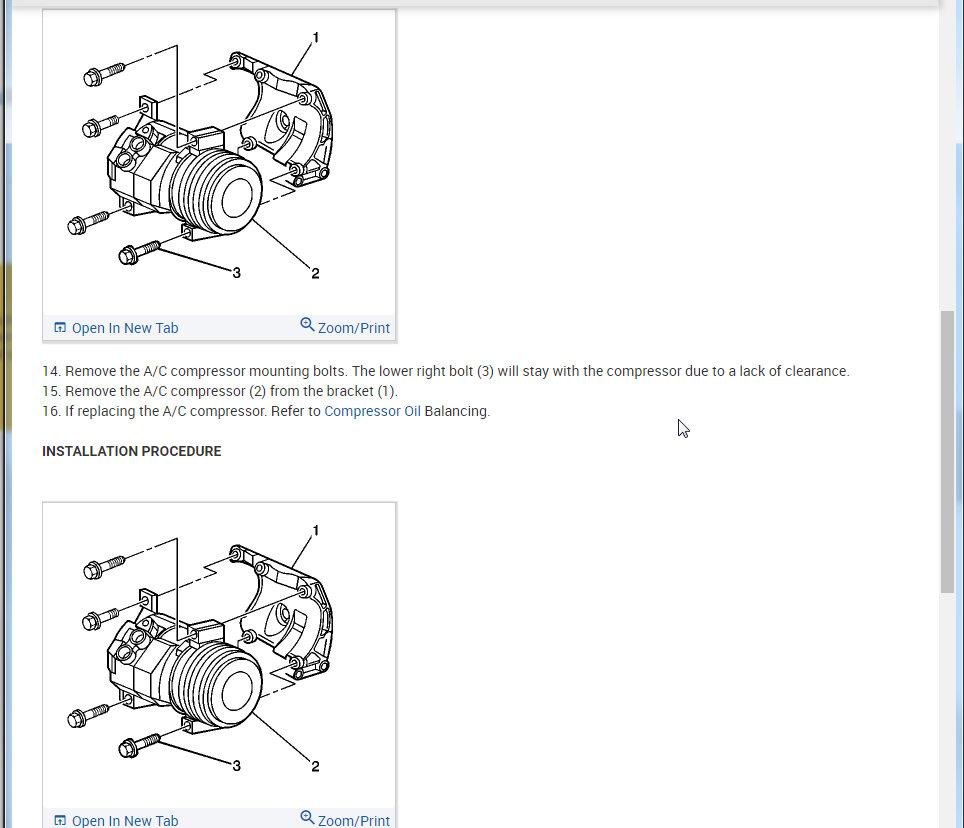

My A/C compressor is making a scratching noise like it doesn't have enough oil in it. First is there a oil that can be added to the system? If so what type of oil would I use and can I add it without discharging the A/C? Or does this just mean the compressor is bad?
Jun 7, 2021 at 10:15 AM

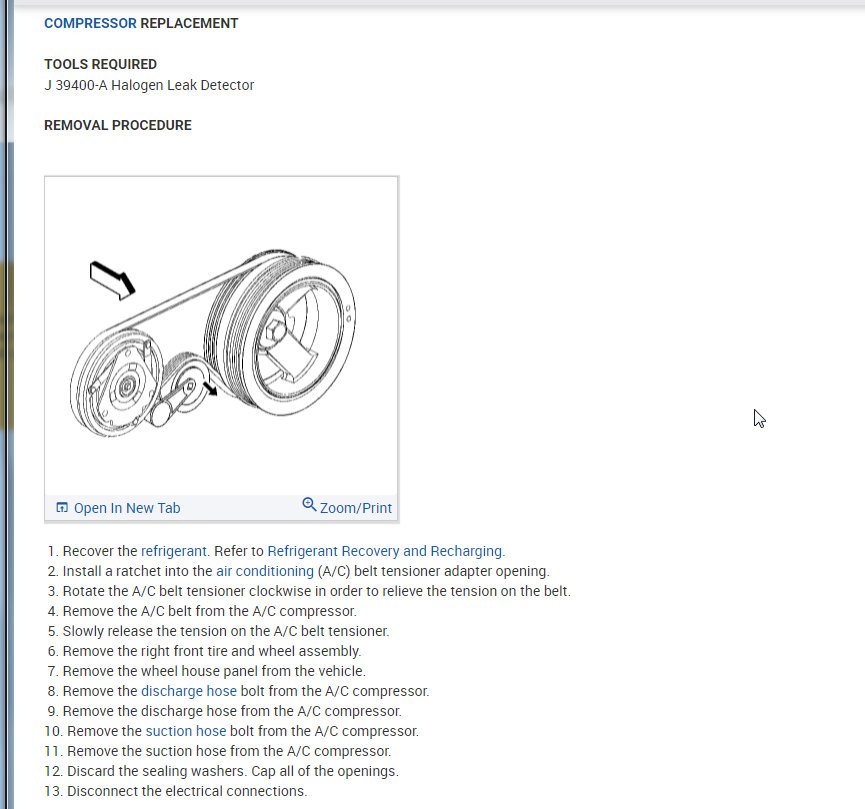

There is oil that goes into the system but this is a sealed system so you cannot add it without pulling the system down and recovering the freon and the oil then adding it back in once the system is repaired.
Here is a couple guides that will help with this:
https://www.2carpros.com/articles/replace-air-conditioner-compressor

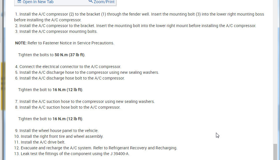

The fact that the compressor is making noise more then likely just the bearing starting to fail. Unfortunately the compressor more then likely needs to be replaced. I attached the info from the manual on how to replace the compressor as I suspect this is what is going to need to be done.
However, if it is working then I would just leave it until you are ready to replace it.
Please let us know if you have questions on this.
