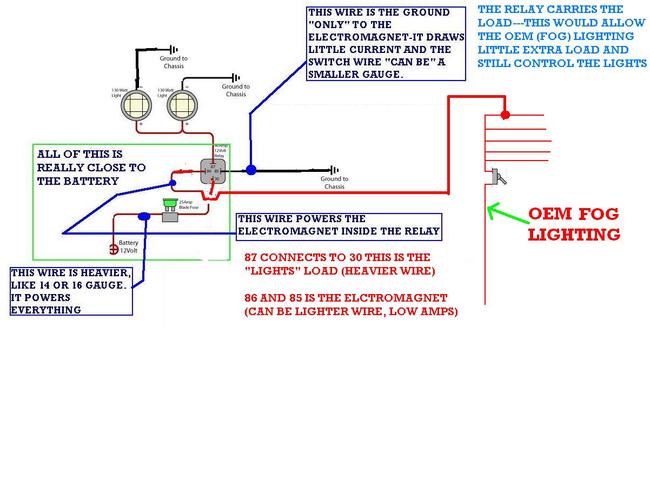

THERE ARE OTHER VARIATIONS THAT CAN BE DONE (AS IN MY HOMEMADE PICS BELOW)
THE TRICK IS ARE WE GONNA "SWITCH-LEG" THE GROUND (85) OR ARE WE GONNA "SWITCH-LEG" THE HOT WIRE (86) THAT OPERATE THE ELECTROMAGNET

YOU WILL MOST LIKELY GO WITH SOMETHING LIKE MY 2nd DIAGRAM

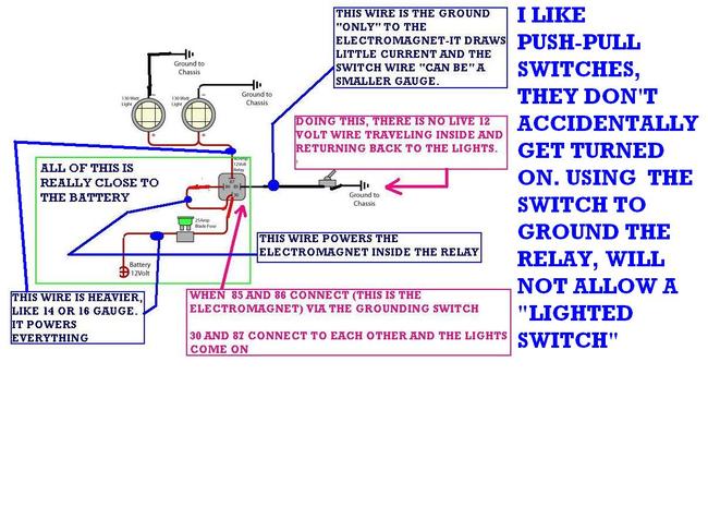

(I USE THE 1st DIAGRAM TO OPERATE A RELAY TO MY TRAIN HORN'S COMPRESSOR AND ANOTHER RELAY TO RUN MY HOMEMADE "EXTRA HEATER'S" BLOWER MOTOR BOTH USING 2 SEPARATE PUSH-PULL SWITCHES GOING TO GROUND)
ON THE 2nd DIAGRAM UP ABOVE
THE PART ON THE RIGHT THAT I LABELED "OEM FOG LIGHTING" (ALL SMALLER RED LINES AND A SWITCH) IS SUPPOSED TO REPRESENT THE FOG LIGHTING CIRCUIT YOU ALREADY HAVE
THE HEAVY RED LINE (FROM THE AFTERMARKET RELAY) TIES INTO A WIRE THAT IS ALREADY OPERATING "A" FOG LIGHT (MOST LIKELY EZily FOUND NEAR THE FOG LIGHT)
THUS WHEN THE FOG LIGHTS TURN ON
THE RELAY ALSO TURNS ON
POWER IS ROUTED TO THE "NEW LIGHTS" DIRECTLY FROM THE BATTERY
VIA HEAVIER WIRING
PROTECTED WITH AN INLINE FUSE (HOMEMADE OR BOUGHT FUSE HOLDER)
THRU THE RELAY'S 2 LOAD TERMINALS (FOR LACK OF BETTER WORDING)
AND ON TO THE NEW LIGHTS
VIA HEAVIER WIRING
THE FUSE BETWEEN THE BATTERY AND THE RELAY IS MOST IMPORTANT,
I WOULD LOCATE IT RIGHT AT THE BATTERY POSITIVE POST AS TO PROTECT THE BIGGEST MAJORITY OF THE WIRE (LIKE ONLY 2 INCHES OF WIRE FROM THE BATTERY TO THE FUSE WOULD BE UNPROTECTED)
READ THE INSTRUCTIONS TO YOU LIGHTS WELL!
IF NUTHIN' ELSE SCAN 'EM AND POST 'EM HERE, SO WE CAN SEE WHAT THEY MEAN
THEIR INSTRUCTIONS SHOULD BE ADHERED TO, IF THEY DIFFER FROM MY SUGGESTIONS

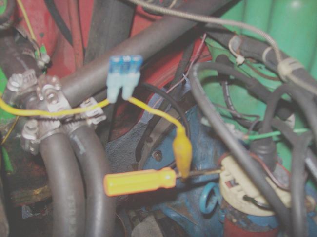

BELOW IS A PIC OF A HOMEMADE FUSE HOLDER, 2 FEMALE INSULATED STAKE ONS AND A FUSE. "THEY" MAKE FANCIER RUBBERISED HOLDERS WITH FLIP TOPS
I USE THIS SET UP TO TEST THINGS (IN THE CASE OF THIS PIC, BYPASSING THE IGN SWITCH, BY RUNNING POWER DIRECTLY TO THE COIL FROM THE BATTERY ON A JEEP CJ) I AM ONLY USING A 15 AMP FUSE IN THIS CASE

1) on your diagram for the oem fog light switch, i count 5 wires. Do 2 of the wires go to the low beam headlights? (When i turn on the highbeam headlights, the fog lights automatically shut off)
2) is one a ground?

THE "OEM" PART OF MY DIAGRAM WAS JUST "SLUNG OUT THERE" IT'S SWITCH WAS MEANT TO BE THE SWITCH FOR YOUR FOG LIGHTS, NUMBER OF WIRES WAS FICTITIOUS!
AFTER TALKING TO A FRIEND, HE SUGGESTS LEAVING THE VEHICLE'S LIGHTING OUT OF THE EQUATION
THIS PREVENTS POSSIBLY INTERCOURSING UP YOUR SYSTEM NOW
YOU CAN STILL RUN "FOG" WITHOUT KCs BEING ON

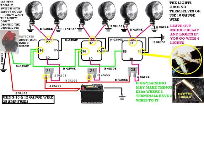

I'M DRAWING YOU A DIAGRAM NOW---FOR 6 LIGHTS (LEAVE OFF ONE RELAY AND 2 LIGHTS IF YOU ONLY WANT 4)
2- 100 WATT LIGHTS CAN RUN OFF OF ONE RELAY

Will i use a 20amp relay? The lights came with an inline fuse with a 15amp attached. Also, do i need a 4 pin relay?

WIRE OVERKILL IS A GOOD THING!
EVERYTHING FROM THE BATTERY IN A DIRECT LINE TO THE LIGHTS IS 10 GAUGE (HEAVY LOAD)
THE "SWITCHING" (ELECTROMAGNETS) IS ALL 16 GAUGE (LITTLE LOAD)
RADIO SHACK IS SO MUCH CHEAPER THAN AN AUTO STORE AND YOU HAVE MORE CHOICES
LIKE THIS RELAY (40 AMP) $6.44 SEE MY LINKS!
http://www.radioshack.com/12vdc-40a-spst-automotive-relay/2750001.html#q=automotive%2Brelay&start=2

I LIKE PUSH PULL SWITCHES AND TOGGLES W/ A SAFETY COVER (LIKE FOR ARMING STUFF IN A JET) IT'S HARD TO "ACCIDENTALLY" TURN ON THESE TYPE

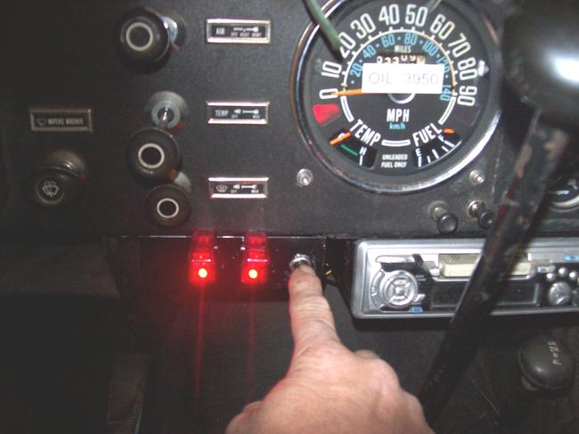

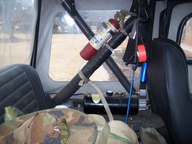

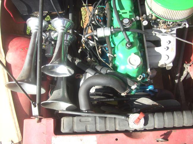

SEE PICS BELOW! 2nd BEING HOW I ELIMINATED THE KEY TO MY '77 JEEP, I RIGGED AN OLD (NOW MODIFIED) IGN SWITCH THAT PLUGS INTO MY ORIGINAL HARNESS, IT IS TOTALLY REVERSIBLE BACK TO ORIGINAL AS I CUT NO WIRES--SEE MY SWITCHES "ACC"/ "IGN"/ MOMENTARY TOGGLE FOR "START" I HAVE A HIDDEN MASTER SWITCH TO DISABLE THE WORKS

Ok. I think im on my way to getting my brain wrapped around this. Altho i do have 2 more questions.
1) In your drawing it shows 25amp fuse, but my lights came with a 15amp fuse. Was that just a random number you picked, or suggestin to bump it up?

I'VE LOOKED THRU A BUNCH OF "KC" AND OTHER DIAGRAMS (GOOGLE SEARCH/ IMAGES) WITH 100 WATT LIGHTS 25/ 30 SEEMED TO BE THE NORM
GO AHEAD AND USE YOUR 15 AMP FOR 2 LAMPS, AND ANOTHER ONE FOR THE OTHER 2
I FEEL SURE THAT IF IT CAME WITH THE SET, IT SHOULD WORK.
I'D SAY THAT ONLY SHORTING THE WIRE TO THE LAMP, TO GROUND, WILL BE THE ONLY THING THAT WILL BLOW THE FUSE
AS FAR AS THE 5 PIN, I'VE NEVER USED ONE FOR ANY OF MY HOMEMADE APPLICATIONS
I HAVE INSTALLED THEM IN CARS AS DIRECT REPLACEMENTS
NEVER HAVE TRACKED DOWN THE WHYs AND HOWs THAT I COULD USE ONE
AGAIN, GOOGLE SEARCH/ IMAGES FOR "KC DAYLIGHTERS" WILL BRING UP MANY DIAGRAMS KCs AND NOT, YOU WILL SEE THE 5 PINS IN SOME OF THOSE DIAGRAMS.
SOMETIMES THE 5th PIN IS USED, SOMETIMES IT'S NOT
I TRY TO STICK WITH WHAT I KNOW FOR CERTAIN, AND WILL PASS IT ON TO OTHERS
I WILL "EXPERIMENT" ON MY OWN STUFF WITH UNFAMILIAR CRAP- IF SOMETHING GOES WRONG, IT'S ON ME, HOPEFULLY IN A "CONTROLLED ENVIRONMENT"
YOU 'BOUT READY TO INSTALL?
UNDERSTAND THEM PIGGYBACKS?
UNDERSTAND HOW TO LOSE MY MIDDLE RELAY/ AND THE LIGHTS IT RAN, THEN HOOK THE DIAGRAM BACK TOGETHER?

WITH THE VERY 1ST DIAGRAM I SENT
"HOT" JUMPERED FROM ONE PIN TO THE OTHER
THE GROUND ON THE RELAY HAD A SWITCH IN IT, AND THE WIRE OUT OF THE SWITCH WAS SHORT AND GROUNDED TO THE CHASSIS
THE COOL THING HERE IS MY "SWITCH" CAN RUN A LONG WAYS ON JUST ONE WIRE. THERE IS NO NEED TO RETURN BACK OUT TO THE RELAY (OR LIGHTS/ LOAD) WITH ANOTHER WIRE
(AS IF YOU RAN 12V TO THE SWITCH (WHICH BREAKS THE 12V, AND NOW HAD TO SEND IT BACK OUT TO THE LIGHT)
IF MY GROUNDED WIRE W/ SWITCH (MY 1ST DIAGRAM AGAIN) EVER RUBBED A SHORT IN IT - IT WOULD SIMPLY TURN ON MY APPLIANCE, NO SPARKING, NO FIRE, NO BLOWN FUSE, IT WOULD SIMPLY TURN ON THE RELAY
IN FORD AND JEEPS CJ (AND OTHERS) IT WOULD BE STUPID TO RUN A MONSTER BATTERY CABLE TO THE IGN SWITCH AND BACK TO THE STARTER
THUS THE NEED FOR THE (HEAVY) STARTER RELAY, CONTROLLED BY THE IGN SWITCH VIA SMALL WIRE
