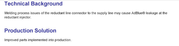

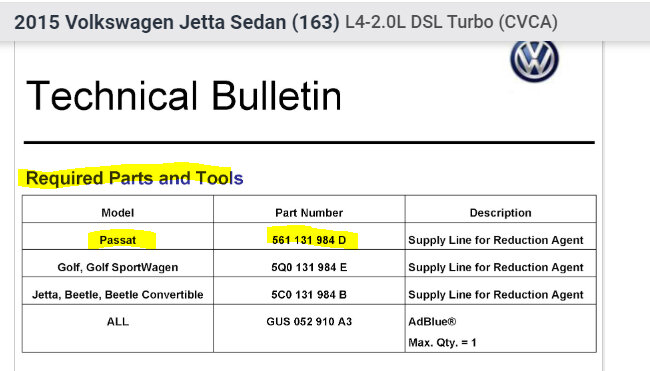

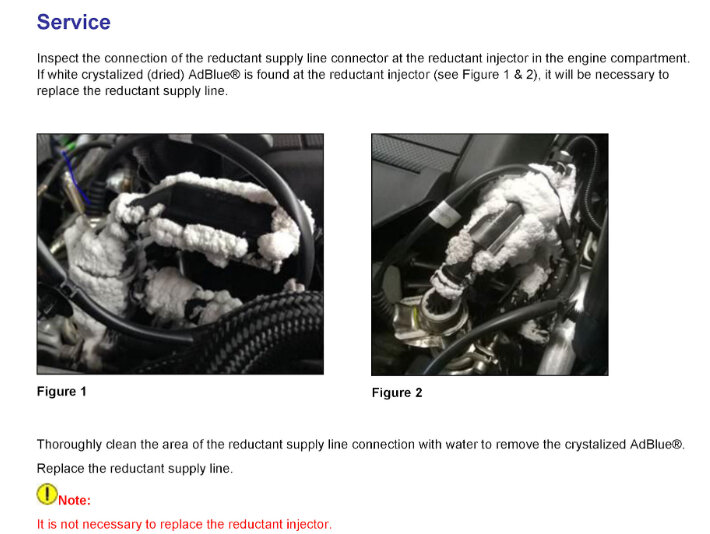

I know there is a technical service bulletin related to the light being on due to a reductant line connector issue. I read through it and there must have been some issue when the component was welded. If pressure is too low, it will prevent the operation of the system.
I attached it below so you can see it. Let me know if you can check it and determine if there is a problem.

So, I should just clean in the am and it should fix if that’s issue?

I cleaned out the Ablue crystal but still no start.

Is there a leak? That is what would cause the low-pressure issues and prevent it from starting. If there was evidence of a leak, it is likely still present.

Maybe I can’t tell but there was crystallized around the wires.

Something may be corroded. Check to make sure none of the connectors appear damaged, loose, or corroded. If everything appears okay, we need to scan the can-bus to determine what may be causing the issue. However, the idea that it was crystalized likely indicates a leak.
